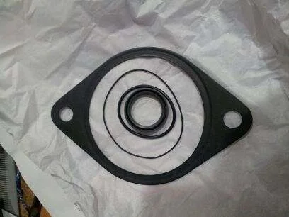

If the oil is coming from the steering/vacuum pump its a pretty easy fix. Cheap rebuild kit from Cummins and a few easy hours of labor which includes watching a few youtube videos.

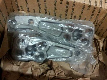

I just ordered the chromorly Hy-steer kit and Cummins seals for the leaky power steering. I won't be back for a few weeks, so won't be able to do anything until then.
Have you looked into going to the 1-ton TRE's with 0.25" wall tie-rods?
no, didn't do much research. I'll look at it and see if that's a better route

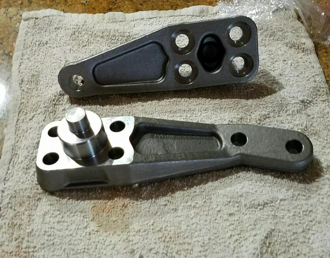

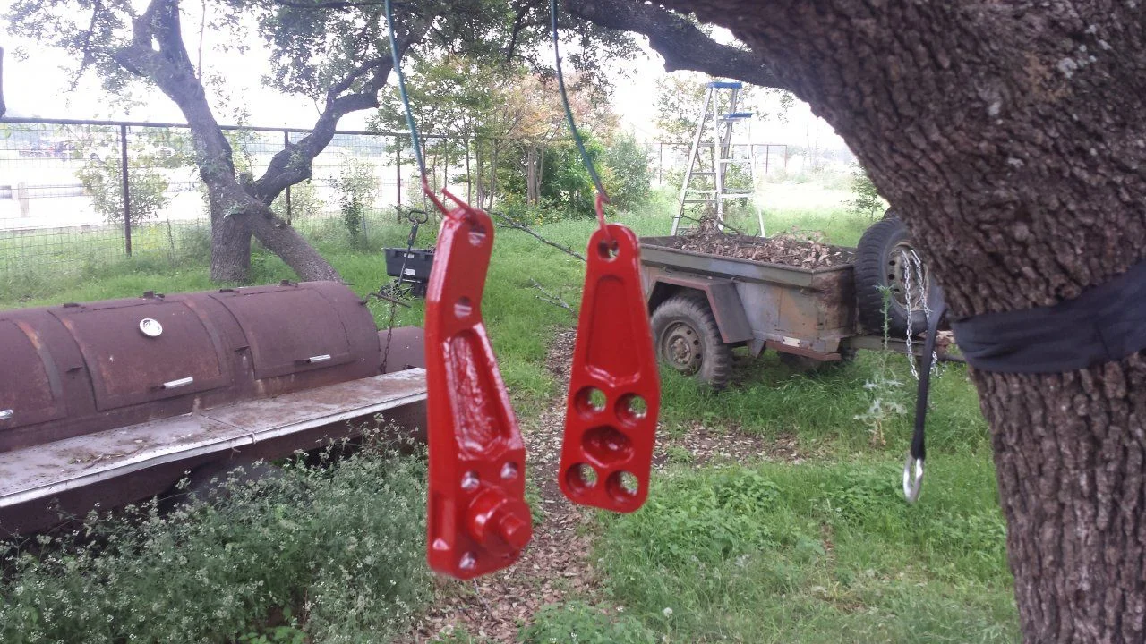

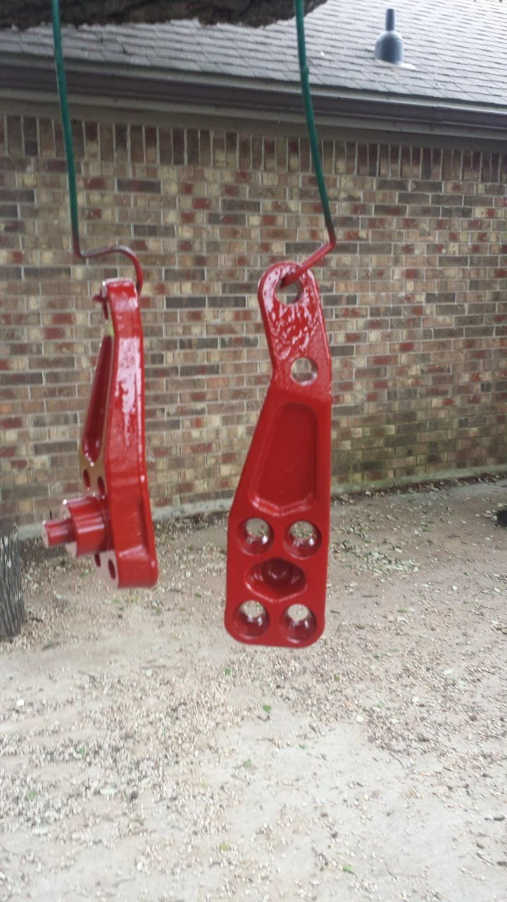

Just got back in from VA Beach. Had a productive three weeks, but it's time to be back home with my toys. Looks like the first order of business will be installing the hy-steer arms for Big Red and re-aligning the steering.

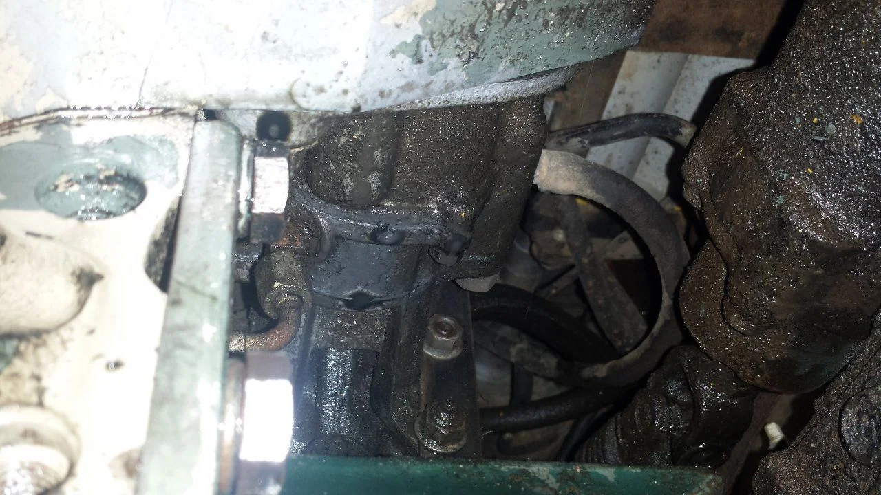

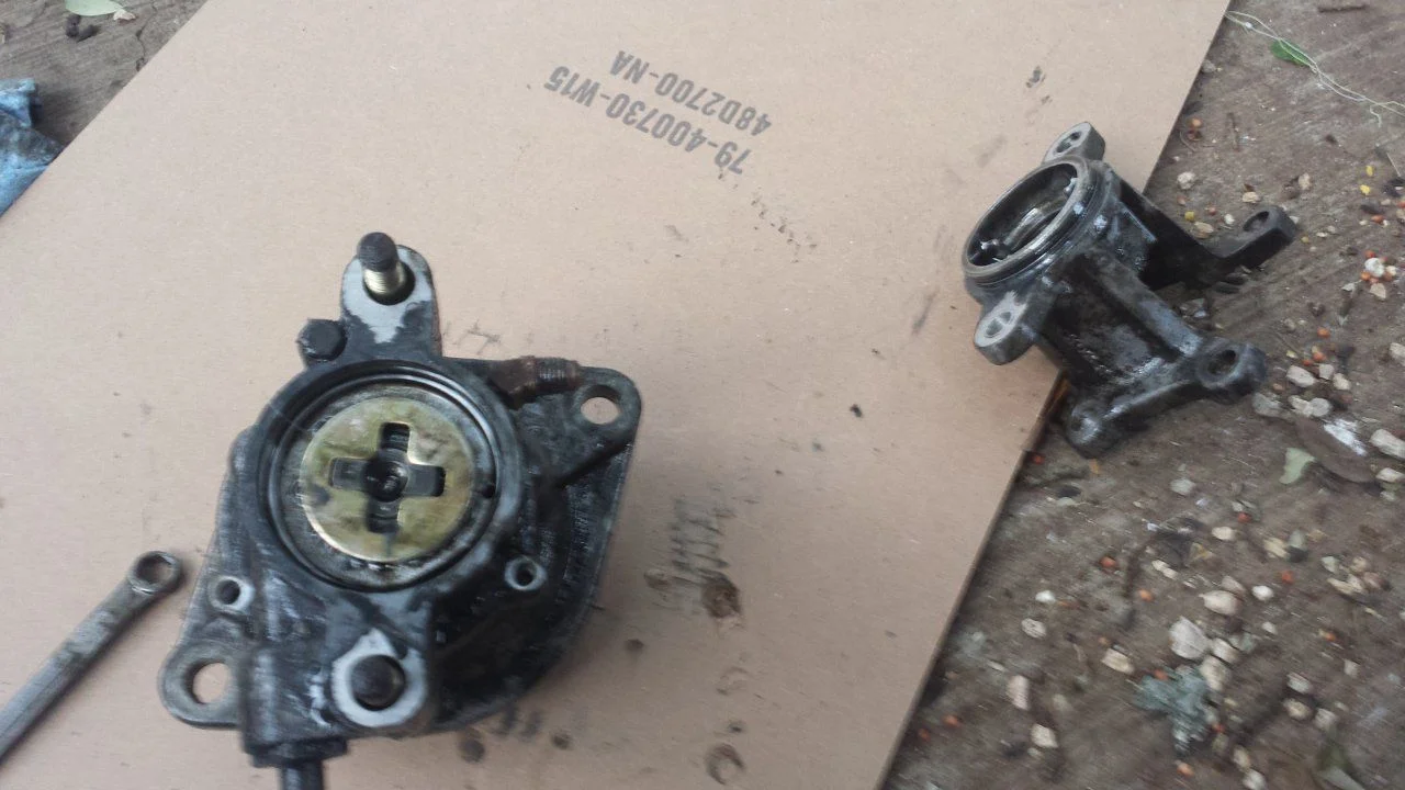

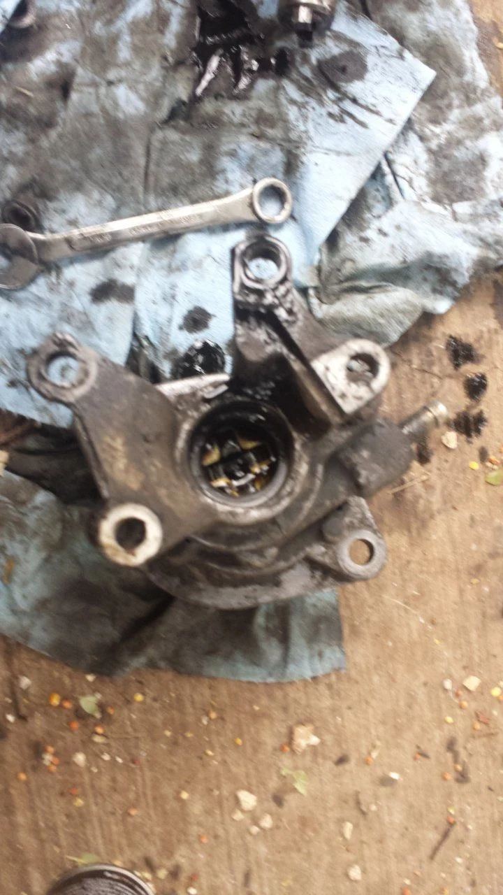

Second order of business will be tackling the sterring pump leak, not really looking forward to that job because it looks like it's gonna get really dirty. I might ask to see if the students at ACC want to give it a try first. It's soo goood to be back home.
Make sure you get the paint off the pins and shim mating surface of those arms. You want all the mating surfaces to be bare, painting it until install is a good idea to protect those surfaces though.
Same with the TRE tapers. Those need to be clean.

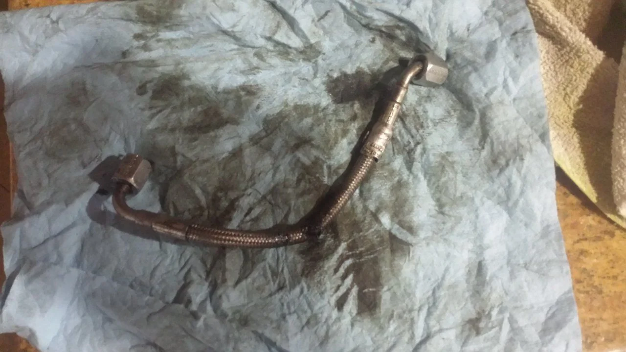

I managed to pinch the vacuum oil line that goes to the engine block. Now that's leaking badly... gonna be waiting on more parts :bang:.
As far as I can see the pump itself is not leaking anymore, but the power steering isn't working. I added power steering fluid, jacked the truck up and turned all the way right then left then right. Still nothing. What am I missing?
Ok crazy theory time! Be gentle in your rebuttals.

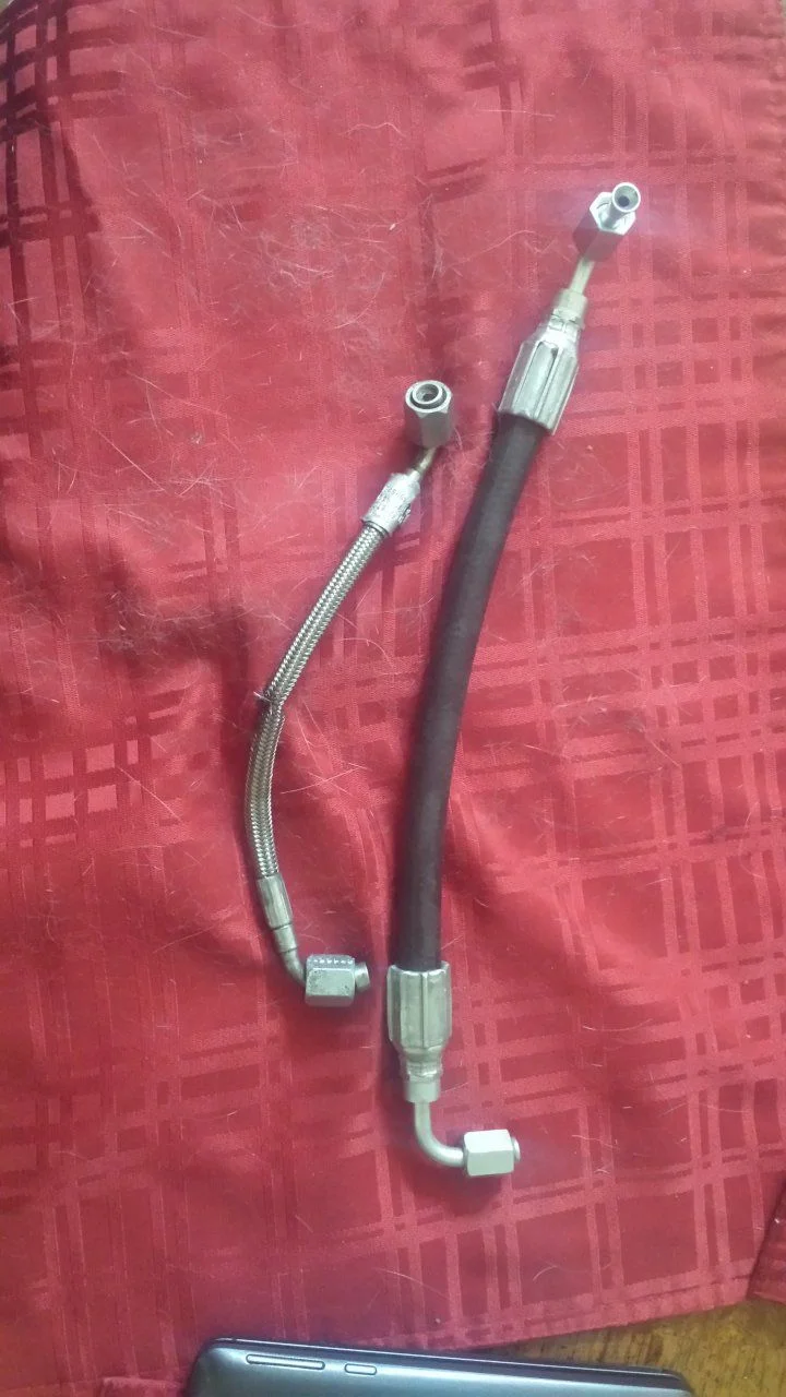

Since the leak is happening on the vacuum oil feed line, that means it's taking in air which means there's no vacuum which in turn means no power steering. Is this possible or did I mess it up while putting it back together?
Took the oil feed line out and had a hydraulic one made at Oreillys. Cheap fix for now.
It fit on there with no leaks. hopefully it can withstand the engine block heat.
