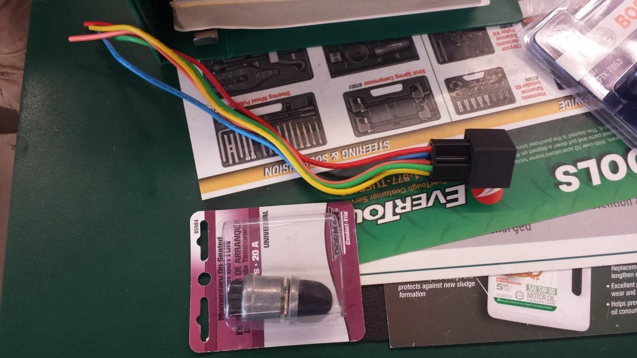

I rekon it's time for an update. I learned in the Marine Corps when you can't figure something out, get one of your Red Neck friends to help you. After realizing it wasn't the starter I went to order an ignition switch, but it was gonna take 7 days and cost just shy of $100. I need the truck tomorrow. So instead, Dylan my buddy decided we can either jump out of the truck and touch the positive to the negative on the starter using a screw driver every time I need to start it, or he can rig something up. I decided he needed to rig something.
So we went to Oreillys and bought this.

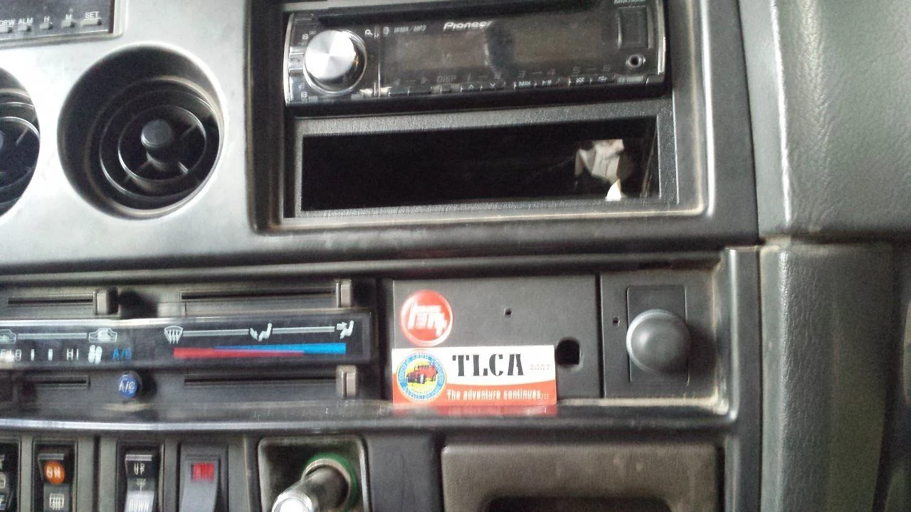

Then we drilled a 5/8 hole
place it somewhere convenient.

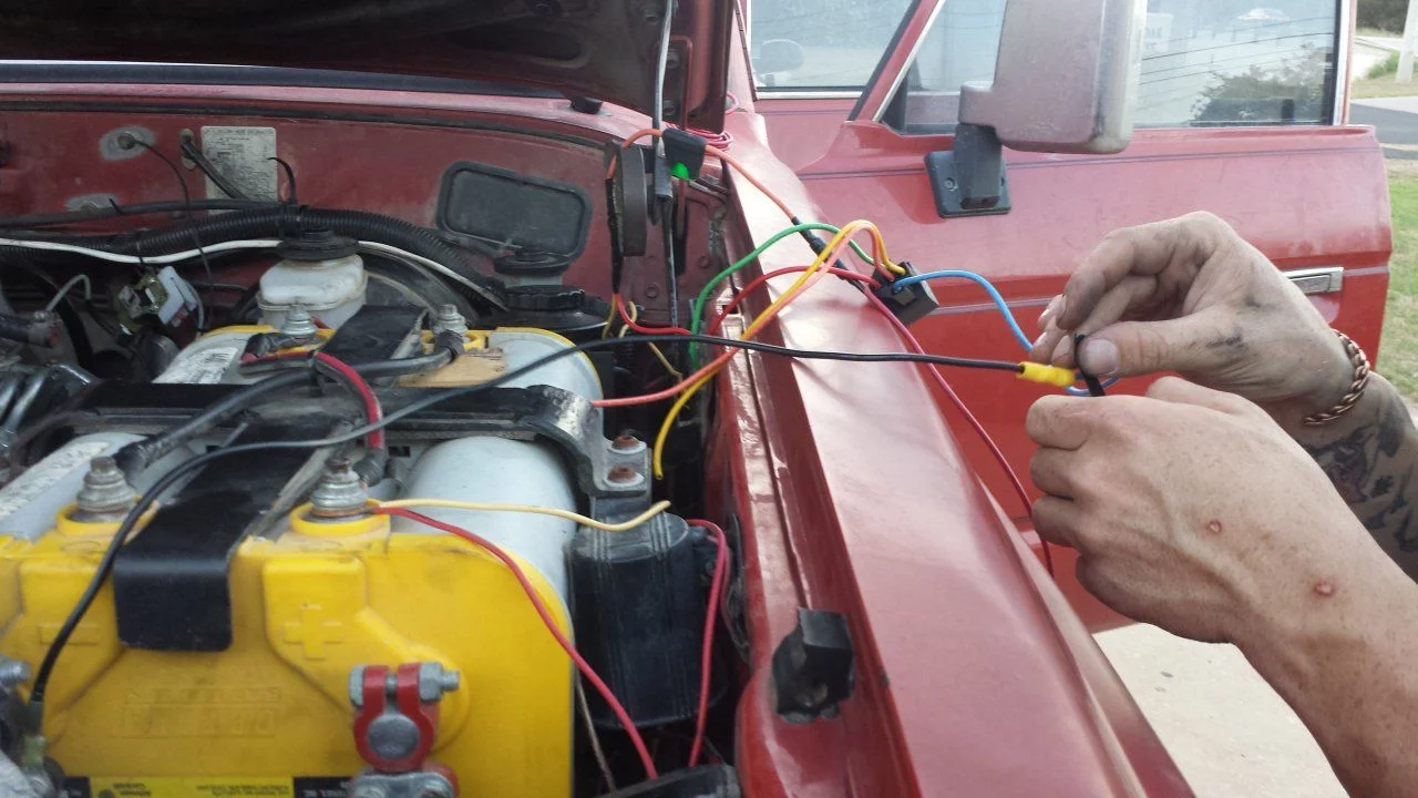

then perform some electrical voodoo

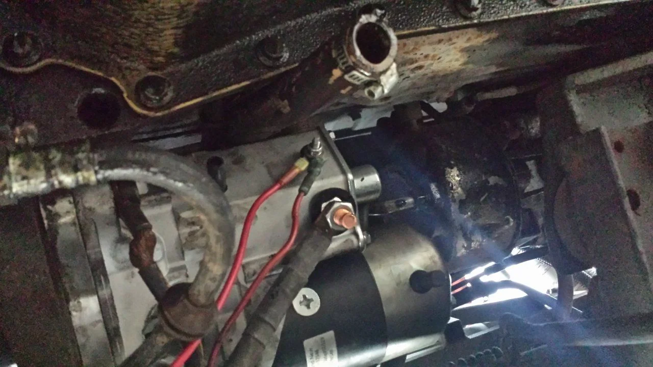

and connect it to the starter solenoid
