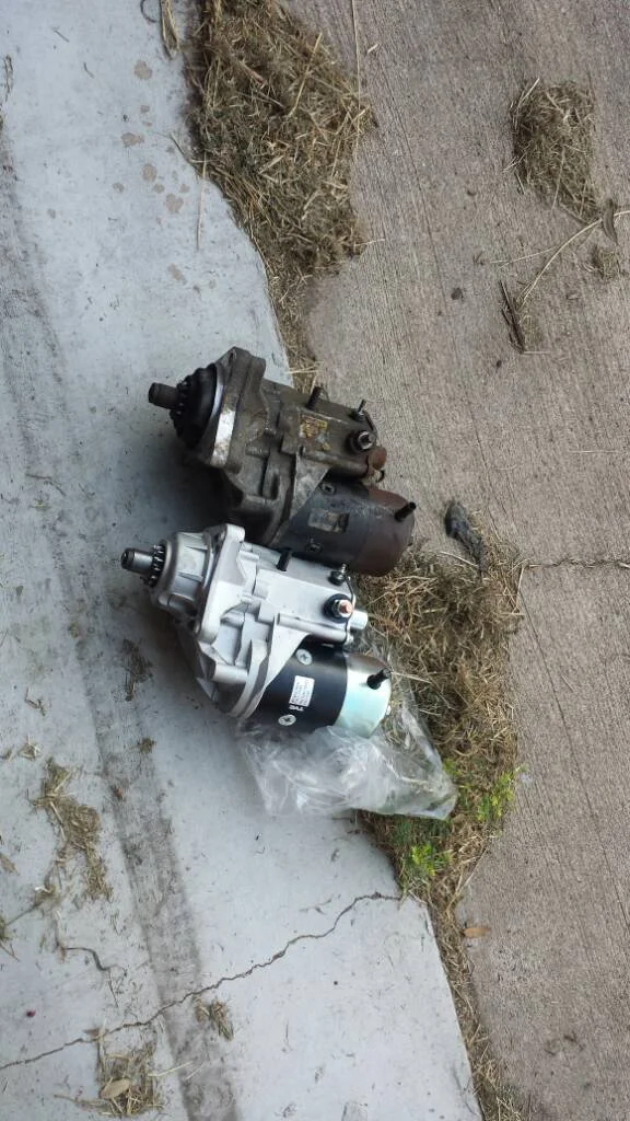

Getting to that top bolt was a pain.
What kind did you get? Who makes the OEM Cunmins starter anyway?
I got the cheapest one on rock auto. $98, but it looks like the starter isn't the issue. Still having the hit or miss starts
