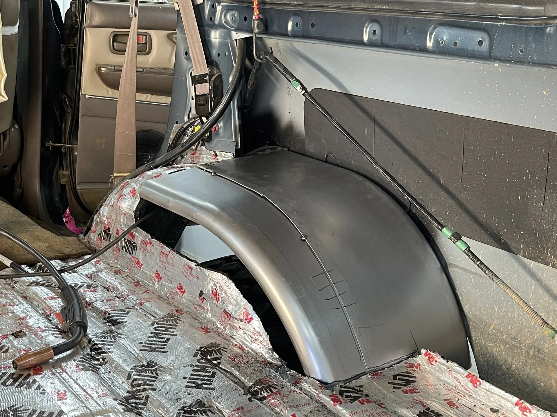

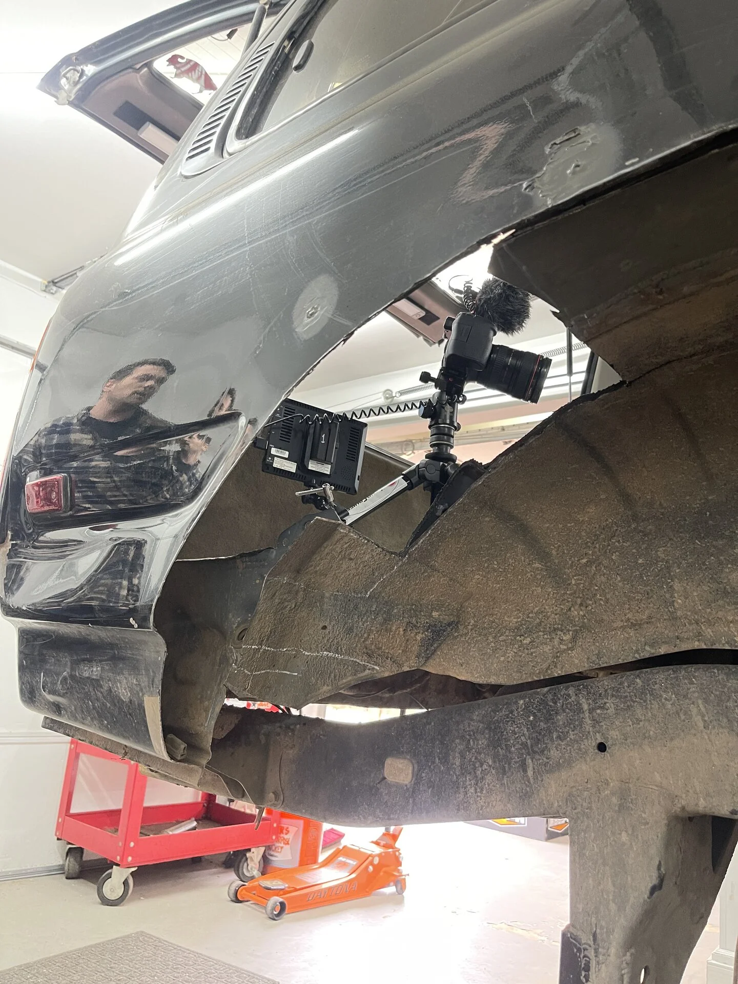

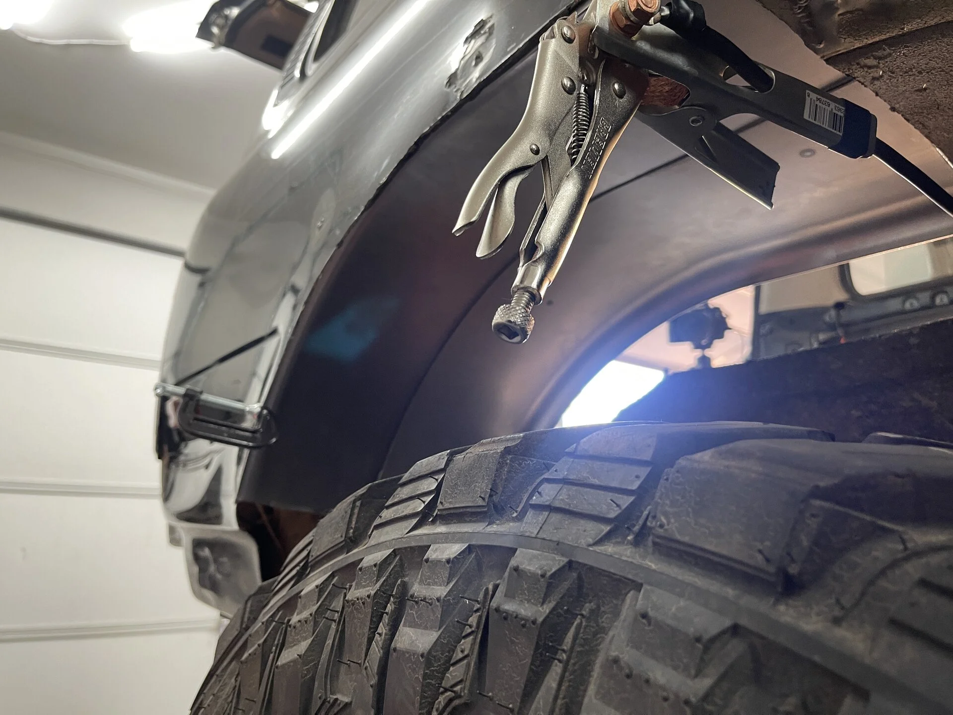

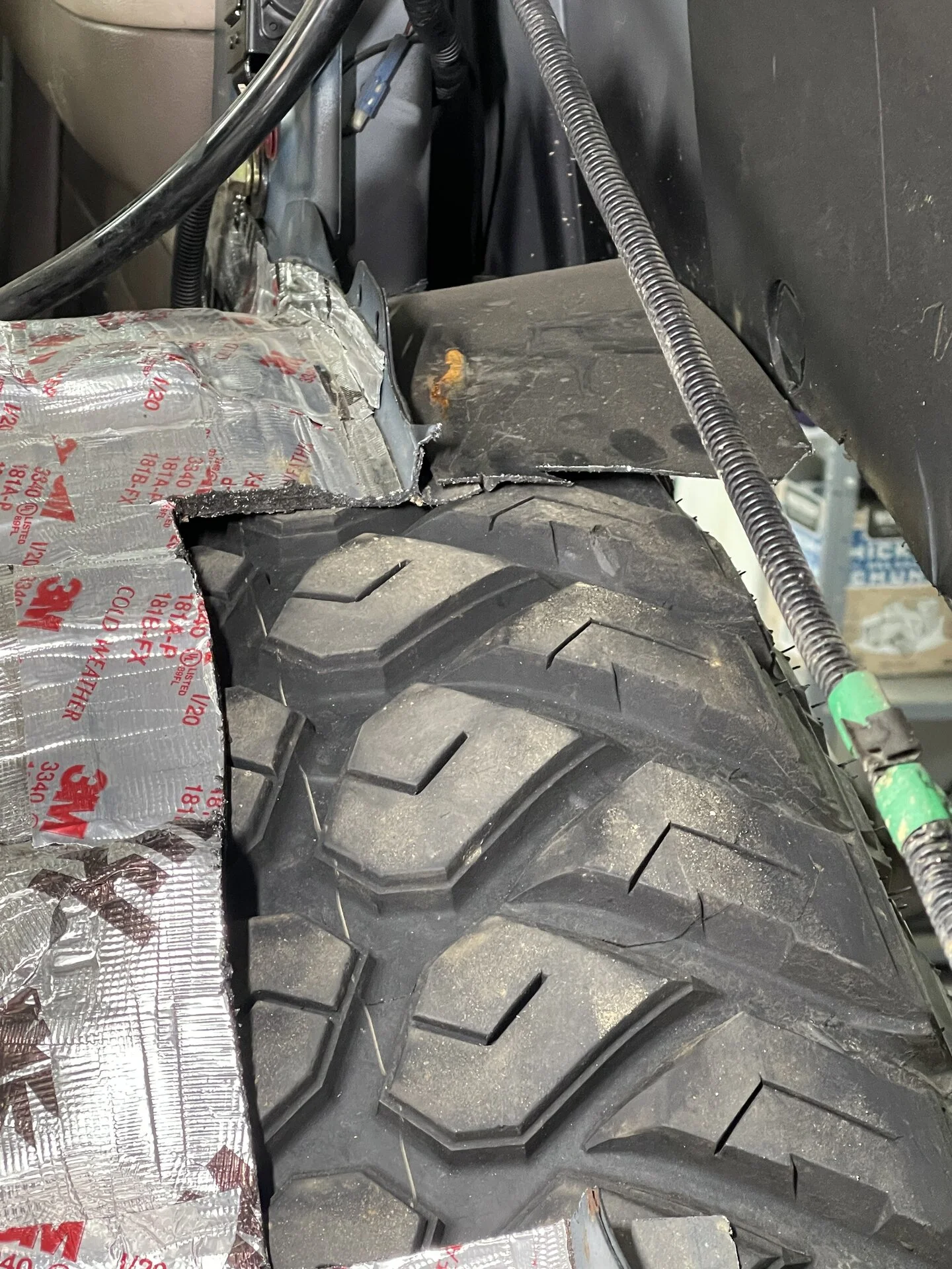

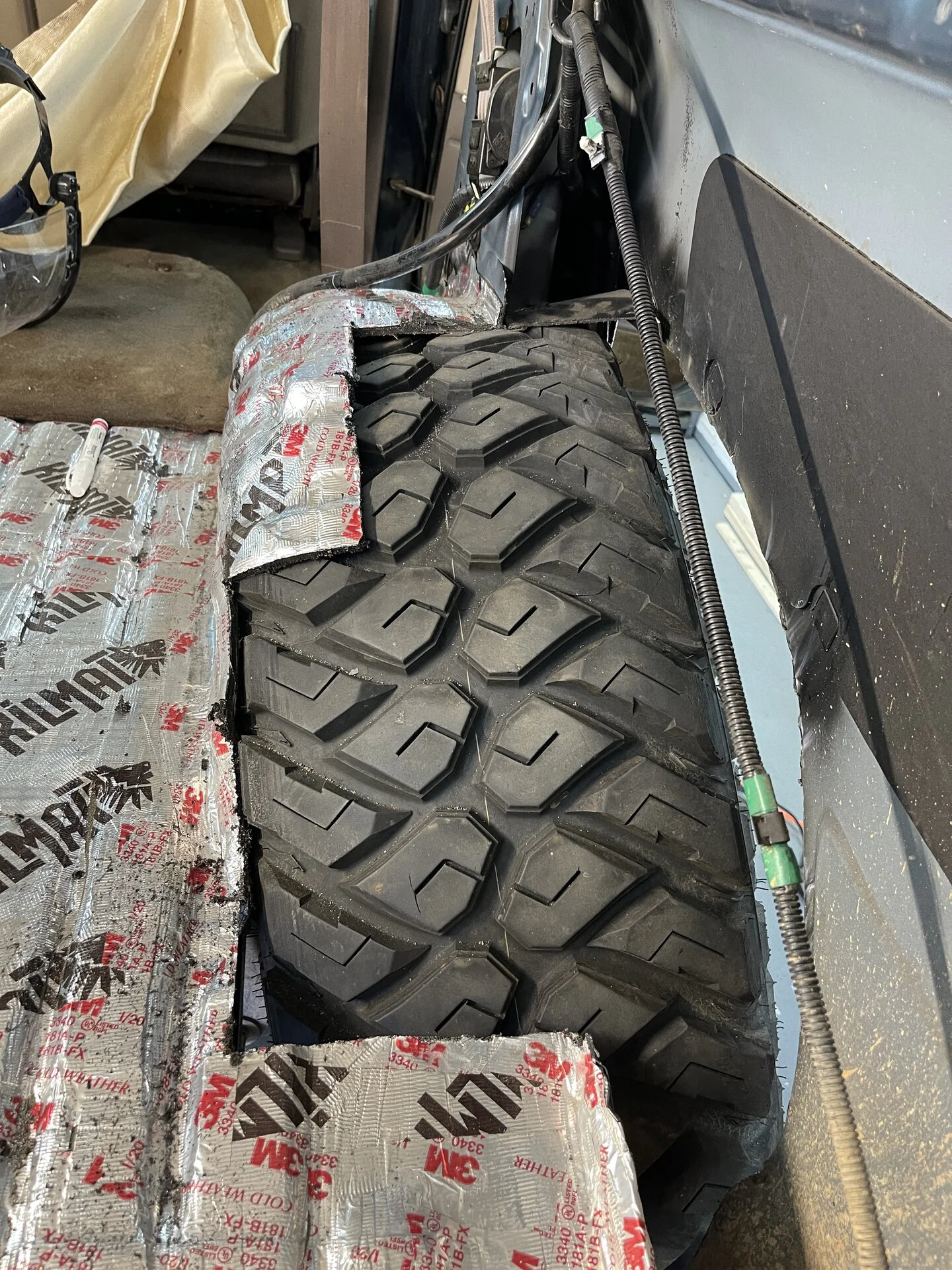

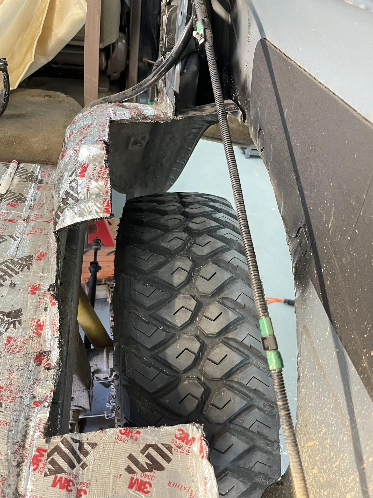

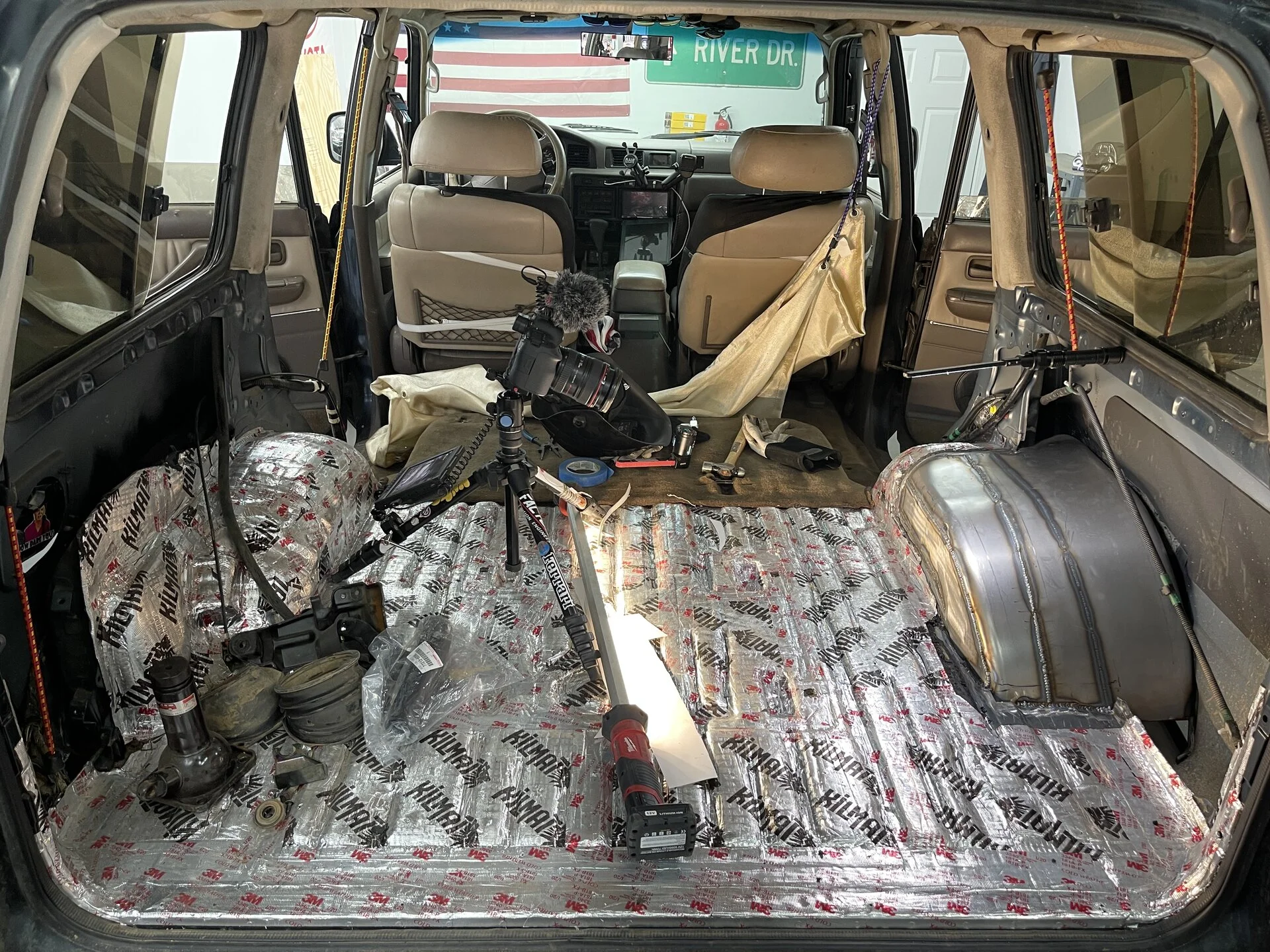

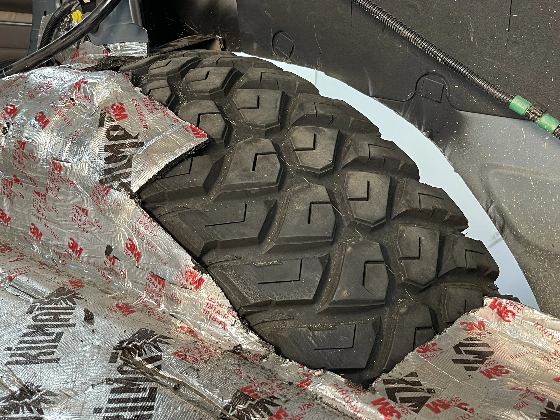

None at the moment, i just did all the measuring yesterday and have decided that 6” total length bump stop with the stock rubber on the end should be perfect. Itll compress the rubber about 3/4” at most, leaving me 5-1/4” from frame to axle, i have 4-3/4” when the tire hits the body and the shock compresses fully. I have about a 1/2” buffer zone between the body and the tires with the 6” bump stop with the rubber bit compressed. Keep in mind, i have only been testing this at full articulation, one side fully extended and the other side as far up as itll go. Hopefully as the tires cycle in all the different combinations of extension/compression i wont encounter rubbing somewhere unexpected.. ill explain that more as i get that giant hole patched up..
Just to clarify, that bump stop has the stock rubber end included, total length is 6”

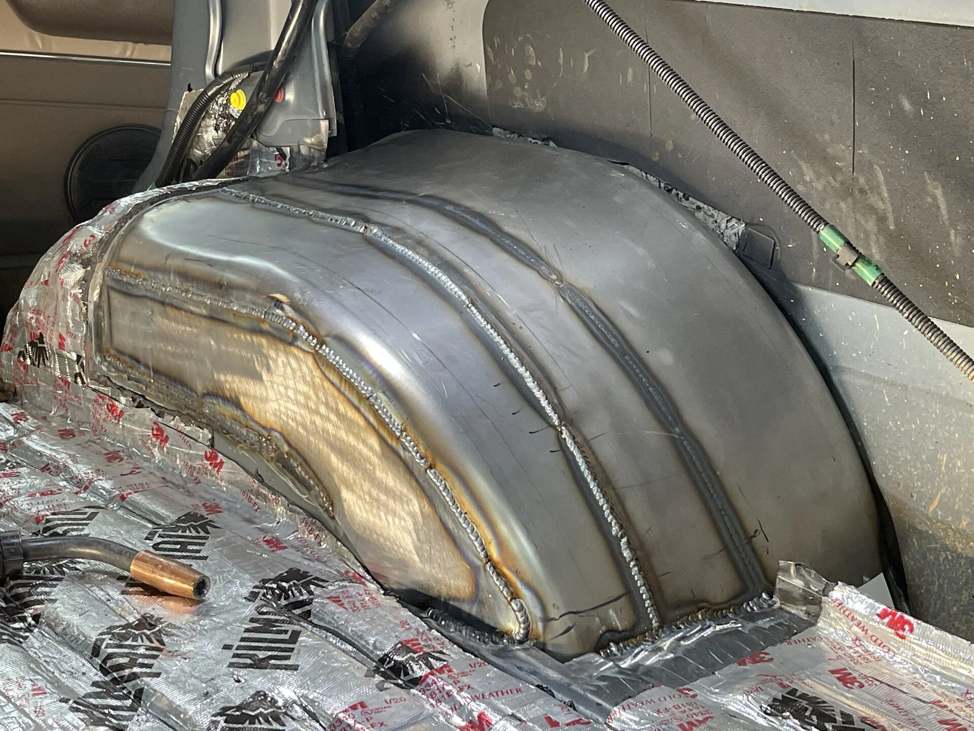

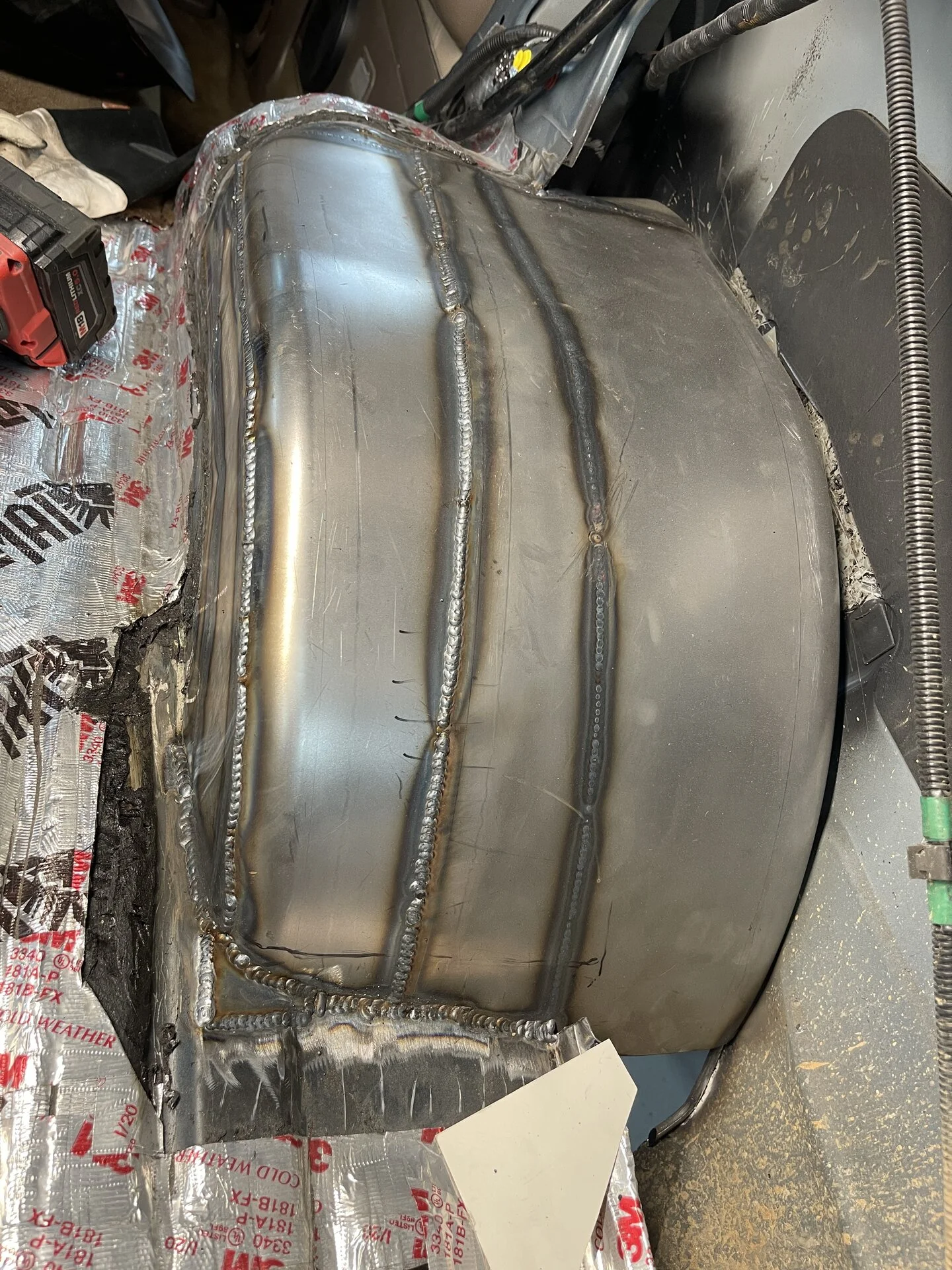

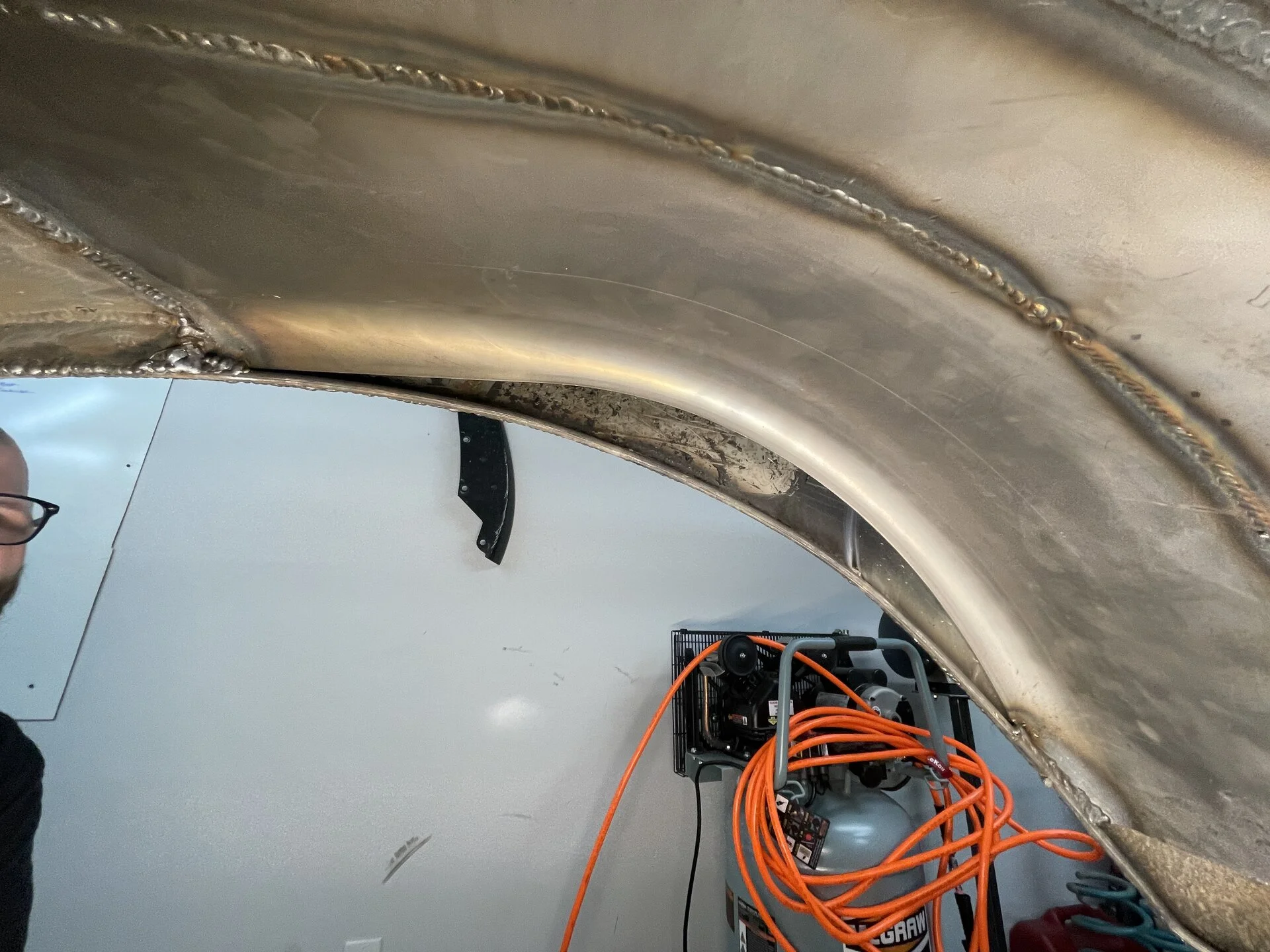

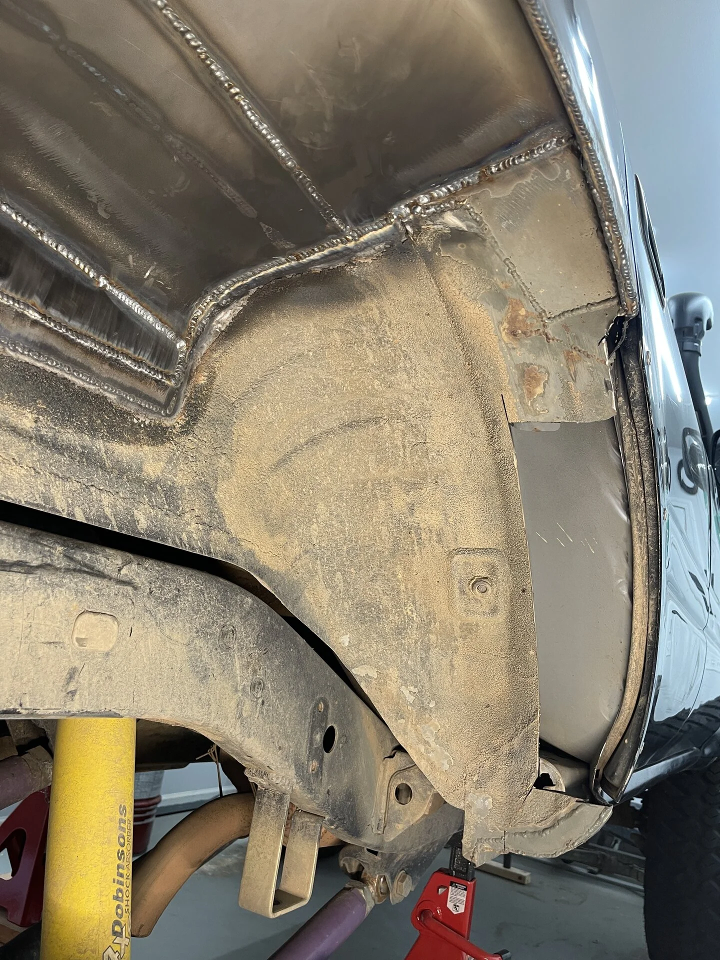

So is one side going to have more clearance then the other ?
Really nice work !!
Thanks

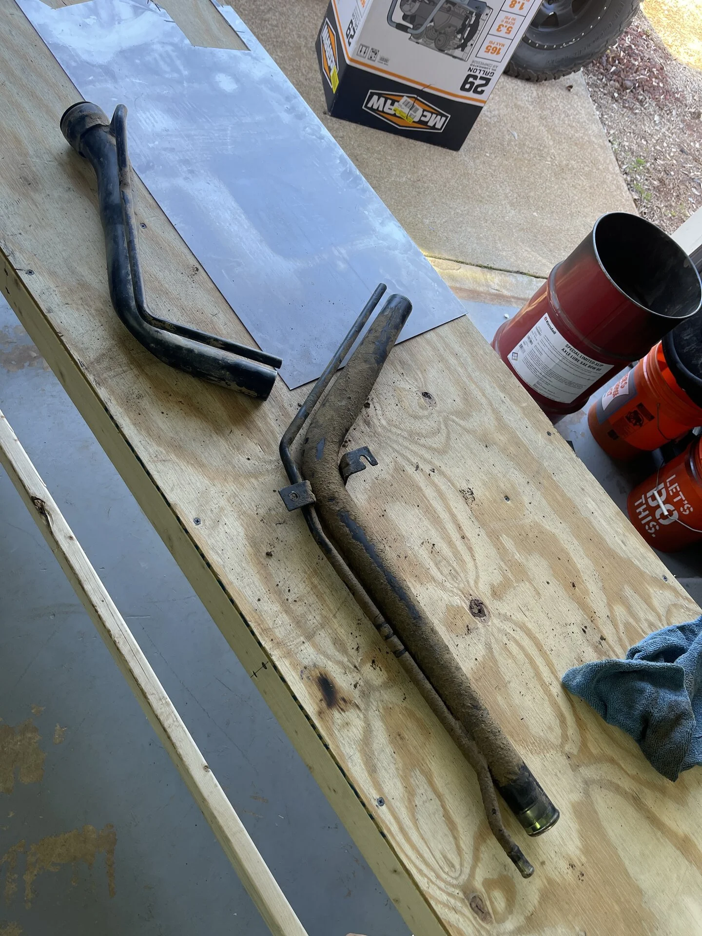

No, i have to cut the left side wide open now too. As you know, the shapes of the wheel wells are totally different due to the fuel filler, and there is already more clearance on the left side because of that. Ill go back in on the left side and make it match the right. Also ill probably have to build an entire section to locate the filler tube rearward enough to clear the tire completely. I tried and tried to avoid that, but now im fully committed to making it all work properly.
