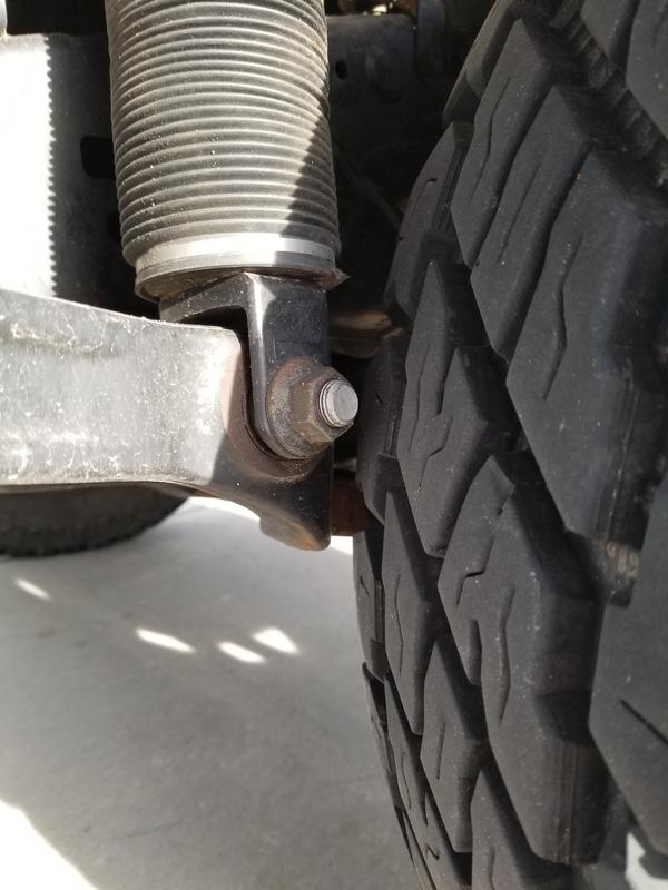

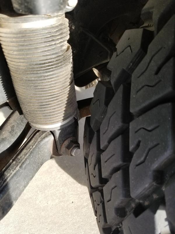

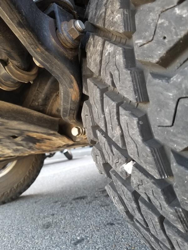

Replaced the end links (they were bent to hell and the bushings were completely hosed) and removed the relocation kit.
The 285/75s rubs a bit on the kdss bar at full lock, nothing horrendous but they do rub. I think with some alignment trickery and/or spacers it won't rub. But I'll deal with it as is. Far better than destroying $200 worth of end links every few months and having to change those things out (which sucks, a lot). Relocation kit promptly went in the rubbish.
Mind you my kdss is unbalanced since I was screwing with the bar. Need to reequalize this weekend.
Humm... that ain’t gonna work, especially when wheeling it, and torque is applied, not just turning the wheel. I can’t remember do you have UCAs?
Your bar bushings are shot also, you can get a bit of downward space with replacing those.

Yes, SPC, zeroed out. I might adjust them to see if that helps.
They rub far less than 35s WITH the relocation kit. Not that that says much. We'll see how bad it is in Moab in a few weeks.
They're in decent shape, just that's the side I lost a relocation/bracket bolt in Baja and the bracket was hanging by one bolt and got bent to s***, therefore the bushing sits in there all wonky. I have another pair of brackets and bushings on the way.
With a set of Spidertrax. No more rub. Passenger side clears by a mile. Plus the stance with 285/75s on RWs with Spidertrax is just about perfect. If I adjusted the SPC UCAs it would probably clear even more, I was just too lazy to pull out my locktite and big torque wrench to retorque the SPC bolt.
Not a huge fan of spacers but it's far better than the relocation kit.
