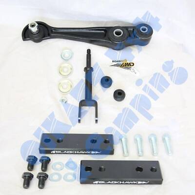

Speaking of Aussie parts. Is anyone familiar with this kit?
EDIT: Never mind, that's for the rear bar.
