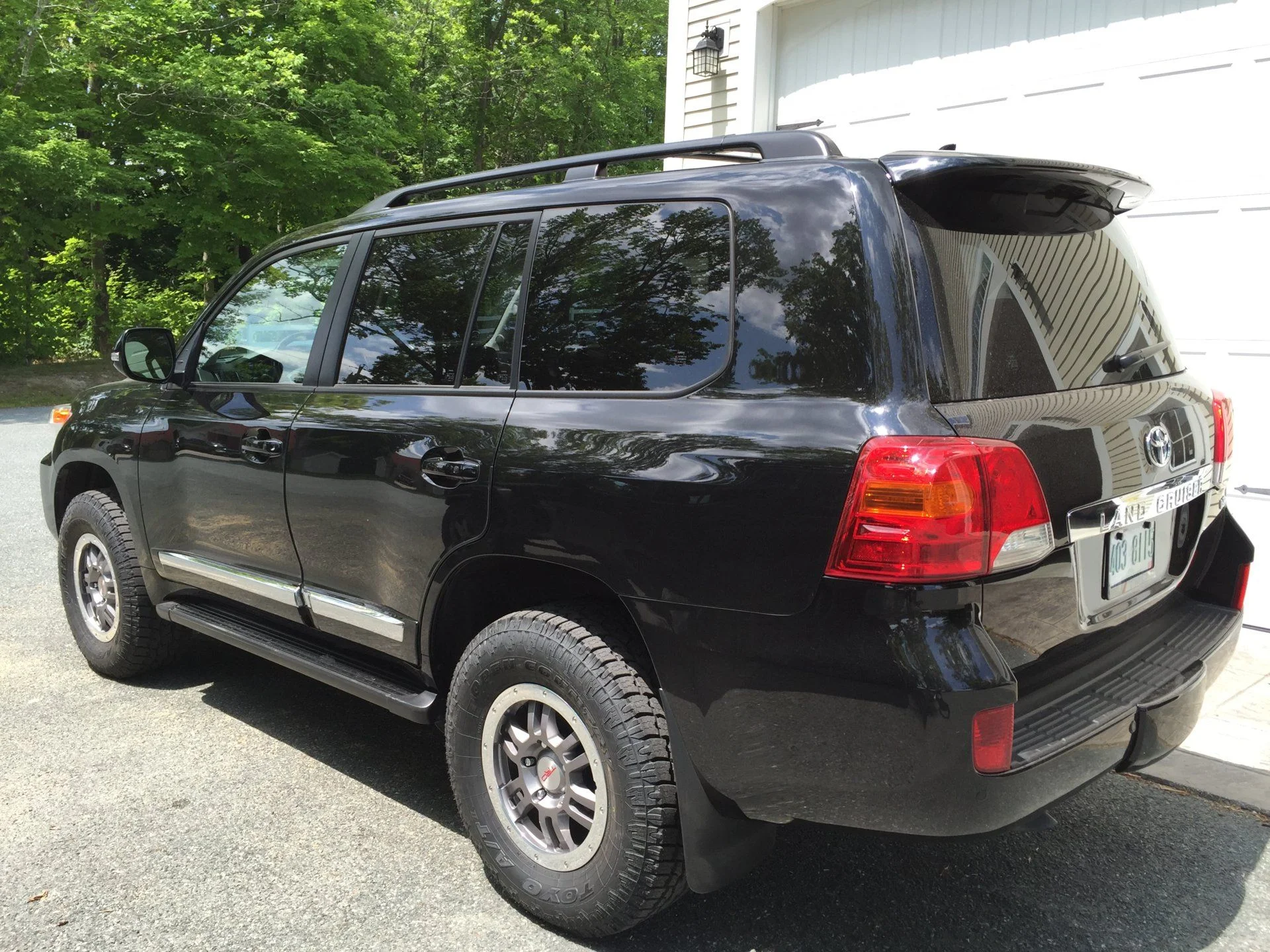

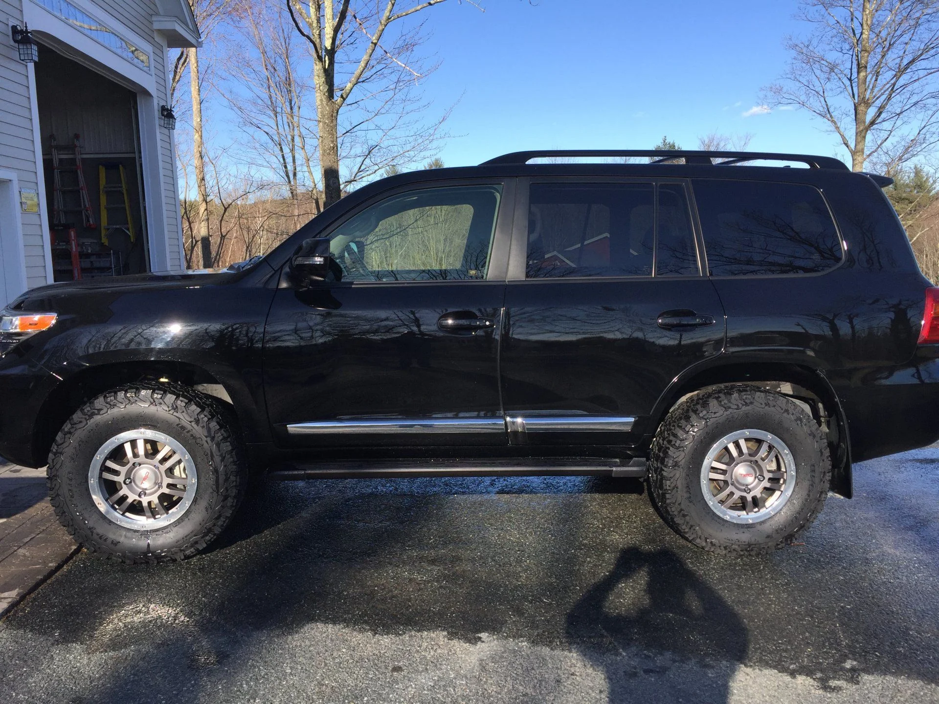

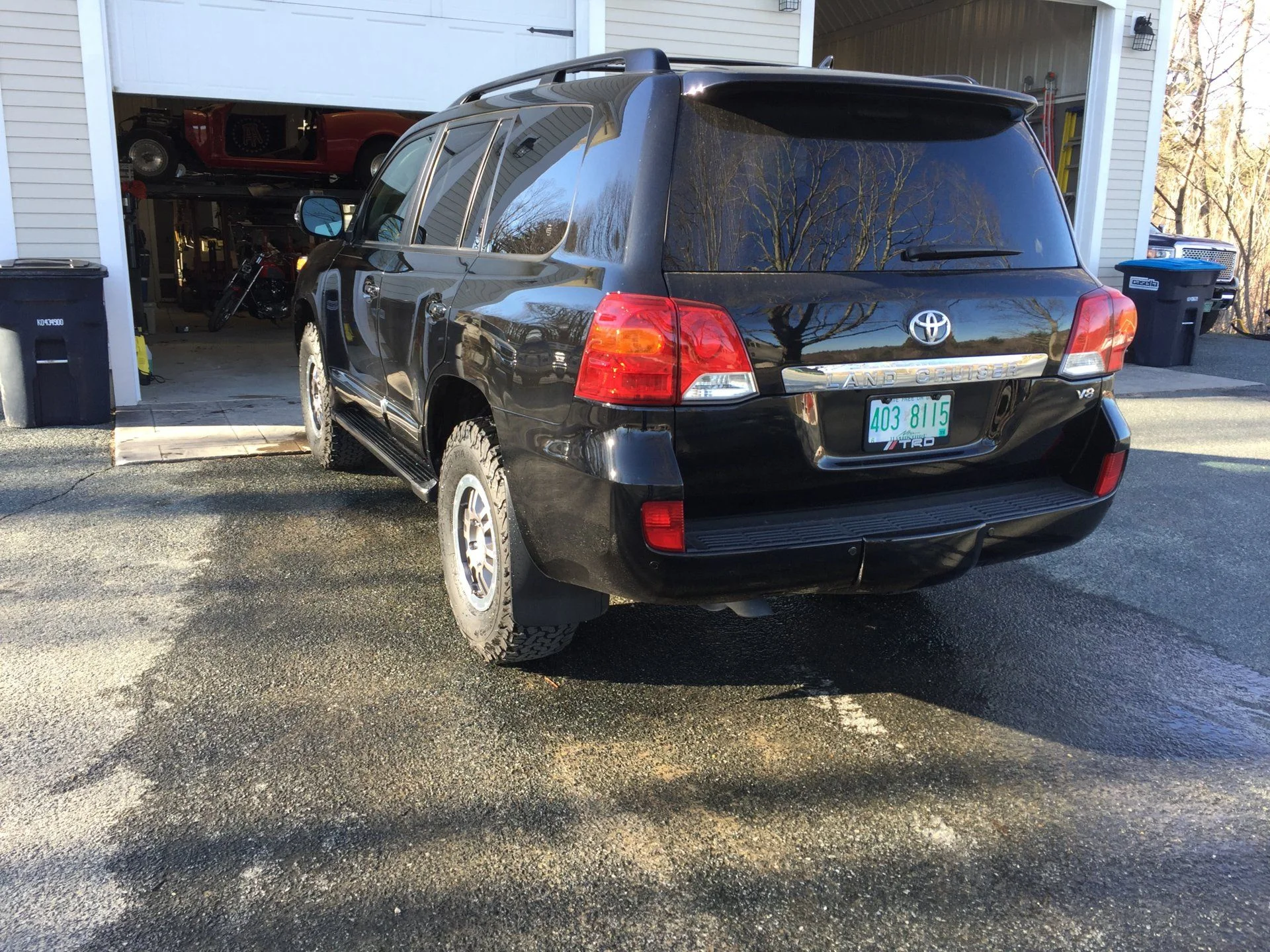

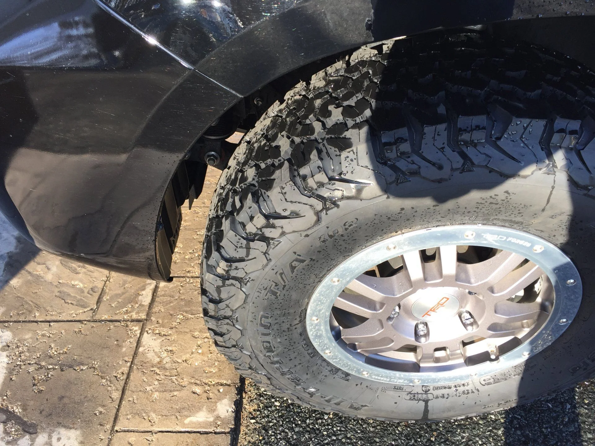

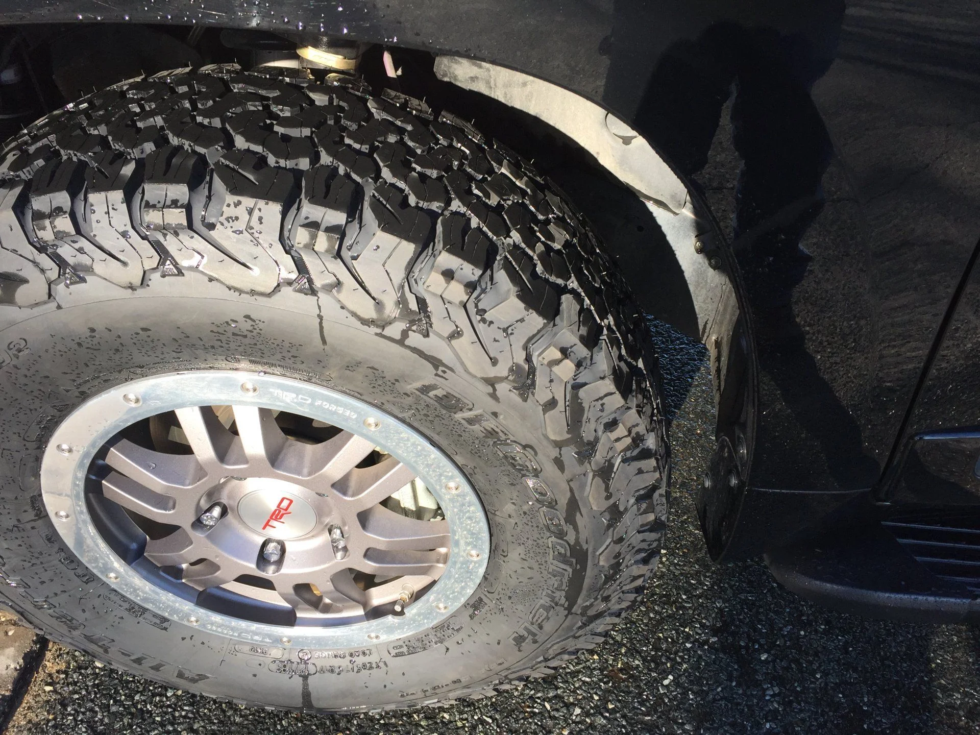

BFG KO2 285/75r17
I was counting on it. Every BFG seems to run undersize. I ran Toyo Open Country A/T 2's last summer in 285/70R17 with spacers. I personally prefer the look of the BFG's.
Yeah, it will fit. Just have to remove a small stamped steel piece
295/70/18 is about the biggest that will fit.
285/75R17 BFG A/T KO2's on RW's.
OME BP-51 with SPC UCA's
No spacers.
No clearance issues on KDSS at full lock.
