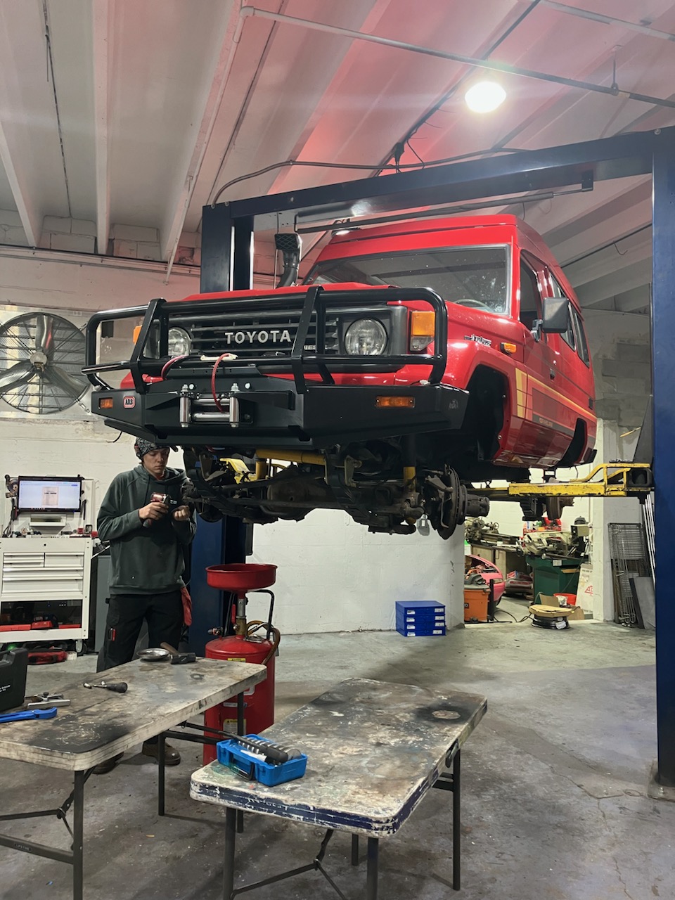

Next victim arrived.. this is going to be a *heavy* rig when finished. We are installing 00-06 Tundra rotors and calipers up front and a disc/drum 80 series booster and master cylinder.

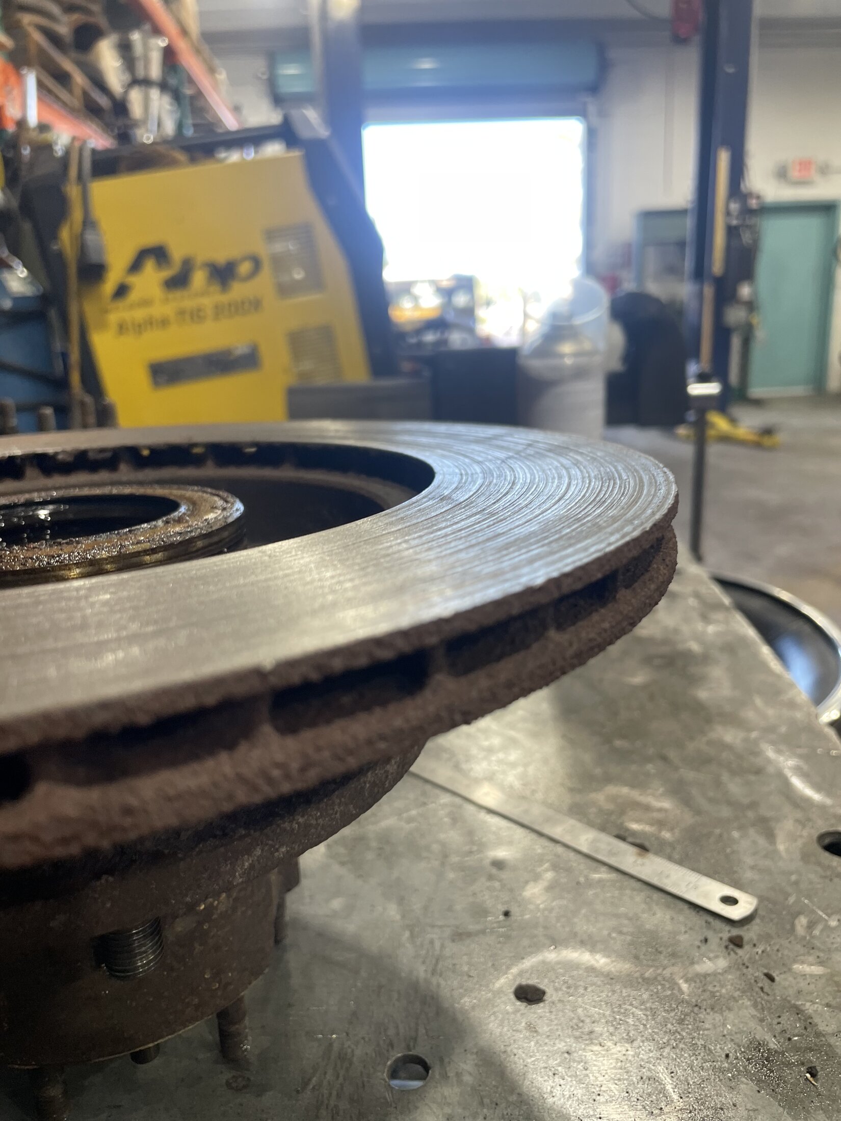

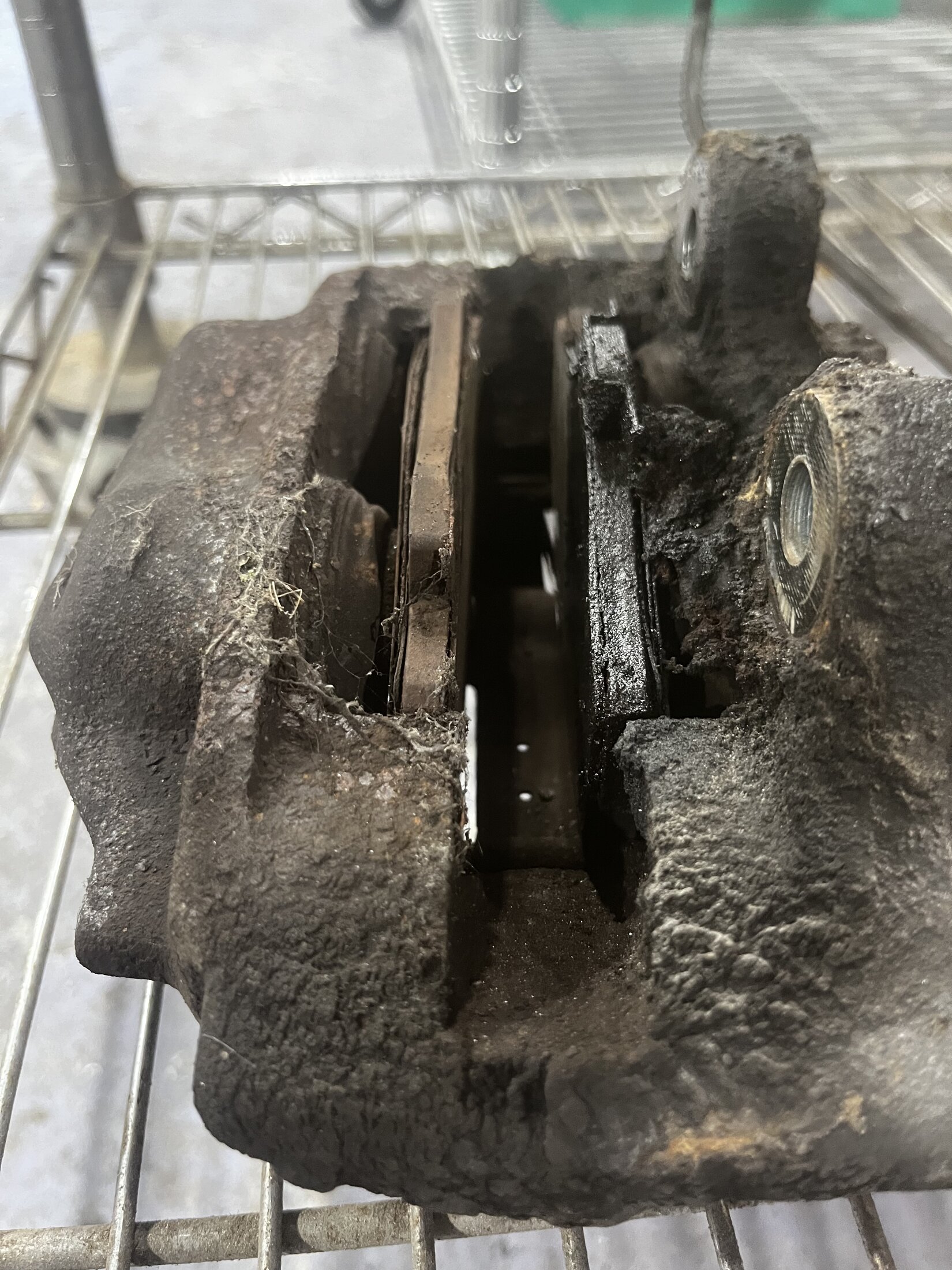

My guys got started on a set of 00-06 Tundra brakes on this HZJ75 this morning.
We are also putting a new OEM 80 booster and 91-92 FJ80 MC
All parts OEM/Advics
This thing was WAY overdue for front brakes :eek: o_O
