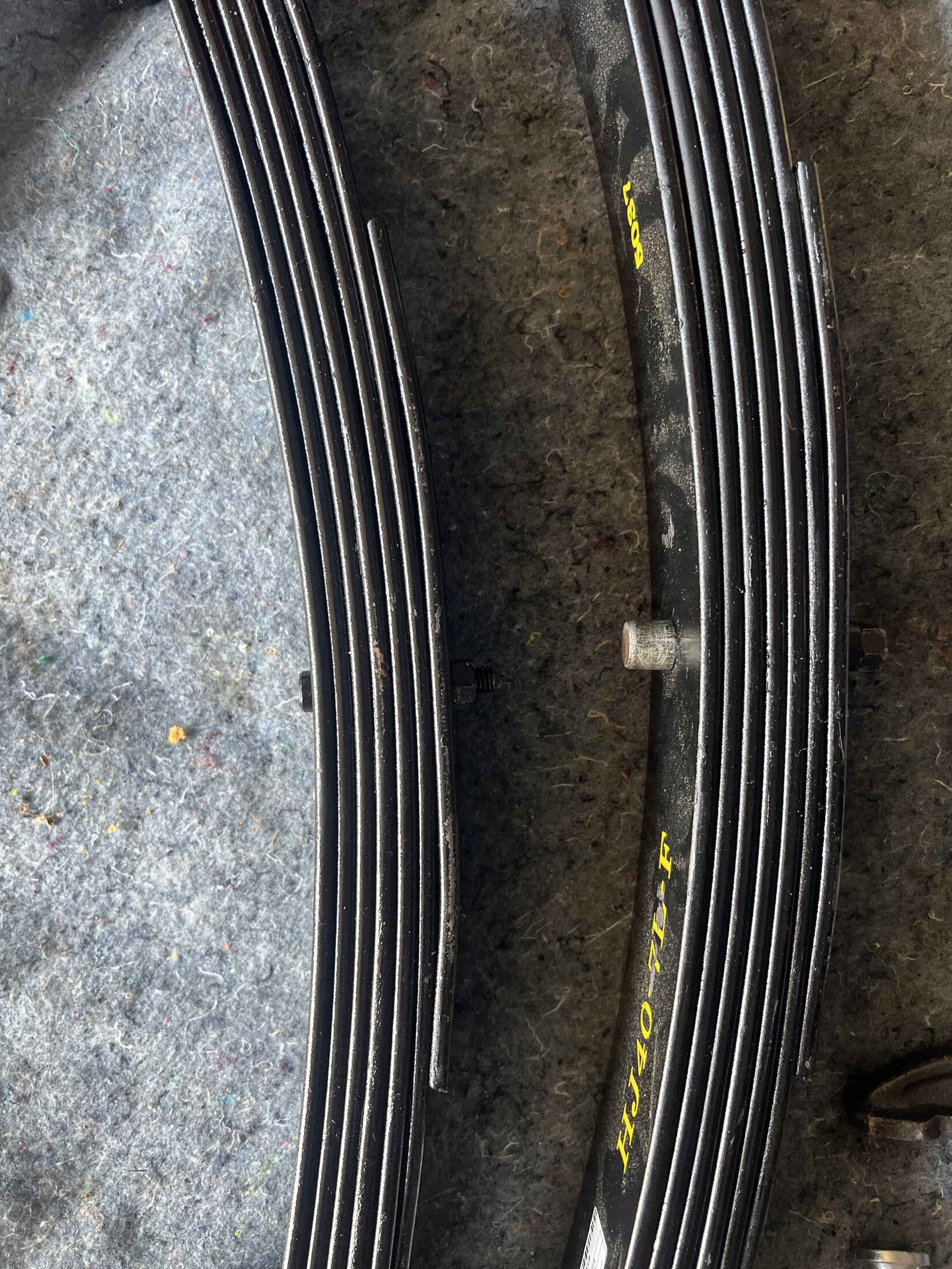

I've got some new dobinsons springs I'm wanting to install. I know I'll need to use 4* caster shims with them but the head of the spring pin is not long enough to reach through the shim and still have enough length to go up into the spring perch. Do I just need to get a different spring pin with a longer head on it?
@Mark Jennings really helped me with my install and here is what he said relating to new pins. Worked like a charm for me:
"I get ‘Steel’ shims from WFO Concepts, 2.5” wide (I’ve bought 2 degree and 4 degree from them). I get the Spring Pack centering bolts from autoandtrucksprings.com. The centering bolts are 3/8 X 3.5 inches and I get the bolt head extensions (p/n CBHL2) that give you an additional 3/8 of an inch to get through the shim and into the centering hole on the axle.The reason for the new centering bolt is that you will need a longer on to go through the spring pack AND the shim, e.g. the shim becomes part of the spring pack."

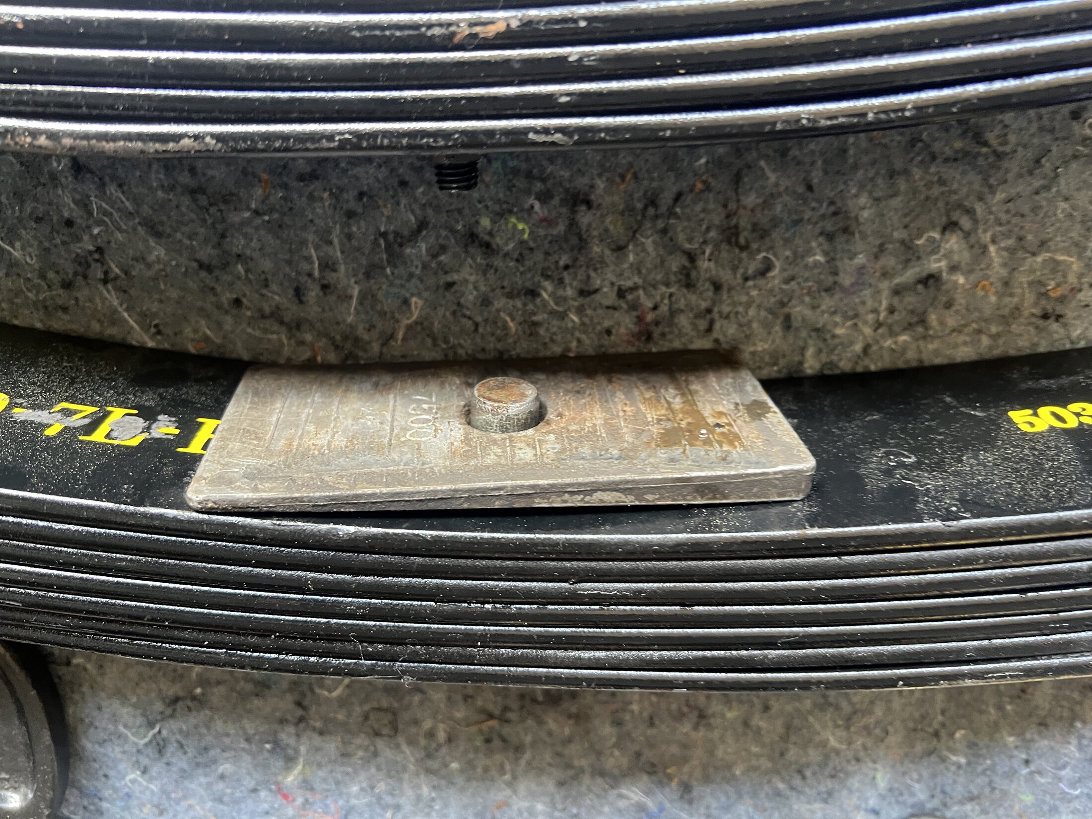

Attached is a picture of installed WFO 2 degree shims, if you zoom in you can see the centering pins poke up through the axle plate. The centering bolt extensions are uber helpful when dropping the axle back in position.
thx for the info on where to get pins and extenstions, did you have to redrill the leaf spring pack using the pins from ATS?

I run Skyjacker springs, don’t know if OME uses the same bolt, but on the Skyjackers, the 3.5 inch bolt is a bit to long, so I just grind flush with the nut once installed. The 3/8’s bolts on my rig were the correct diameter. I would double check on your OME setup.

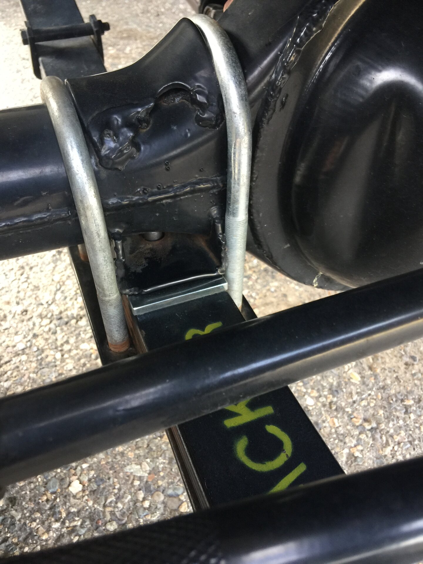

Curious as I need to add a longer bolt to accomodate a 3/8" cruiser lean shim to my right front spring pack figured I'd swap out my aluminum caster shims at the same time for a steel 2 degree
I am currently using 60 series rear spring pins on the front of my 1979 FJ40 with slip over 2.5 degree shims and I'm at +1.5 degrees of caster.
I think that the 2 degree should get me right on to +1 degree.
Please correct me if I'm wrong on my math here.
