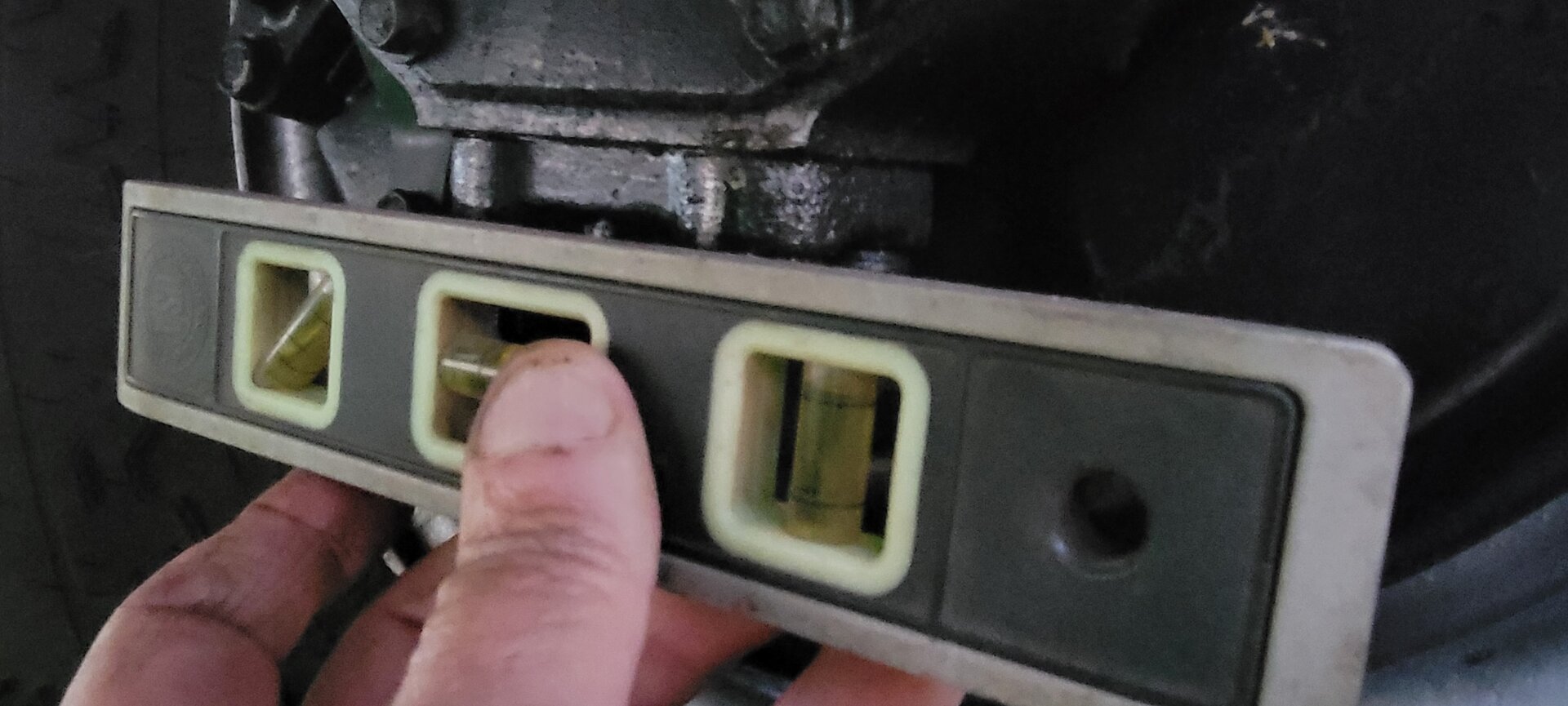

I can get some more pics. Looks like I need an angle finder or an alignment shop. There were a couple posts I;ve seen on Mud where 4* shims fixed steering wander after an OME 2 lift. My truck came with the OME lift done, so I am not exactly sure if its 2", may be 2.5".
You need to know what your caster is , so youll know what degrees shims you'll need. Get the vehicle on level ground, equalize tire pressures and make dure the vehicle is level. Using a angle finder check your current frt caster. In the pic below, pretend the level is the angle finder. Don't use the nuts or studs. You should be able catch the bottom edge of the bearing cap.

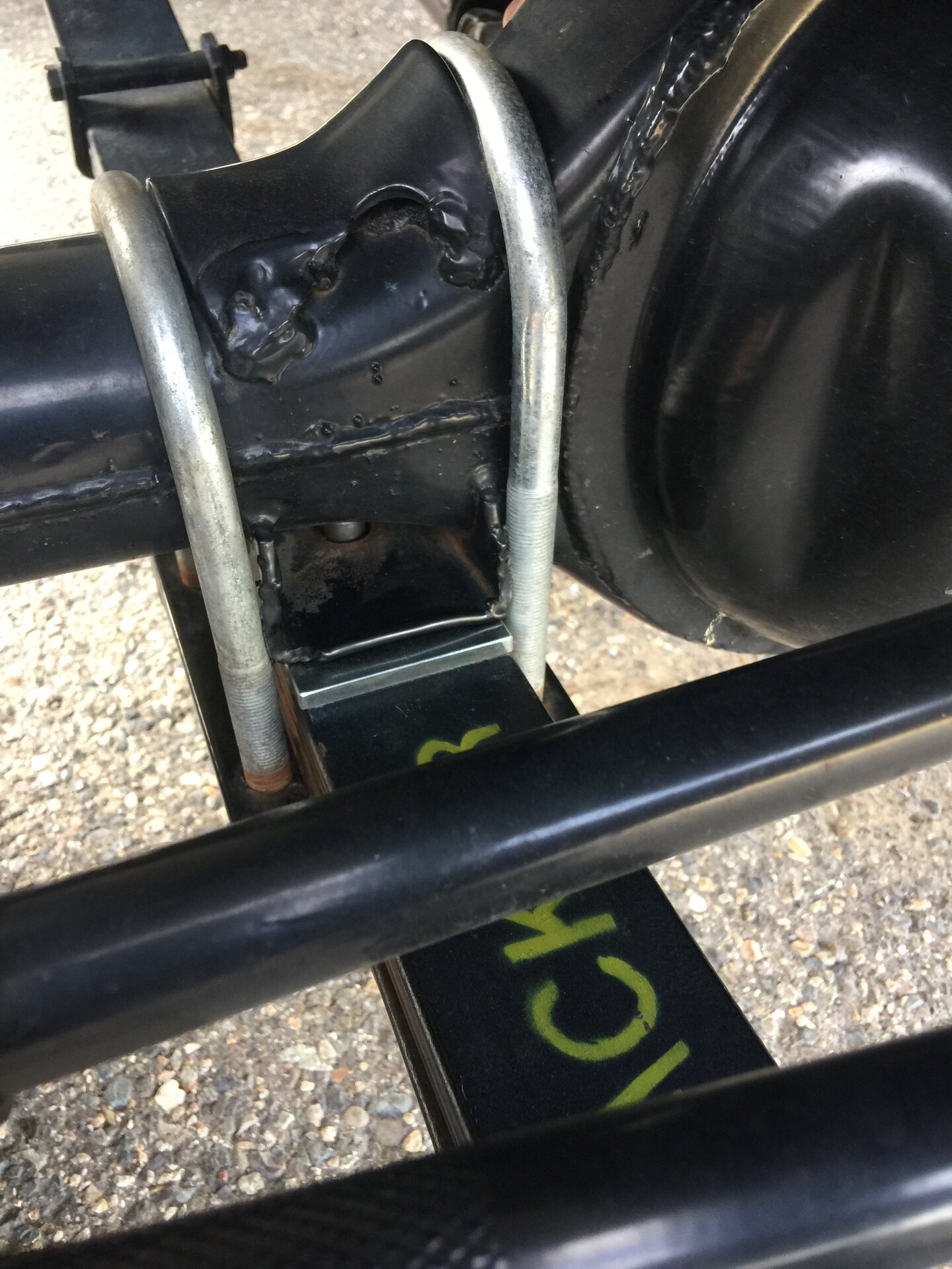

I install my caster shims differently than others. I found when tightening the center center pin bolt with the shim installed, the head of the bolt distorts/bends because of the angle of the shim and weakens it.
My experience: We have a 2-1/2" OME lift. I got the 4 Degree Caster Shims from Cruiser Brothers. For the installation, I did pretty much as you outlined above. But the spring packs had to be drilled out to accommodate the larger pin diameter. I drilled one and it was very tough sledding. I took the second one to a machine shop and let them do it on their press.
I usually drill out the shims hole so the shim fits the spring pin head. Then I install the shim and confirm the caster setting with the U bolts tight. If I'm happy with the angle and test drive, I weld the shim to the axles spring perch. This way the spring pins head is not compromised/bent and I don't have to deal taking apart the spring pack.
I get ‘Steel’ shims from WFO Concepts, 2.5” wide (I’ve bought 2 degree and 4 degree from them). I get the Spring Pack centering bolts from autoandtrucksprings.com. The centering bolts are 3/8 X 3.5 inches and I get the bolt head extensions (p/n CBHL2) that give you an additional 3/8 of an inch to get through the shim and into the centering hole on the axle.
A 2 degree shim should restore caster to original Toyota spec with 2.5” springs as long as the shackles are stock length. If you go with 4 degree shims in the front you may start to impact the front driveshaft pinion angle.
Bottom Line….Do Not use aluminum shim plates, they wear, so you’re always back under the rig tightening the ‘U’ bolts or they break under load.
I run Skyjacker springs, don’t know if OME uses the same bolt, but on the Skyjackers, the 3.5 inch bolt is a bit to long, so I just grind flush with the nut once installed. The 3/8’s bolts on my rig were the correct diameter. I would double check on your OME setup.
