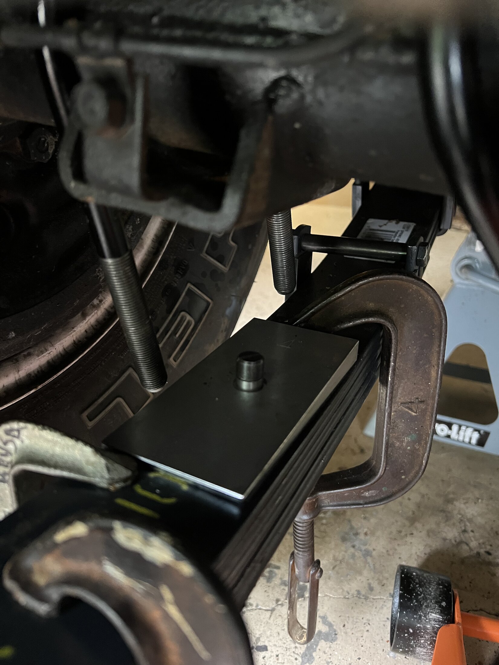

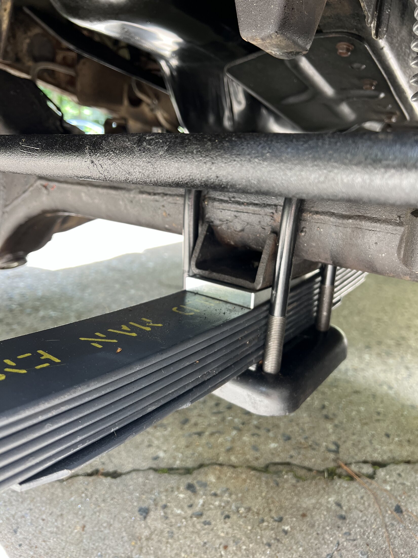

I installed the CruiserTeq 4* shims this past weekend and it made a significant difference. I can now drive confidently at 60-65mph and the truck tracks perfectly straight. No more wandering and fighting the steering to keep it on the road . It also handles A LOT better when cornering. Thanks all for your help with my installation questions. I’m glad to say the shims solved my entire problem!
A couple notes...
-With the OME leafs I had to use 5/16" x 3" bolts. I used hardened steel with an allen style head. All the centering pins for leaf springs I was finding locally were 3/8" size which were too big. The 5/16" bolts worked perfectly. I used nylon lock nuts on the bottom.
-To support the front axle it was very helpful to have 2 jacks, it made life much easier.
