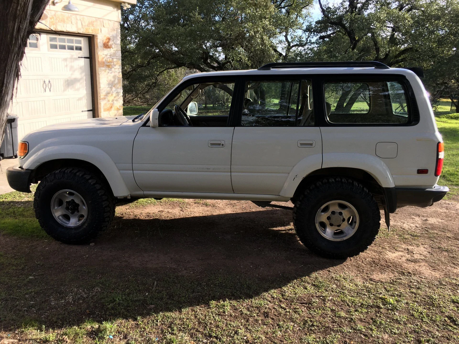

I kick myself for not getting 37s just ‘cause. But the 315s work well with my busted old Ironman lift that is 2.5-3.5 in depending on what corner you measure :hillbilly:

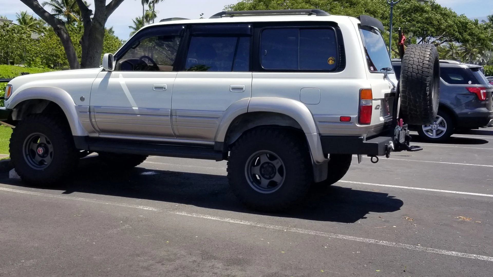

2” iron man and 315’s, this is what my budget build currently looks like. Kind of wish I had sprung for the 2.5” Dobinsons but may go ahead and toss those in the front as opposed to spacers to level her out. Some day I’m going to install the 10% underdrive and low range gears in the TC, will yield the equivalent of 4.56 gearing for the high range.
I’m happy with the path I’m on, definitely like the 35’s so far.
