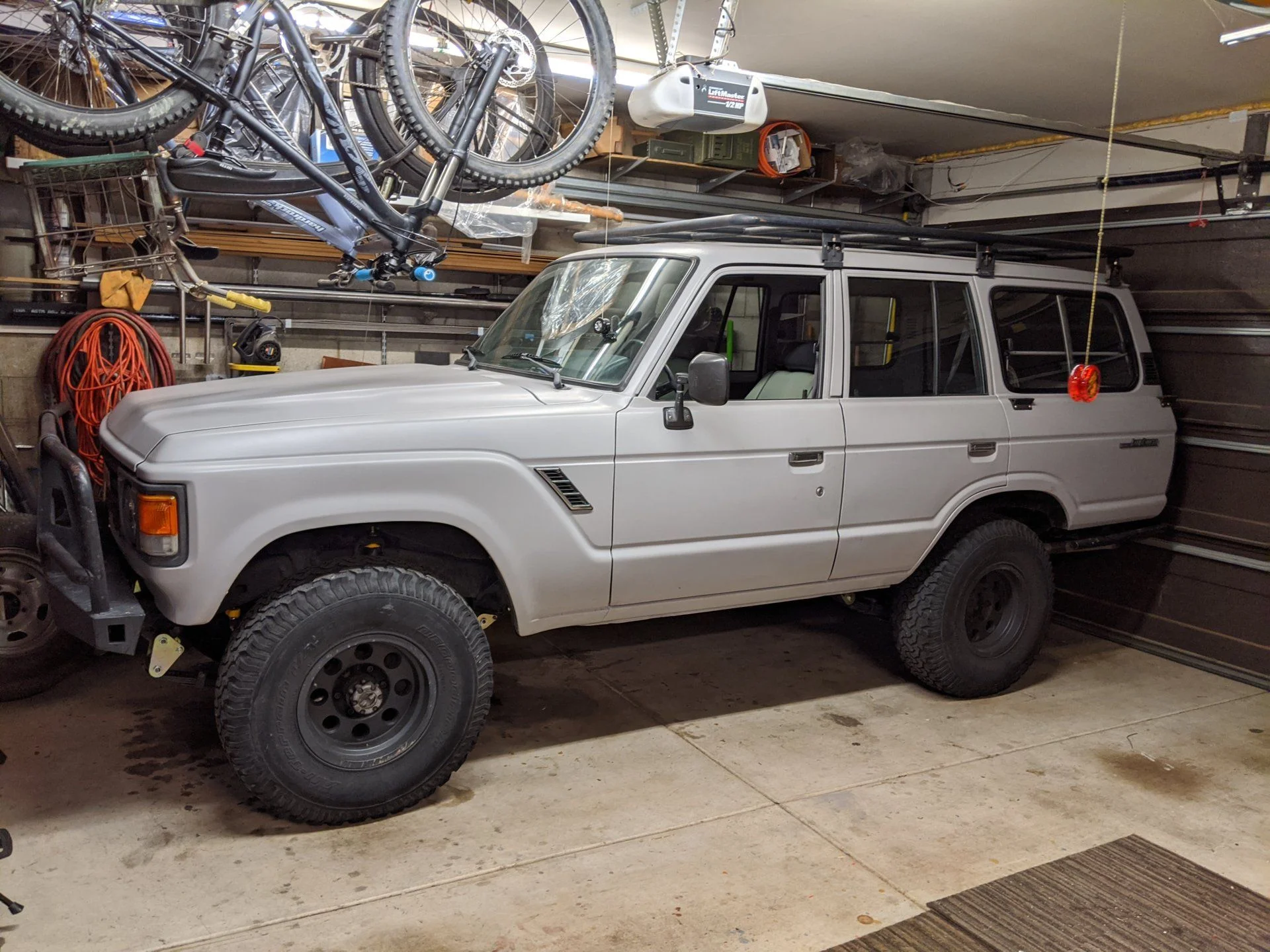

I went for old man emu. 2.5" lift
34" ko2's
Medium springs upfront
Heavys at the back with an add a leaf.
Have a bull bar, winch up front
The rear has a steel bumper, tire carrier, and loaded with a drawer storage unit.
Also we carry a rtt.
The truck rides much better loaded.
