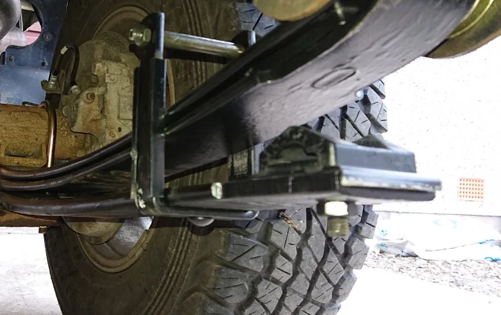

do you think the low leaf doesn't give problems in the mud and on the rocks? isn't that too low?
Parabolic springs can get hung up on things, but that's something you just have to be careful off when using that type of spring. You'll also have to clean them out well after you go through any serious mud
Wow surprised those are not already on the leaf pack! Curious if this is like this on all kits or just yours.
