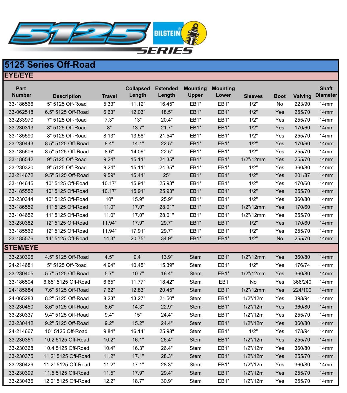

Went with some OME CS004rb rear and CS004f front springs (rough lift 2-3 inches) and am torn between Bilstein 5100/5125/4600 shocks VS. Old Man Emu. I hear the Bilsteins are giving a great ride and the OME ones as of late are valved a bit stiff?

Front 33-230368 360/80 valving for an arb bumper and winch up front.
Rear 33-185606 255/70 valving.
I've been very happy with both 400 lbs over and completely empty and the 33-105606 rear.
I'm running CS005F and CS005RA/RB and it rides great. I've had the truck flexed out off road and the shock lengths were not an issue.
You did not have to use a shock mount adapter then?
No, the end styles are correct for my 87.
You may have to swap the rear upper bushings depending on what upper shock pins you've got, but that isn't a huge issue.
