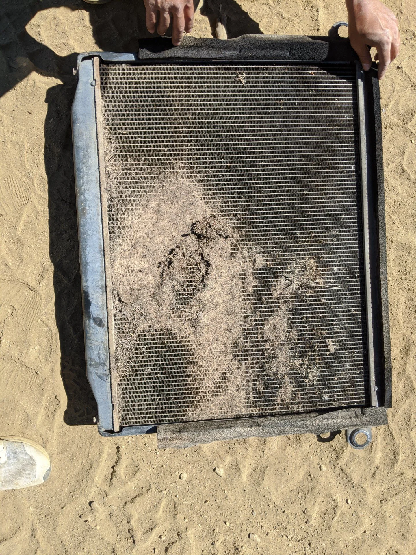

Reminder to check your radiator. Mines blew up on the trail. Made another camping trip out of it.
