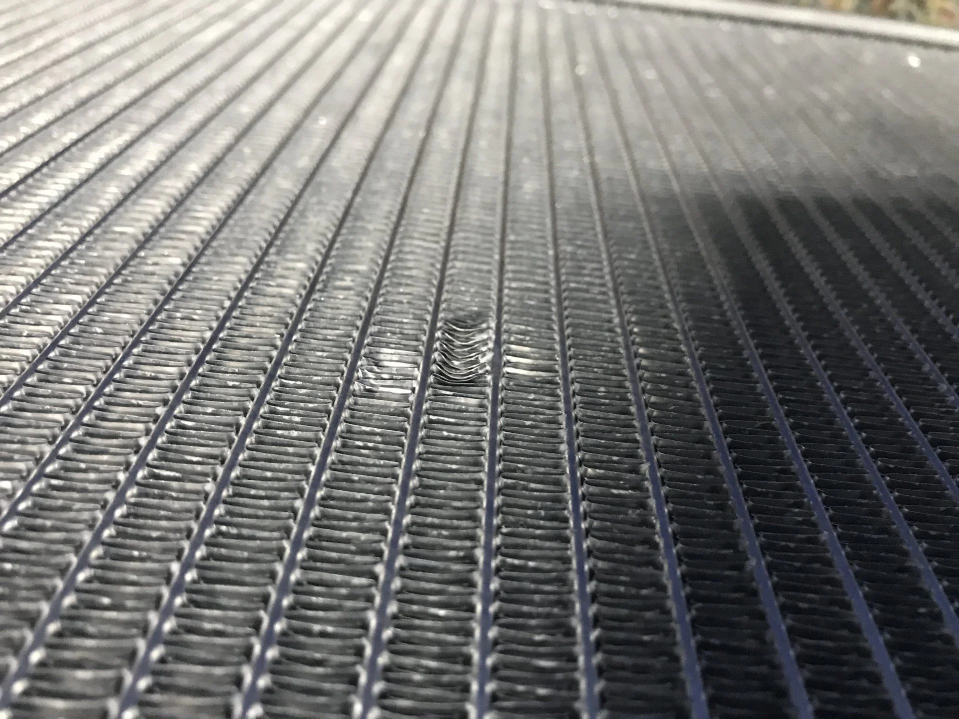

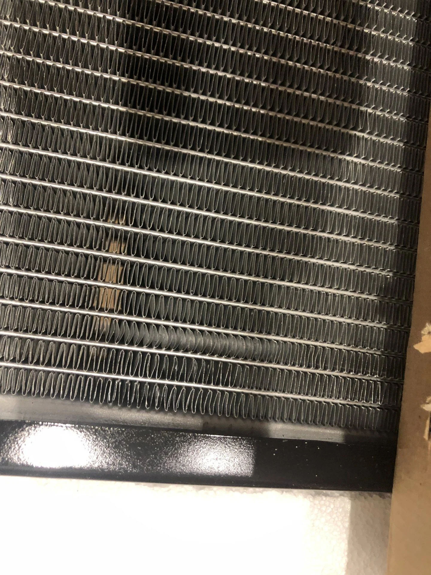

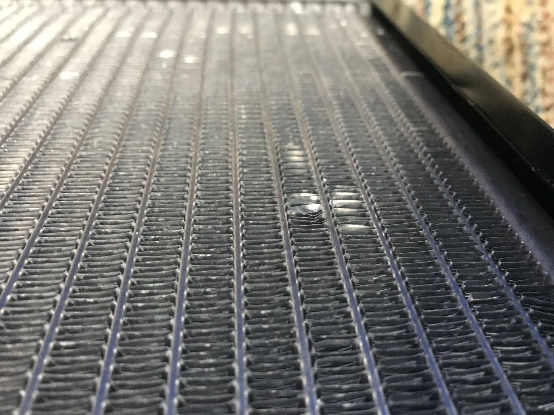

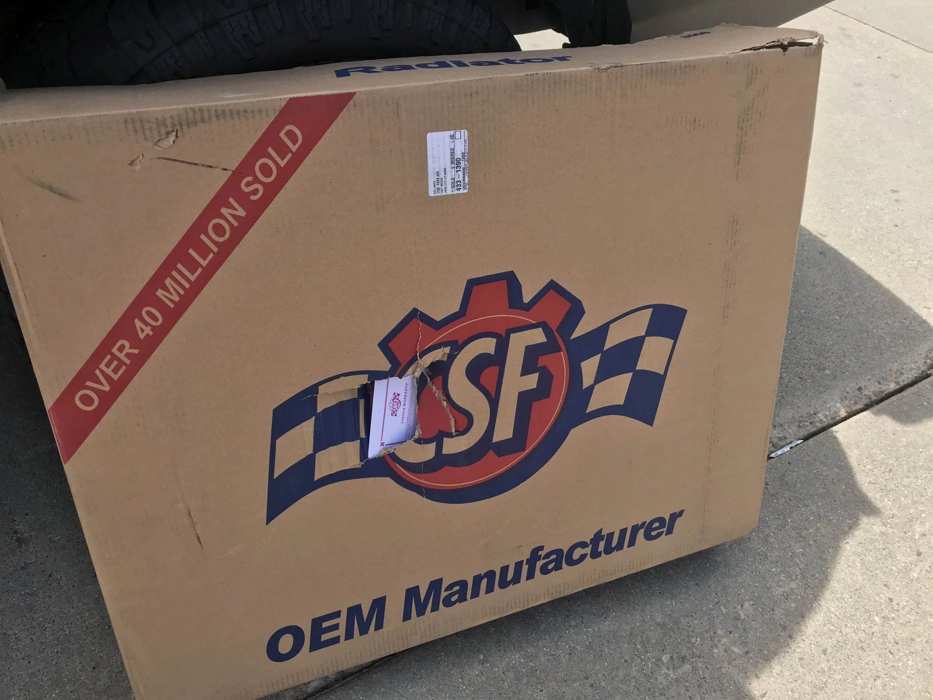

So second radiator arrived. Purchased from Summit, drop-shipped from CSF. This box is at least new unlike the first one sent which was clearly a repackage. But the packaging is still damaged. Multiple places have the fins bent. Plastic top and bottom look fine and where far better protected by the packaging.
I'm still at a loss for what is okay in a radiator and any help is appreciated. Return this one and purchase another from somewhere local? This is okay and some bent fins are normal? Help please.

Bent fins are no big deal. Bend them back. I don't know if I'd blame the shipping company. That's like a 30" span of cardboard with no reinforcement. Due to the proportions, that box will likely lay flat along the trip somewhere. The vendor should've double boxed.
A couple of dimes more in packaging...

I installed my CSF on Saturday, I was really scared after seeing the packaging (or what was left of it)

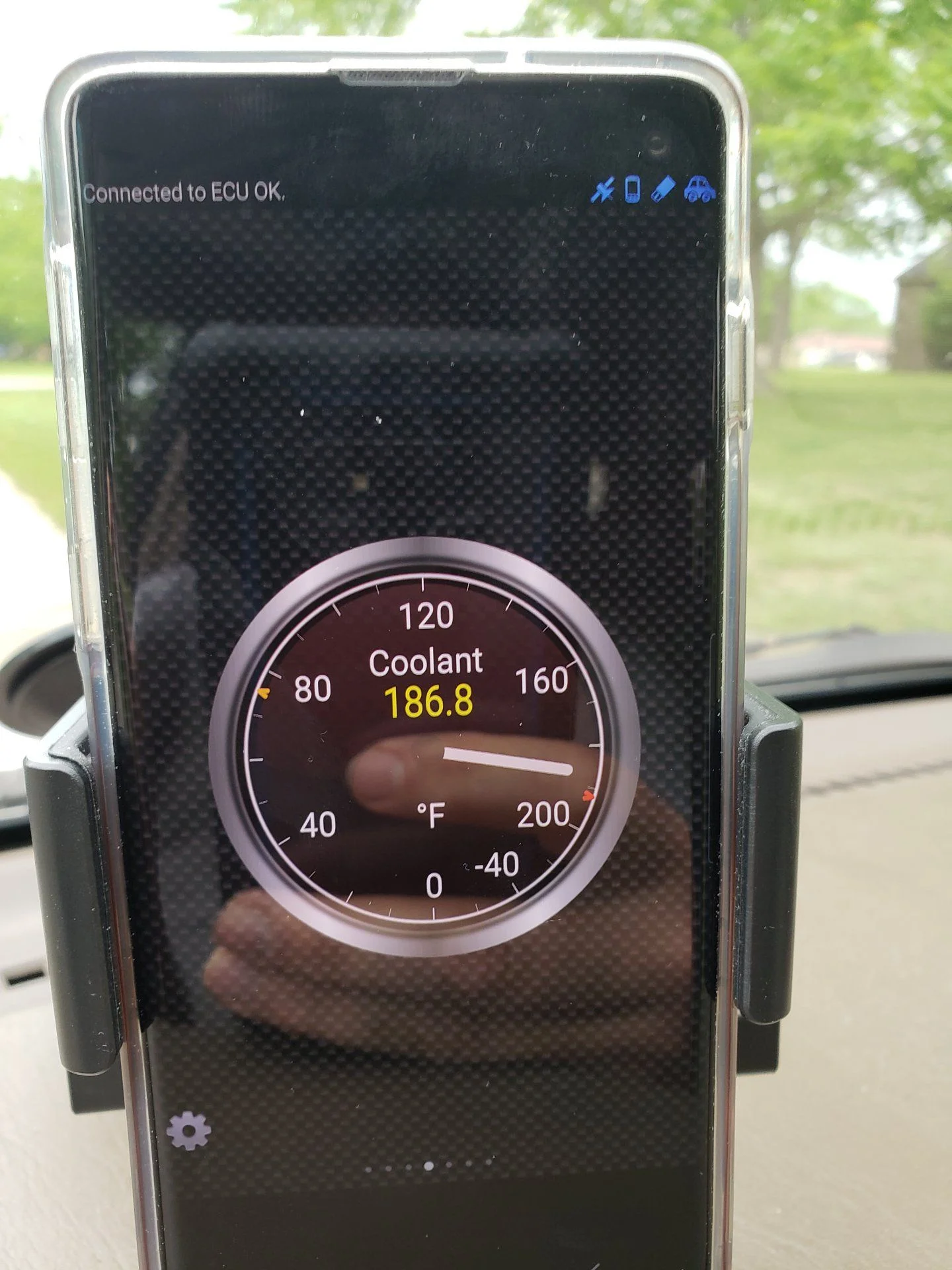

It's soooo nice to see the temp stay at 188. It might climb up to 190 or 192 going uphill and quickly coming back to 188.
What temps were you seeing prior to the CSF rad being installed? What else, if anything, did you change when you changed the radiator?
I've been having some high temps issues for quite some time. My truck was running at around 205.
Only replaced radiator and the coolant (not all of it, just what it came out during rad replacement. About 2 gallons)
I had replaced the rad cap and thermostat about a year and a half ago.
Wow. That is an impressive drop in temps by just swapping the radiator.

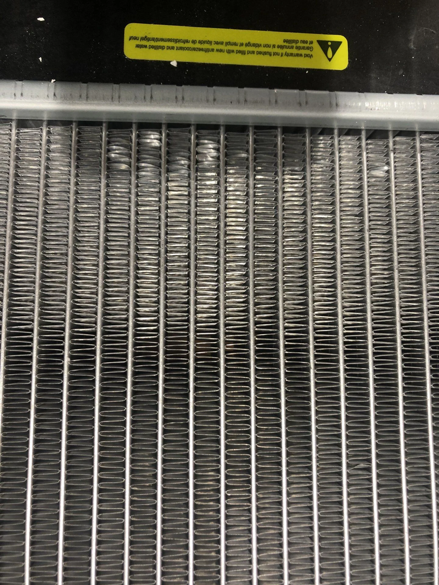

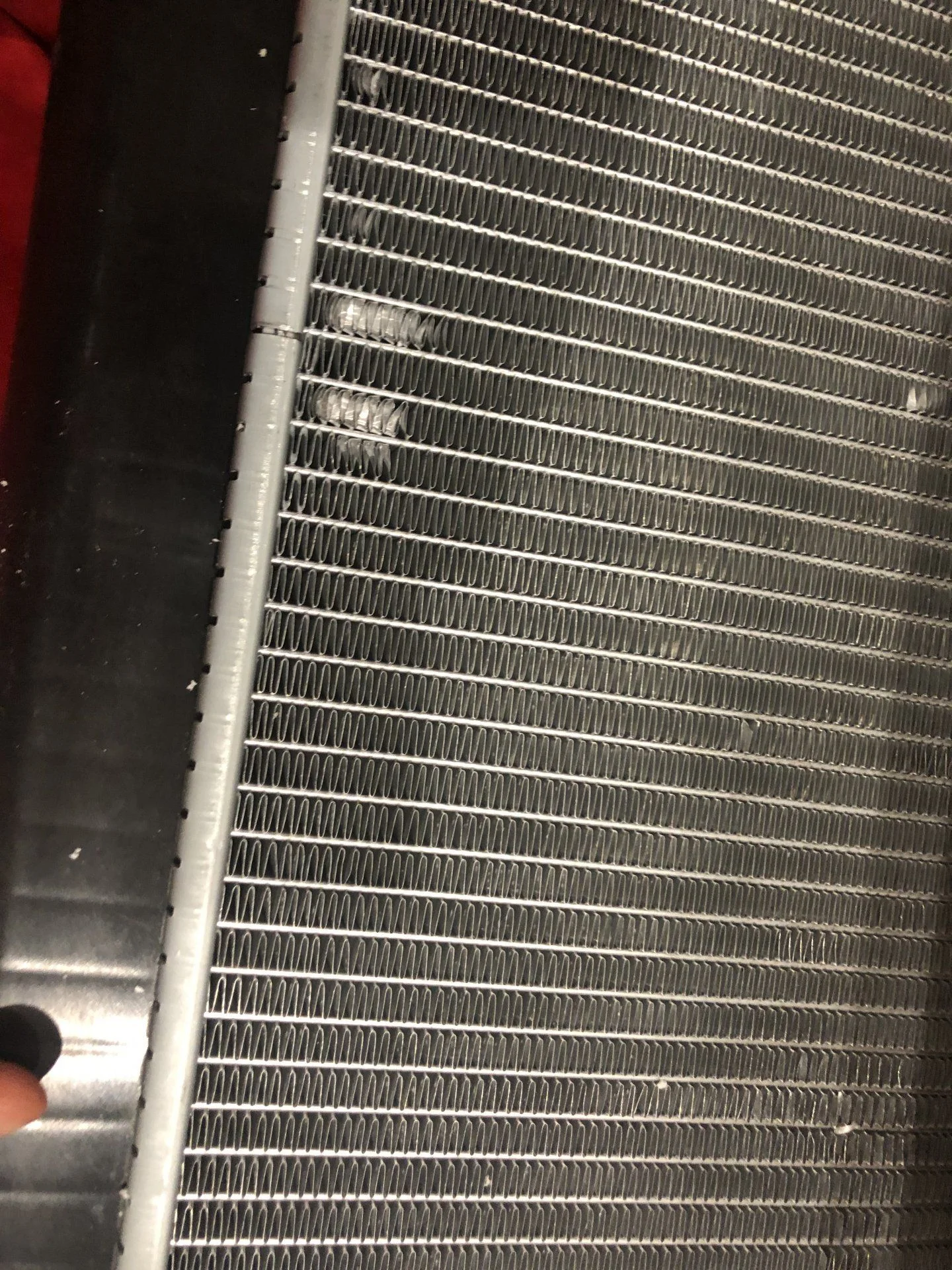

I bought a spectra radiator on Amazon and it arrived with a box side fully open. The styrofoam is in good shape so it appears the radiator didn’t fall out of the box.
However after pulling it out and inspecting, the fins look beat up in several spots. I’ve never bought a radiator before. Is this amount of bending normal for a new unit? Thanks in advance.
To me, no amount of damage is acceptable when buying new in the box items. You will however likely fold a few fins during install. Those dont look problematic but no need to accept that, unless they discount the product enough to offset your level of dissatisfaction.
Fwiw- you can order the Spectra directly through PepBoys, at nearly same price as amazoom, get free shipping to a nearby store and go pick it up - which allows you to inspect on the spot for damage( if you have a PB near you). Also comes with limited lifetime warranty when you buy through PB.
