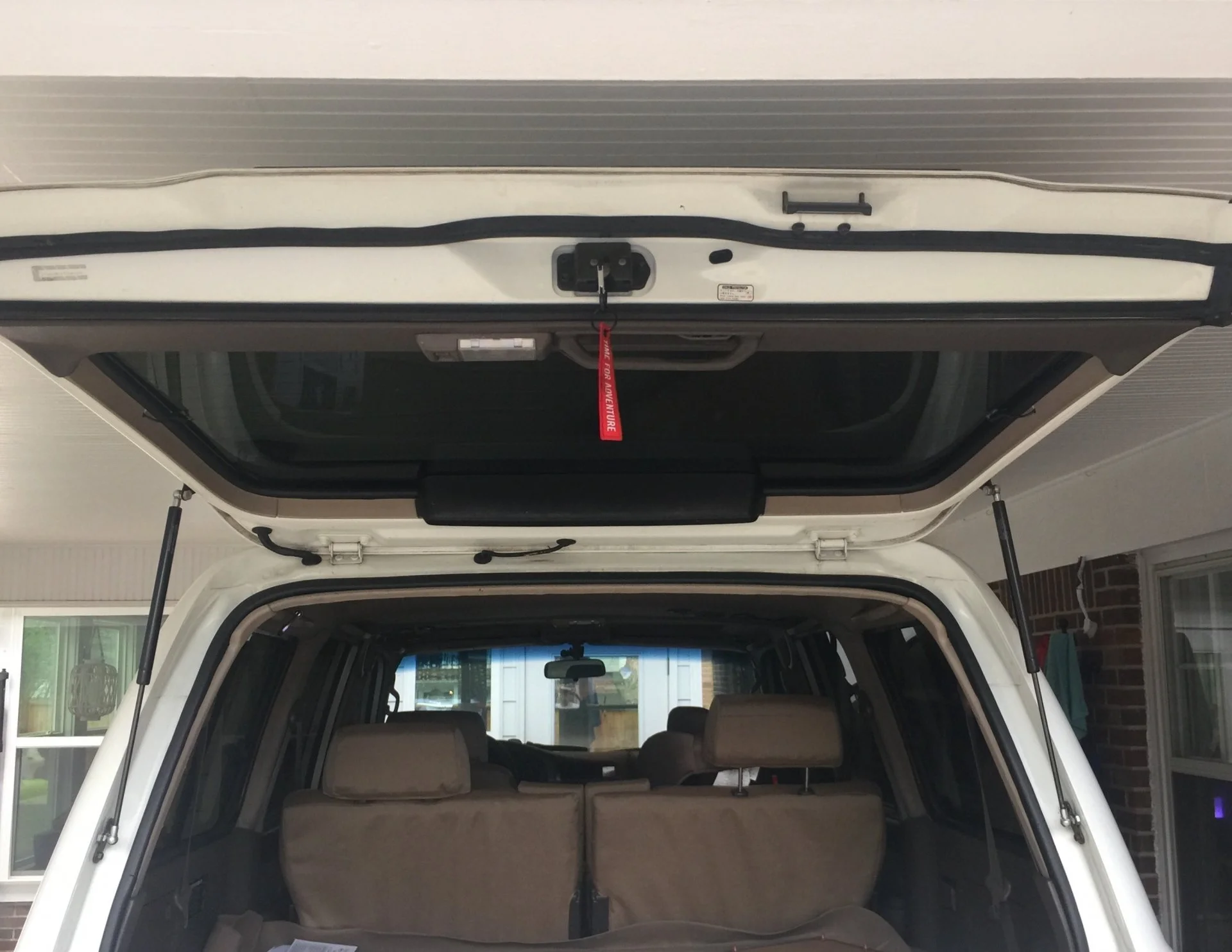

This may have already been mentioned but has saved my battery many times. A small carabiner can be stuck up into the rear hatch’s latch mechanism and it deactivates the overhead lights. Just finger the release lever and the carabiner drops right out. Extra points for adding something to the carabiner so you don’t forget to pull it before closing the hatch. Mods under $1.00 if you just get a carabiner.

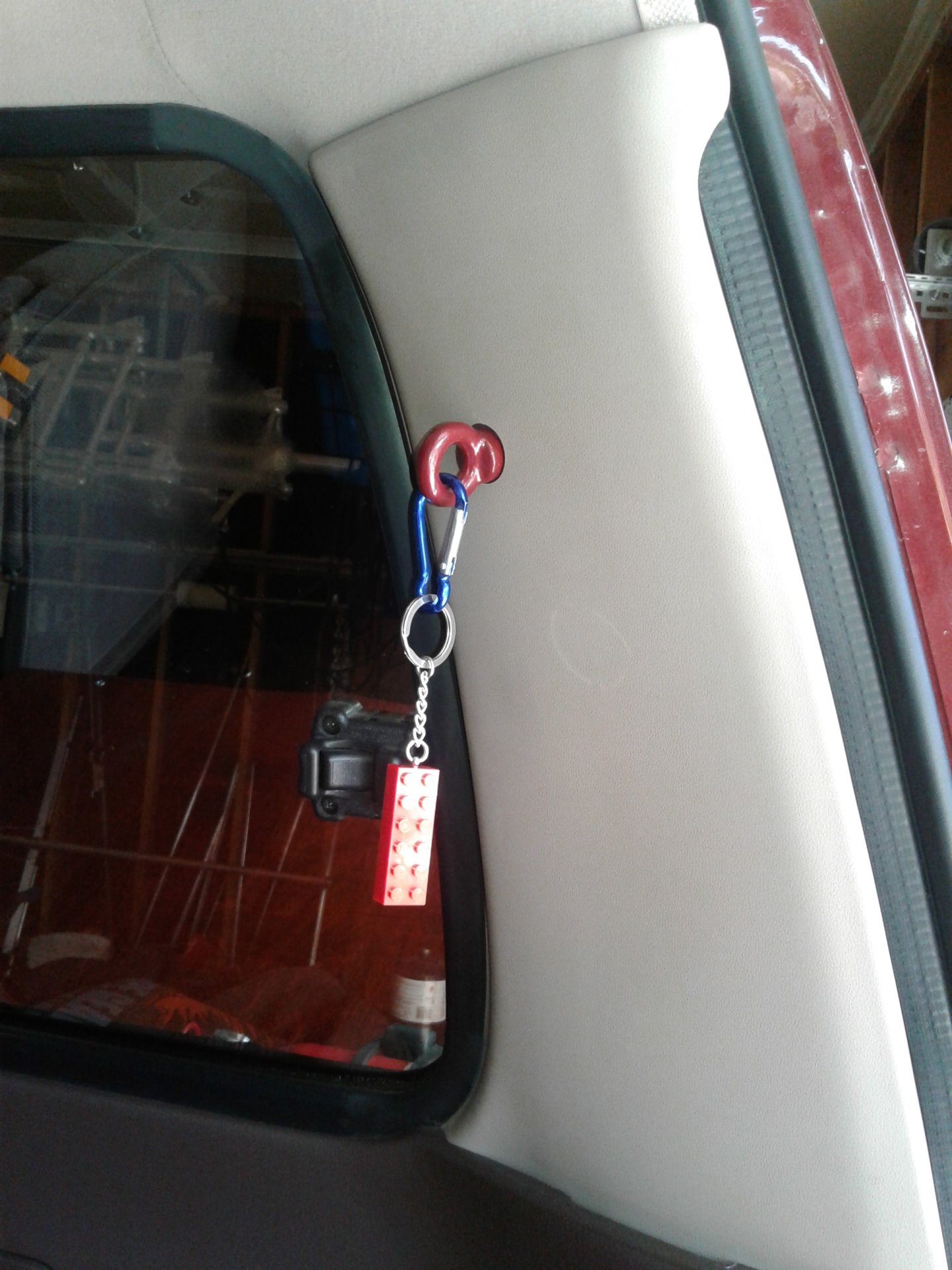

I'm not the sharpest tool in the shed but this is such an incredibly wonderful simple idea. So often I turned off the interior lights cuz I had the rear hatch open for a long time and didn't want the lights on. Eureka!
My carabiner dongle now hangs proudly from my 3rd row eyebolt.

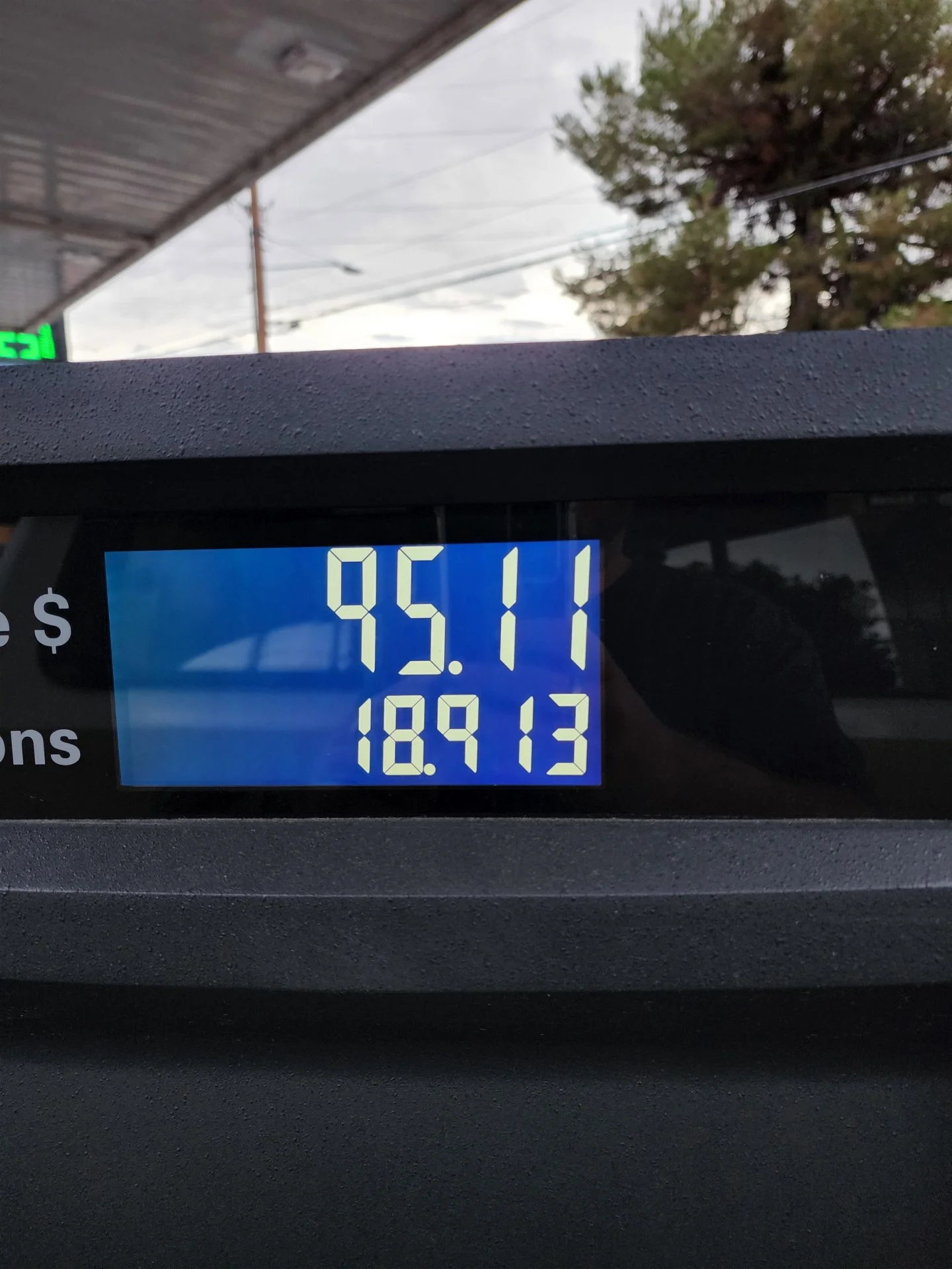

Does filling up count as a mod?
Yea. A weight reduction mod for your wallet.
And I am excited because this is the first full up under $100.00 this year.

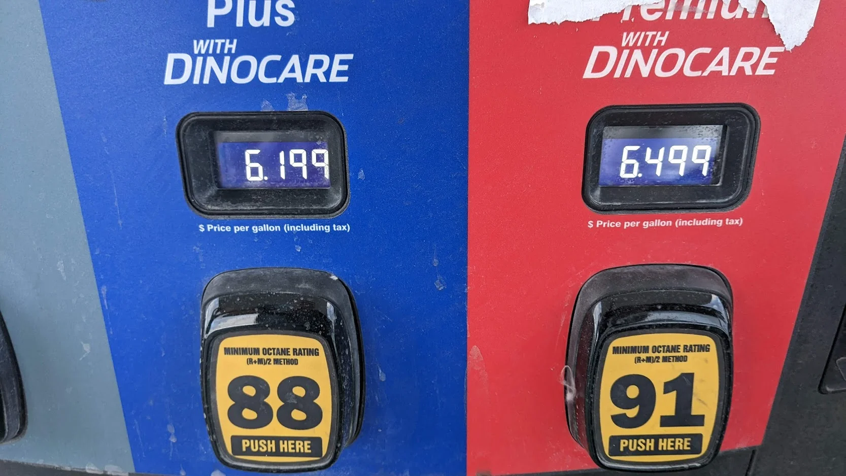

Given the current inflation rate, we are going to have to make this thread "Best Modifications for under $300" soon!
