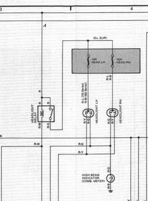

EDIT: This all gets confusing when you look at the wiring harness for the stock system. The whole ground switching thing always confuses me when I try to think through these circuits...because the wiring diagram makes it look like the dash light would always be on. Seems like the high beam indicator should have power to in from the bulb side and ground through the high beam wiring circuit. So when the High beams are switched on by the switch providing ground then the indicator bulb would also receive ground and light up. But the way the diagram looks now it seems like it should be lit as long as the headlights are turned on.

You were likely introducing a new ground with the 12v test light connected to the battery ground side and this confused the relay.
- if you added the Toyota harness with the new lights and you are running Halogen bulbs and the high beam indicator isn't coming on....then something isn't connected to the hi beam side of circuit properly to allow the indicator to pickup ground when it should (whether this is a user issue or harness issue no way of telling). The indicator bulb should be ground switched also so that when the high beams turn on the ground connects both the high beam circuit and provides ground to the indicator light
This is what I think is going on, based on past experience with a 60 and LED lights. The OEM lights are ground switched. I think these new lights are POS switched and this is done in the harness. I think this messes up the signal to the indicator light and throws 12V to the indicator circuit but it is working on the low beam circuit. When the grounded probe touches the indicator circuit it switches on the low beams but does not light the 12V bulb. Kind of like what a couple of you guys experienced with the indicator bulb not lighting.
I think that by replacing the standard bulb with an LED it carries enough current to light the bulb but not to complete the circuit to switch the low beams back on, or perhaps your low beams are coming on and you just did not notice it.
Either way, I probed the high beam relay and found the wire that lights up the probe when the high beams are turned on without lighting up the low beams too. I'll be using that one to light the light in the Speed Hut gauge.
Thoughts and opinions welcome for sure :)
LED's are a whole different animal because they are diodes. Diodes by nature only allow current to pass through them in one direction....where an incandescent bulb doesn't care if the wires that connect it to the battery are reversed or not. LED's need power at the intended power connection and ground at the intended ground connection. If these connections are reversed as in the ground switched toyota system then the lights wont work properly..or might sort of work but oddly. So the LED's need a conversion harness that switches the Toyota ground switched circuit back to a power switched circuit. And then you really should add a tertiary small relay to this conversion circuit to power the indicator light.

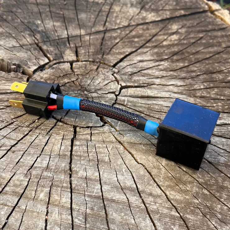

I too had the issue with the high beam indicator not coming on. Some folks swap in an LED bulb on the dash and it works - Great! - other folks do that and still get no magic blue indicator light. Others folks install the LED and the light comes on VERY dimly and that's it. Two 60s in a row that I've owned have no blue light, no matter what I do. I finally made a thing to fix that, you can find it HERE for $30. Just thought I'd broadcast this out to folks who may not have solved this problem yet.
It's not a load resistor
It draws less than half an amp of current
Generates no appreciable heat
Internally fused to protect your truck's wiring harness
30 second install
