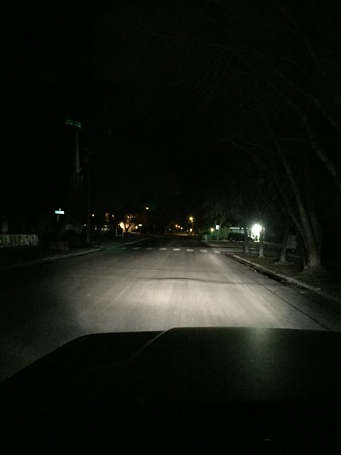

Finally was able to take a decent pic this morning on the way to work. Mind you this is at about 6am during down one of the local streets. Same street that I drive when I was blinded by the newer Silverado. I had no one around me so I was able to stop, take a couple quick pics and this was the best I got that didn't have a street lamp around me.
This is with my RAMPAGE lenses, SLCFJ62 harness and PIAA Intense White 60/55w H4 bulbs.
Untitled by Greg Fisicaro, on Flickr
