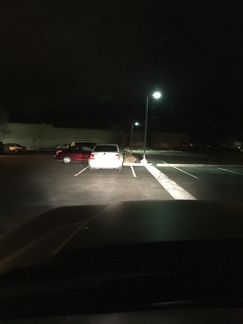

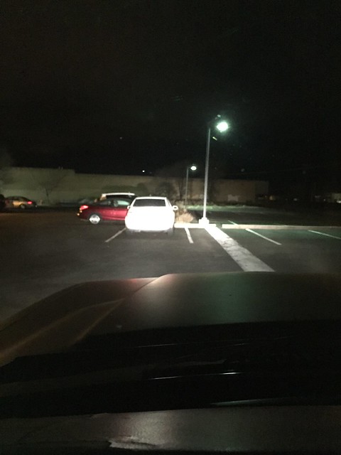

Here are some bad pics of my current setup...
RAMPAGE H4 housings from Amazon
PIAA Super Bright White 60/55w bulbs
SLCFJ62 Harness with direct line to battery
Here is the low beam
Untitled by Greg Fisicaro, on Flickr
and high beam...
I will see about grabbing some better photos in my driveway tonight with my actual camera, maybe even head up to the local trails to take some better pics (less light pollution).

@Rockymtnreaper Holy sh** that is bright! is the second shot with brights on? if not I bet you piss people (on coming traffic) off all the time haha

That is without brights, but with a nice camera.. and from what my friends say is you don't want to drive in front of me.. but I never get flashed.. The brights are insane.. I really feel bad if I bright anyone. The heated version are awesome, I have the normal ones and live in Colorado, I have only had one issue with them in a blizzard but you just pull over when you get a chance to wipe them off.. Really as long as you arent right behind someone they dont get covered.
I will check the heated LED's thanks for the heads up, those pics make me think I need to move to LED's. Whoa.
