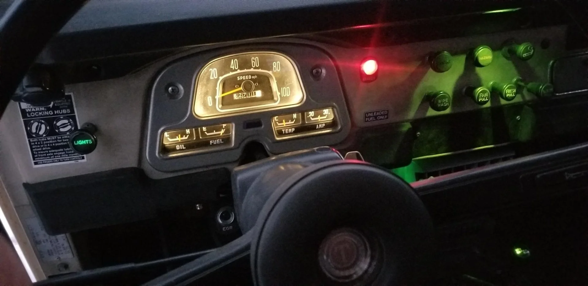

I did run into a problem today putting the 5-LED into my cluster. It was too tall to fit with the interior light shields in place. I am ordering a couple different ones instead. In the indicators and the high beam they looked great. I also have a 60 series tach in a 40 bezel that looked good with the LED. I used the 4k bulbs.
Trying this:
This was too tall:

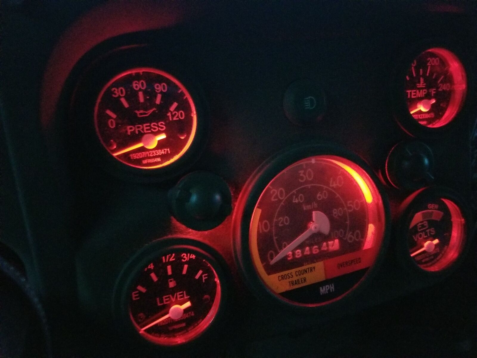

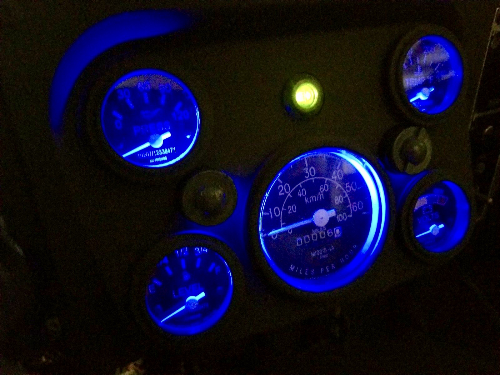

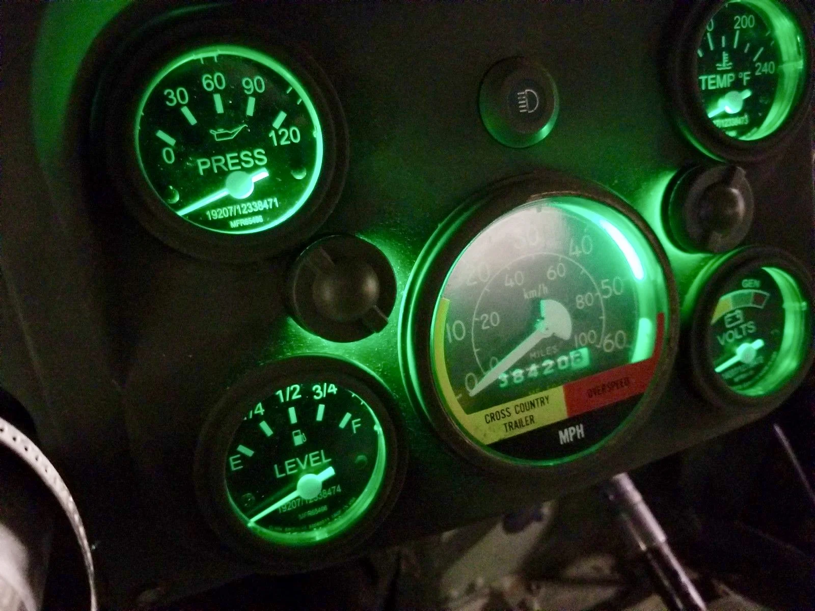

The military uses red and green bulbs for nighttime operations. Here are the LED’s on on a HMMWV dash.
Picture was taken on same dash 44 miles apart.
@Unimogguy , do the dash lights change color from red to green over time?
Actually they start off blue. Then transition to the later colors.
JK. Different bulbs for a different color option. These photos were taken from a aftermarket HHMWV manufacturer’s website who sells the LED dash light kits. I was just trying to show @samatulich other color options thinking that they probably had white LED installed. However I do have the green bulbs installed in mine.
