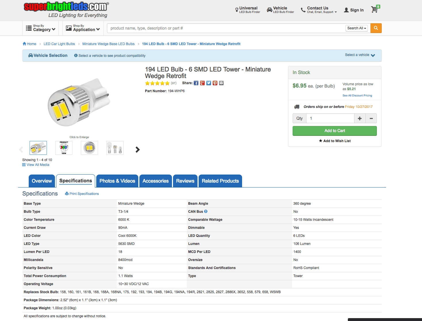

I ended up using these LED bulbs to illuminate the gauge cluster (it took a few tries to find the right fit/dimensions) https://www.superbrightleds.com/mor...ge-retrofit-car/1728/4112/#tab/Specifications
and it looks SO much better! (I forgot to take a before picture with the stock bulbs but just imagine a photo of a black square or close your eyes)
I replaced the high beam and turn signals as well with lower lumen (and cheaper) LEDs and the results were much less impressive, although improved from stock. These were the bulbs I used for turns/high beams: Ultra Bright 1 SMD (3 LED) Bulb 194 T-10 Wedge - Super Wide Angle

i replaced all the bulbs in the cluster however, the bulbs pictured were only used for the 2 white illuminating bulbs. i changed out the other bulbs (1 blue high beam, 2 for turn signal green arrows) with the cheaper, not as bright type. links provided in my previous post.
@NovemberNoLast ... Did the instrument bulbs fit OK without removing the shrouds? Also... do the blinkers work correctly?

I ended up using these LED bulbs to illuminate the gauge cluster (it took a few tries to find the right fit/dimensions) 194 LED Bulb - 6 SMD LED Tower - Miniature Wedge Base | Super Bright LEDsView attachment 1564704
