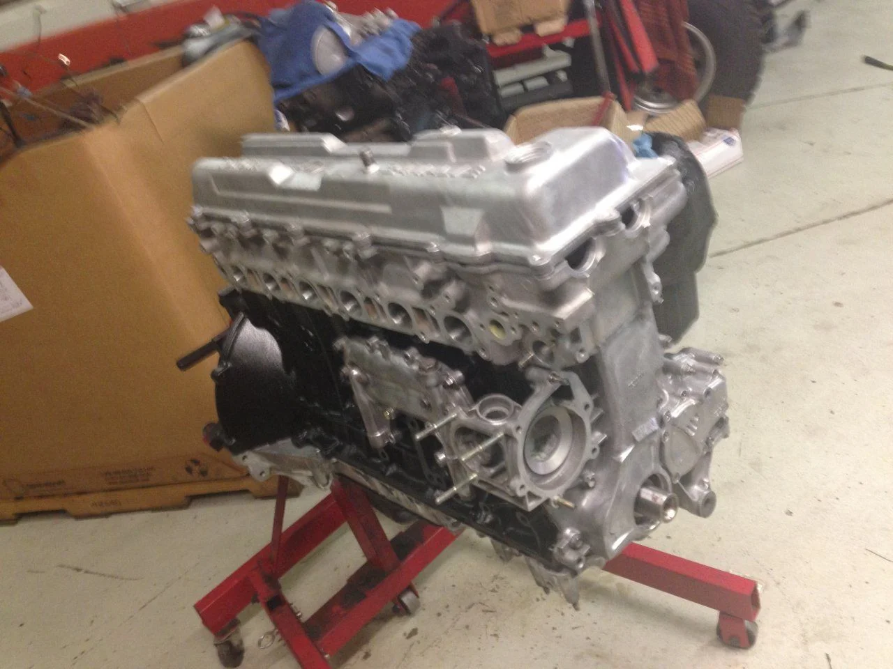

This is the info I’ve compiled from this thread and others and what I plan on doing with my 2F.
2F engine mods
Bored 1.5mm over
Late rods balanced with ARP studs
ARP PN 203-6004
Dynamic balance crank and flywheel
Mill head 1mm
SBC valves 1.5 exhaust 4.88, 1.84 intake 4.88
Compression ratio 9.05:1 calculated
68-69 intake or offenhauser c series ported to head
FI tech go street EFI
DUI HEI
Oil pump port and polish
Replace oil gallery plug in head
Timing plate torx screws 90149-10001
Cam:
Duration @ .016 262 deg
Intake opens 24 closes 59
Exhaust opens 62 closes 34
Cam rise .284 L/C 108 deg
Lash intake .014 exhaust .014
