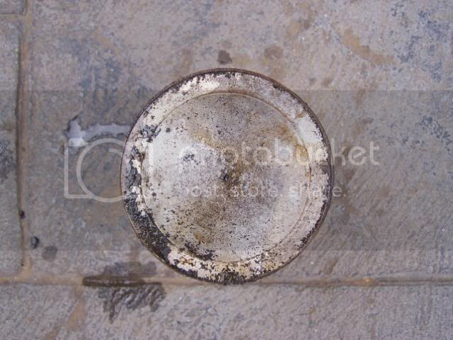

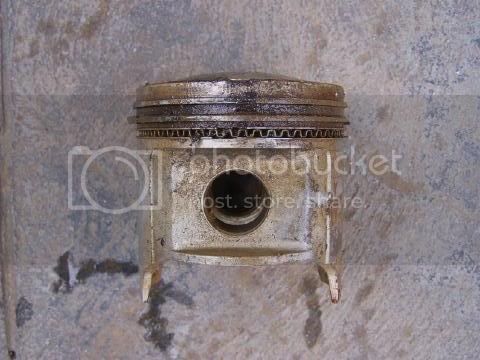

Does anyone have a good photo of a domed piston versus a flat top?
I read over several 2F builds but the only clear pics I found are of engines that should have flat tops (Trollholes and Andrew Farmers). Both engines have pistons with a slightly raised center that is circular.
I am rebuilding a 2F that came from a canadian spec '78 FJ45. It appears to me that it has a flat top/open chamber combination. The pistons look just like the ones mentioned above. The chambers are oval not kidney shaped. I will probably just mill the head to increase the CR.

Ask and you shall receive
Excellent thanks. Exactly what I was looking for. Mine are definitely flat top. I will have to do a fair bit of machining to make up the volume. I have a couple of F heads but don't feel like messing around with plumbing an oil line.

Mine are definately flat top - piston is completely flat.

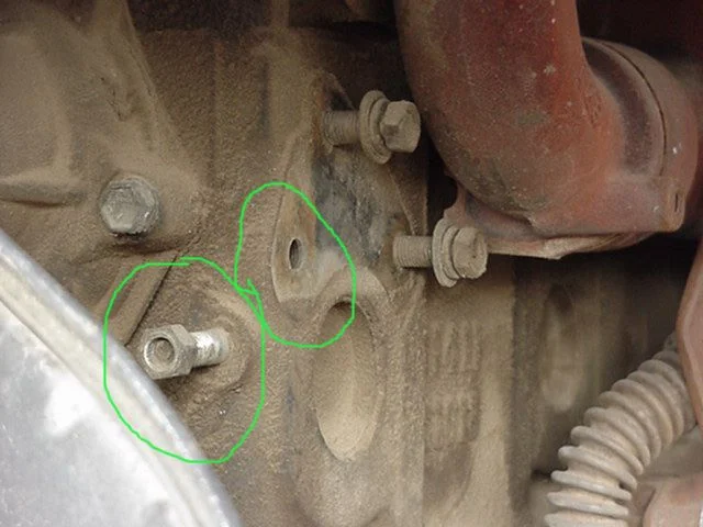

Earlier 2Fs (pre '81) do not have the drilled and tapped holes for mounting the PS pump. When Toyota added this feature, did they change that area of the casting at all, by adding material, bosses, flats, etc?
Would machining those holes into a '77 2F myself be possible/advisable? Assuming, of course, that I have the capabilities to do so. Admittedly a big assumption. ;)

Yes, they changed the area a bit (stolen from TJ's thread):
attachment.php
attachment.php
attachment.php
attachment.php
Drilling holes in cast iron, I've heard, is difficult without cracking it. I've heard it has been done for the exact reason of fitting a FJ60 power steering pump. There are tapped holes in the block from the factory, so I assume Toyota drilled and tapped the cast iron, so I'm sure it could be done. I don't know what's behind that location in the block though; if it's just solid cast iron all the way to the cylinder wall or what.
