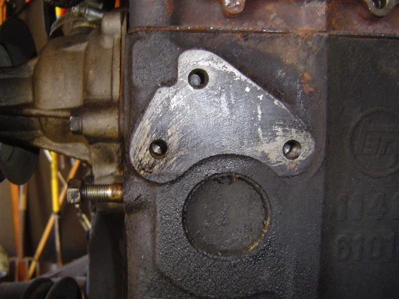

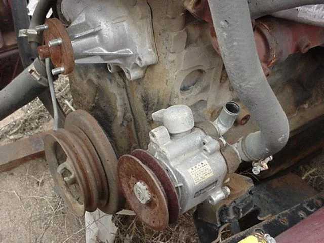

I do not know why anyone would even consider drilling and tapping the block for the OEM power steering bracket.
The mounting pad is not even the same shape:
attachment.php
Where are you going to put the stud that secures the bracket on the front side?

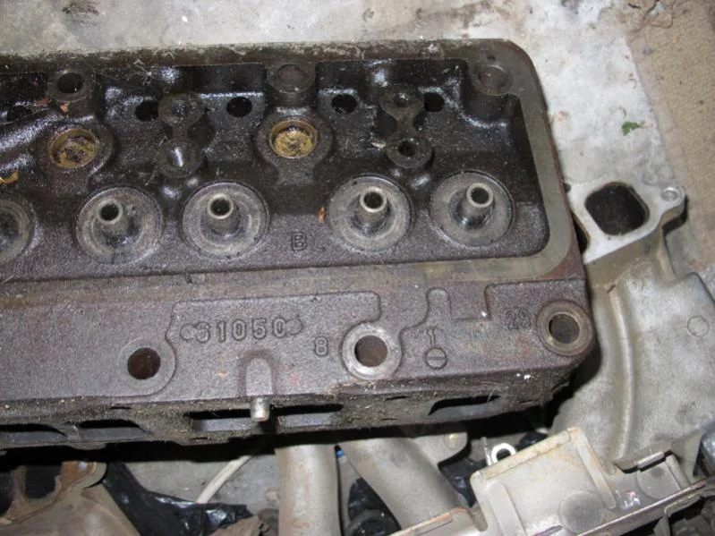

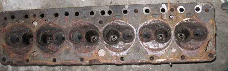

Is it possible to differentiate the +85 head from previous years?
The 3F cylinder head is 11101-61050.
Are you saying that the +85 61040 is the same as?

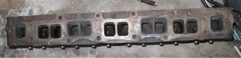

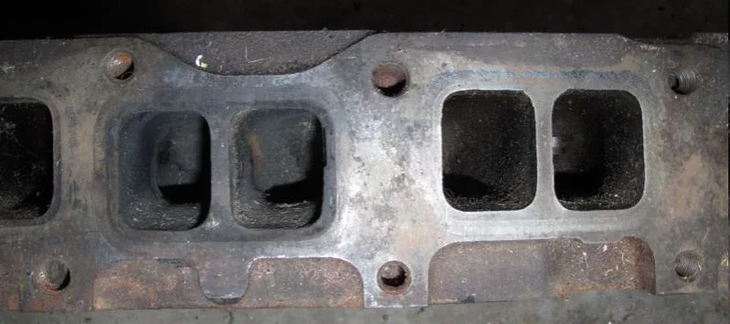

61050 is the later 3F head (88-newer). Note that it has extra meat above the intake to allow machining the injector reliefs for EFI which became available in 88. Date code is 8 1 29 or 1988 Jan. 29th.
The late2F/early3F head is differentiated from the older 2F head by having the additional fasteners and dowel pins for the 3F manifolds.
Part of the confusion surrounding, considering pics of both, but....
early3F head
the first I'd recognized the nomenclature "early 3F head", so clears it up.
