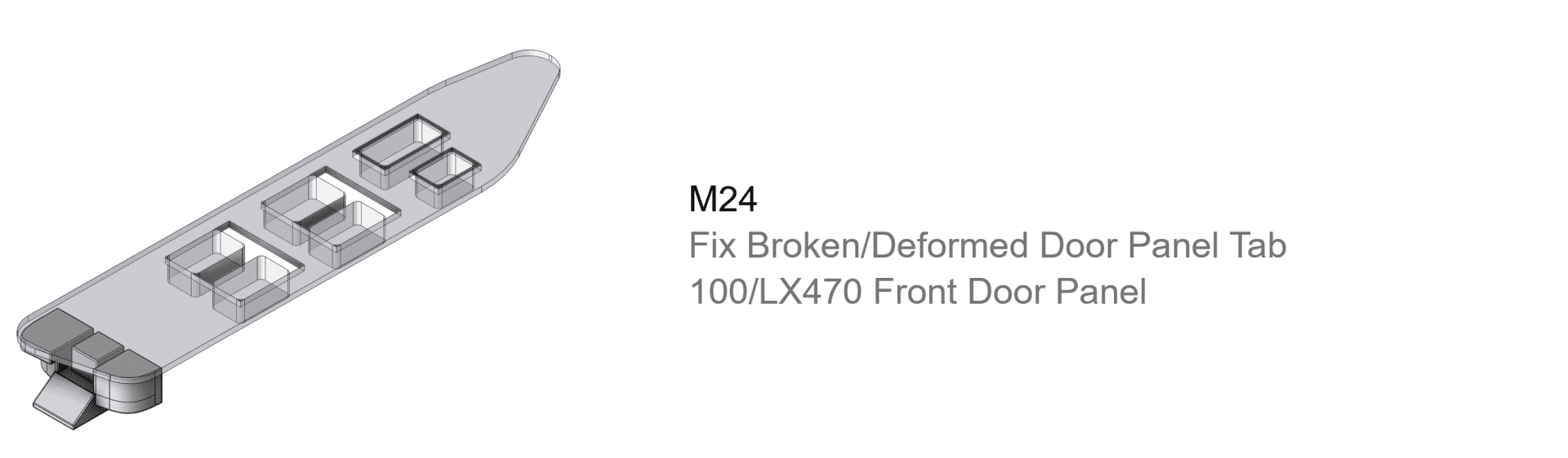

Make 24: EZFix of door switch panel

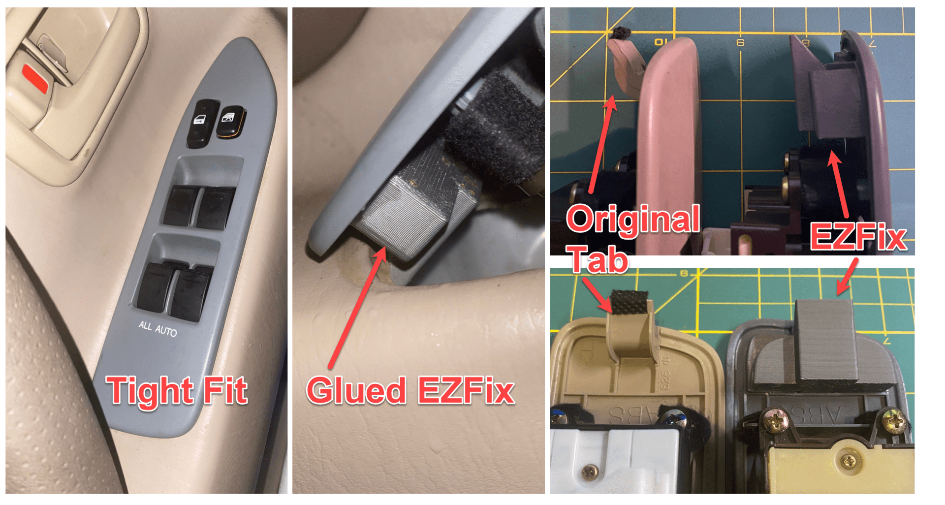

1 Overview of the Final Product

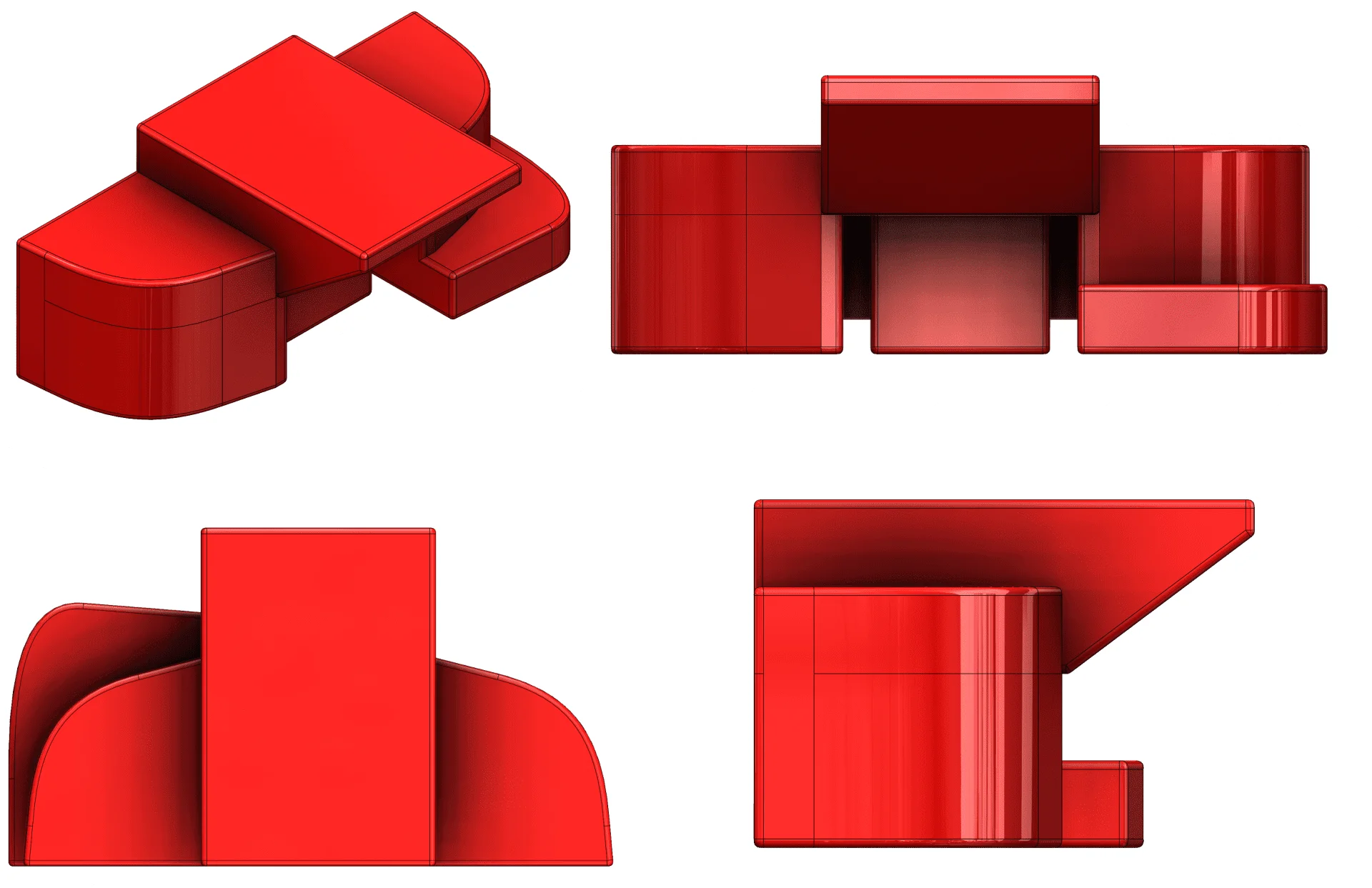

A lot of us have suffered from flimsy door panel caused by broken or deformed tab. The panel is getting harder to source and cost a fortune. The printed EZFix tab can be glued over the broken factory tab. EZFix has overall larger dimension and thicker material.
2. Glue I used:
Loctite Liquid Professional Super Glue 20-Gram Bottle (1365882)
3. Price:
$0 + Shipping ($7.5 to $8.5)
The CAD took me about 1-2 hours. Material cost is minimum. So I will just make it free.
Just PM leaving your shipping address.

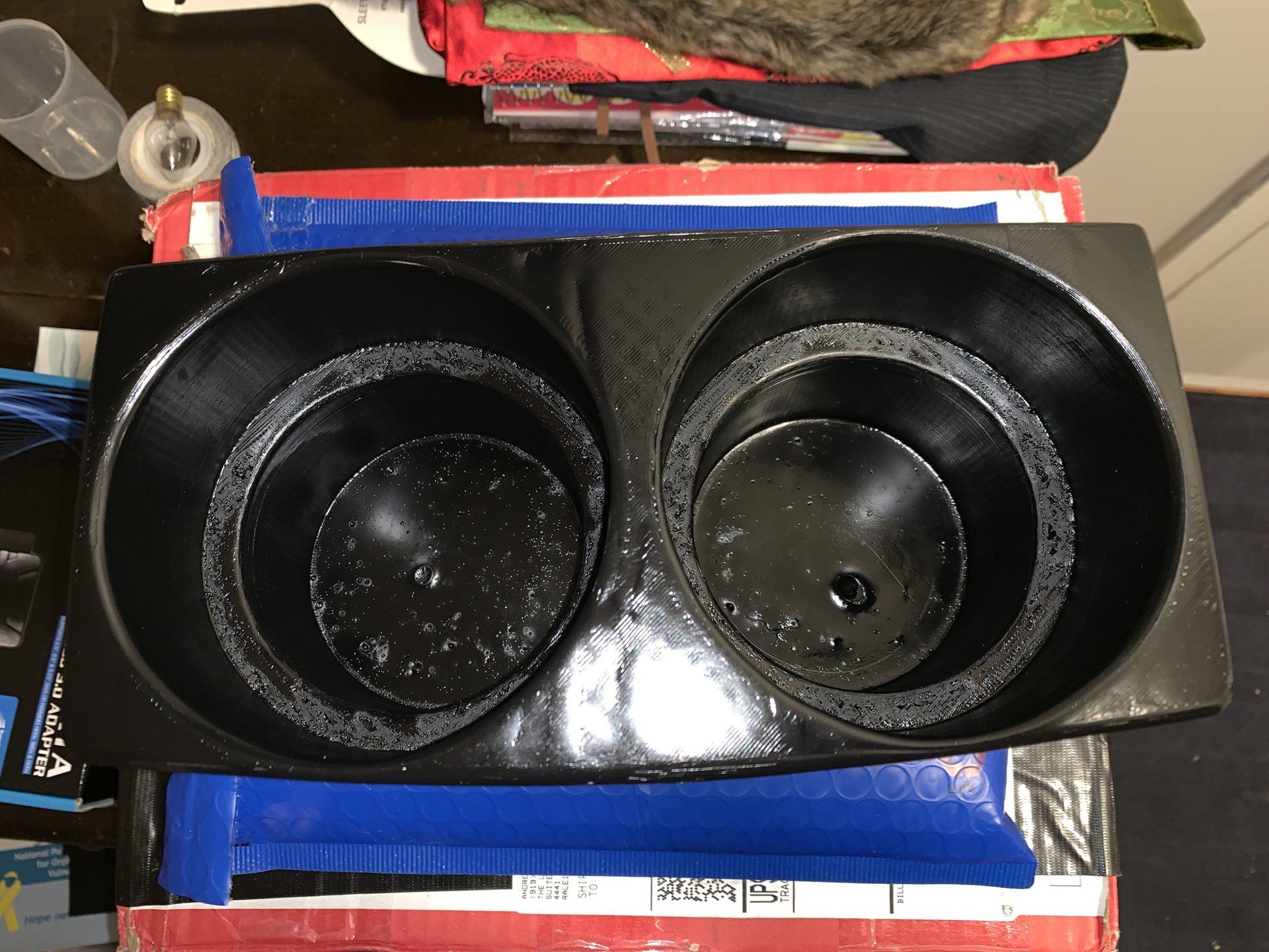

@BenCC - would it be possible to get a non-butterfly version with "2 steps", like the one I emailed you? Mine broke yesterday so definitely looking for a replacement. But I like the two different sizes.
What diameter for the inner step do you want?
Not sure. I can re-send the file to you. Something around the 2.75-3" range probably. Just something to old 12 oz cans a little better.

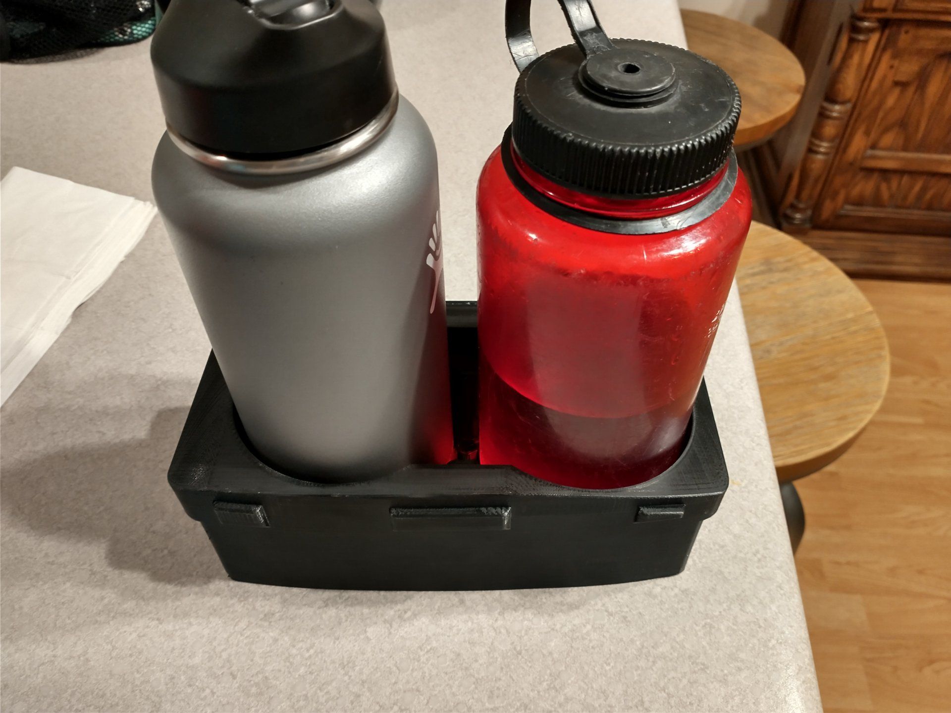

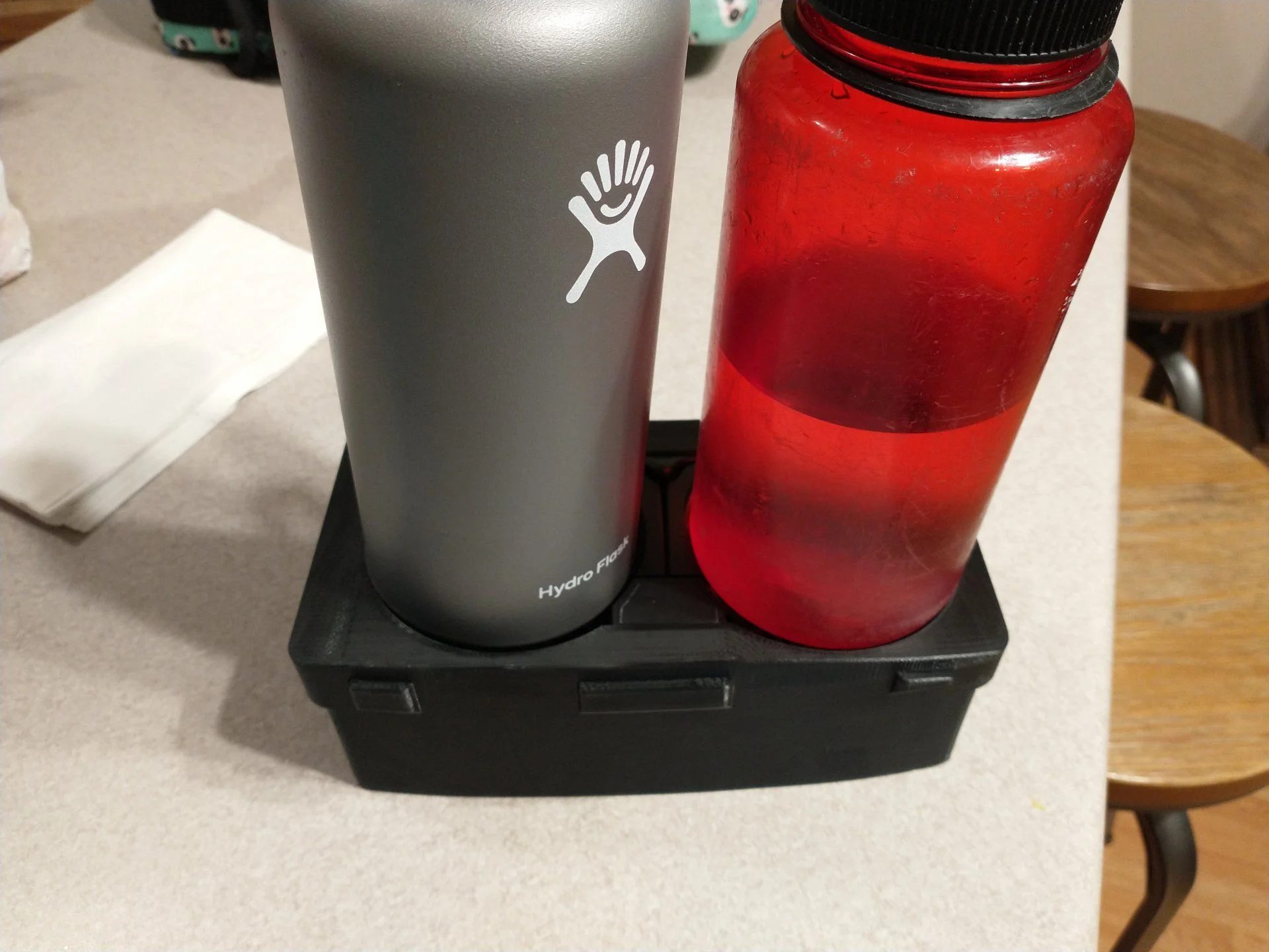

Can anyone confirm fitment of Nalgene/Hydro flask bottles with the 55633-60050 butterfly? I grabbed the butterfly out of my 100, and I can't fit big bottles with it installed.

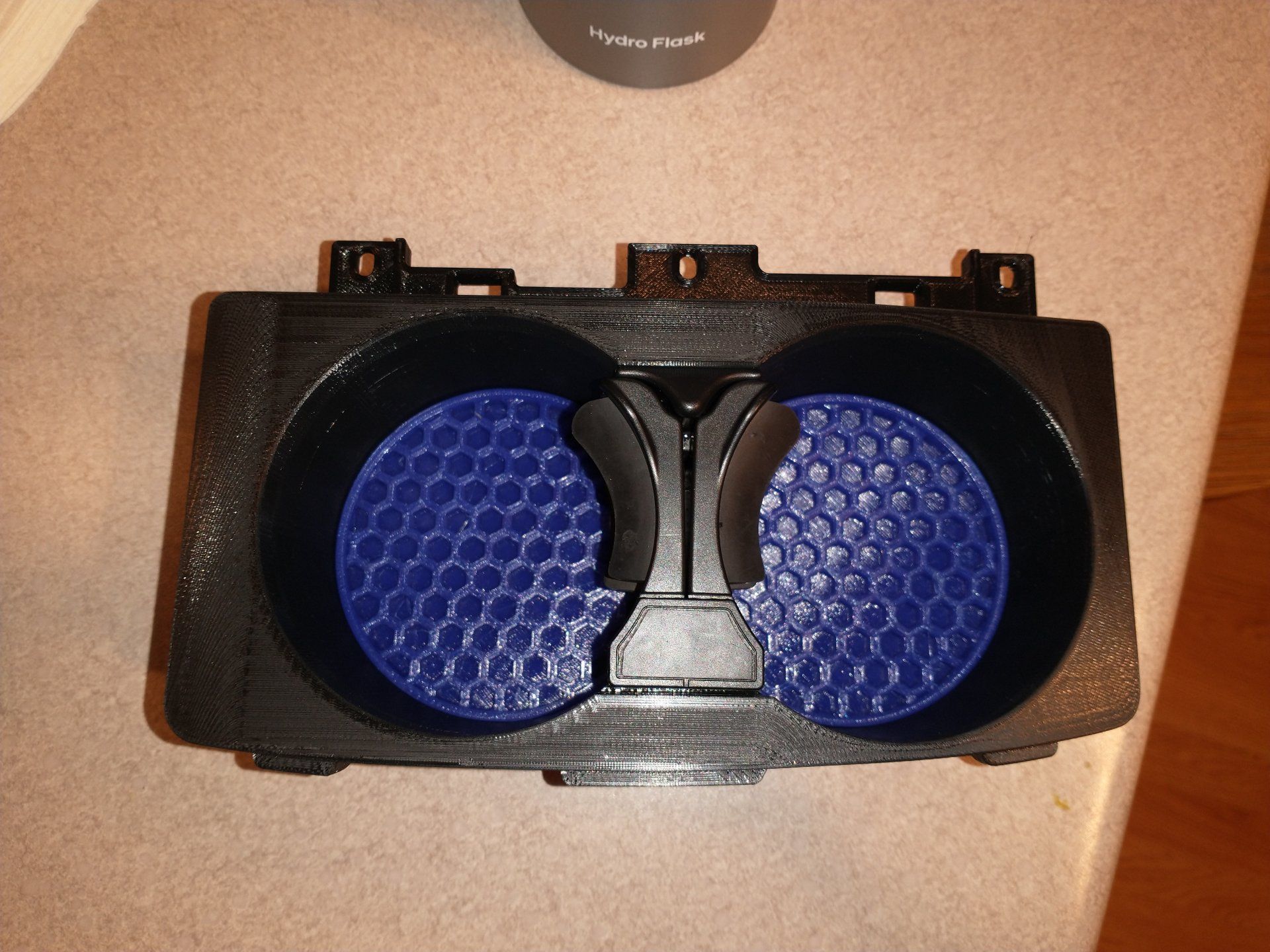

I can fit my big 36oz Yeti with the butterfly in the first rendition prototype but the butterfly has to be shifted over to the passenger side. This was purpose designed at the time. So you may only be able to fit ONE Large bottle in one side at a time..
Two large bottles without the butterfly
One large and one small with the butterfly shifted over
Two small with the butterfly
OK. That is disappointing, since I could fit one large/one small with the factory cupholder. This will still hold them more securely because of the depth though.
One though that won't matter to me since I already got mine....but are there bottles that require the 100mm diameter? I'm wondering if you downsized to 94mm or so, if that would give enough extra space to be able to fit the butterfly AND two large bottles? But maybe that would reduce the effectiveness of the butterfly, and I'm wishing for things that don't really matter. :p
