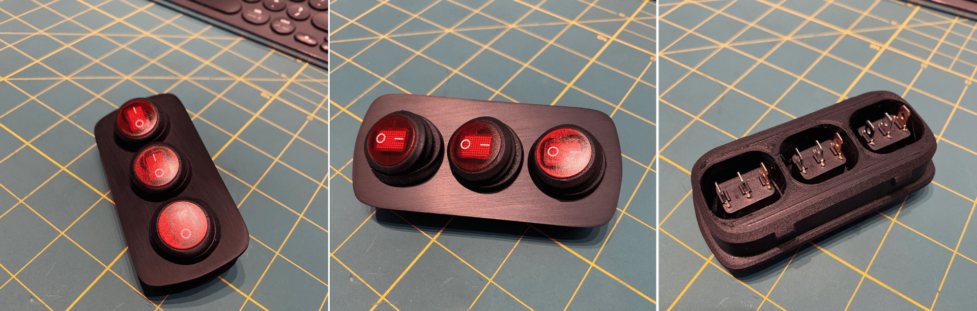

Here's a link Amazon product ASIN B07SC766HW

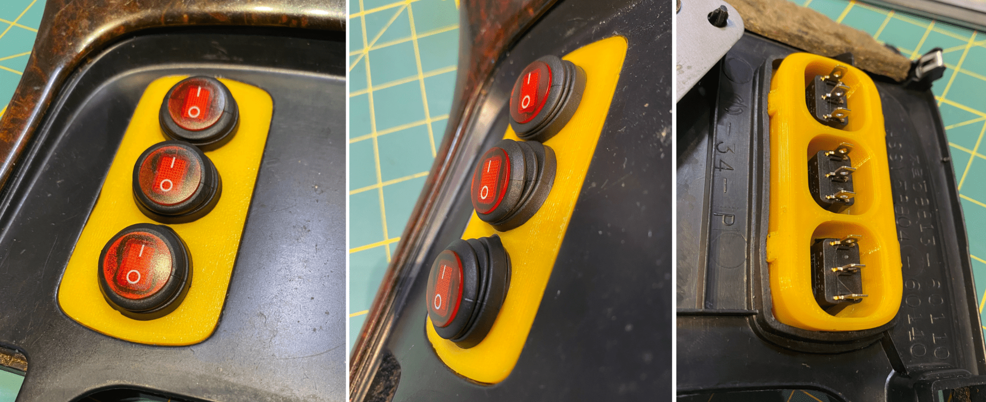

Their just the standard, basic SPST switches with a rubber boot that come with most wiring harnesses. 3/4in hole. I think we can get 3 in that space..
Like this?
Maybe getting ahead of myself here, bu, for the cup holder, I assume I'll need the butterfly. Does anyone have the part number?
Man that looks awesome! If only I didn't actually use that pocket...So far I've put those types of switches about an inch to the left along that very thin strip of console, but there really isn't much room to work with there.

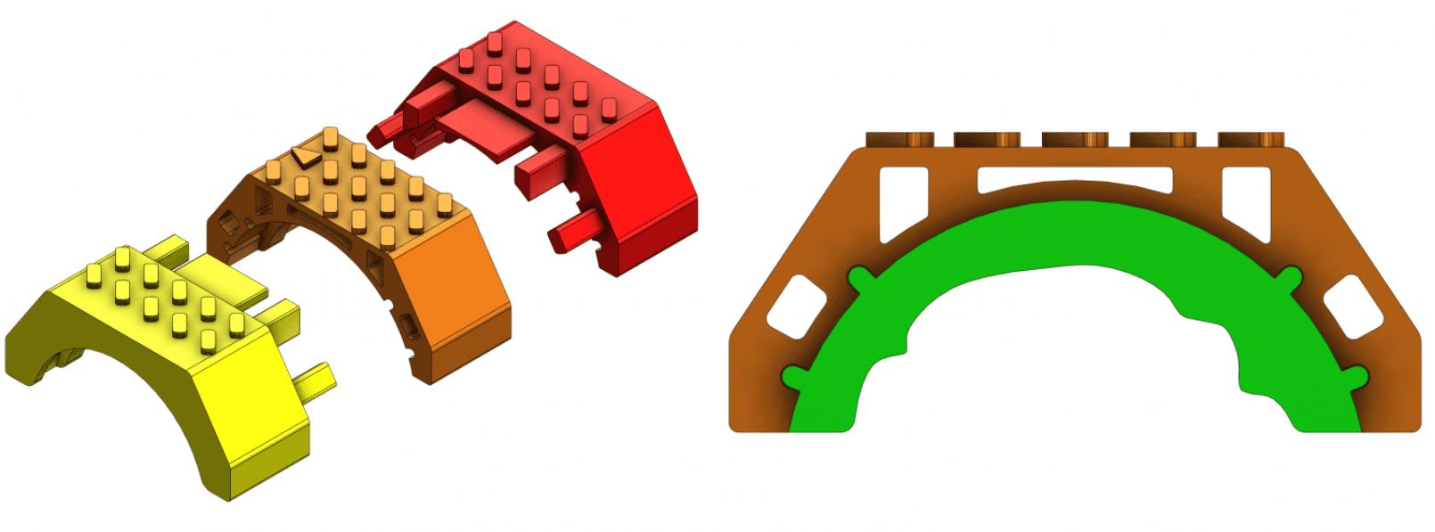

Make 25 Door Step
Requirement from @jlm43
"Maybe 6 inches long. It would act as a step to get onto the roof rack. The bottom should be some what soft and not slippery. The top can be hard but also no slippery. It’s something to protect the door trim and window seals when I don’t want to set up a ladder. And it would be a lot smaller and easy to store in the truck."
1. Overview
Photo credit @jlm43

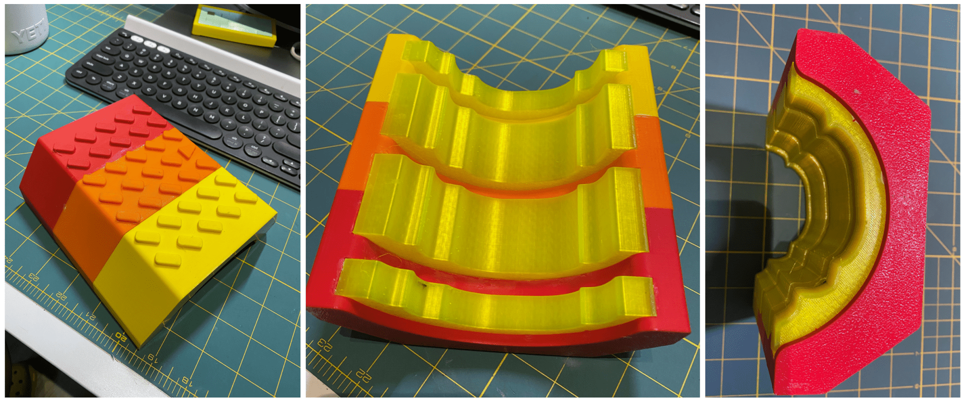

2. Material and fabrication
The liner(yellow) is printed with the same material used to make the facemask tensioners. The soft material is used to protect the door trim and paint. But it is not too soft so the white hard plastic part will not be in contact with door panel under load. The maninbody is printed with PETG.
The mainbody is glued from three parts. This makes the assembly much tougher than a single print. The liner is also glued to the inside of the mainbody.

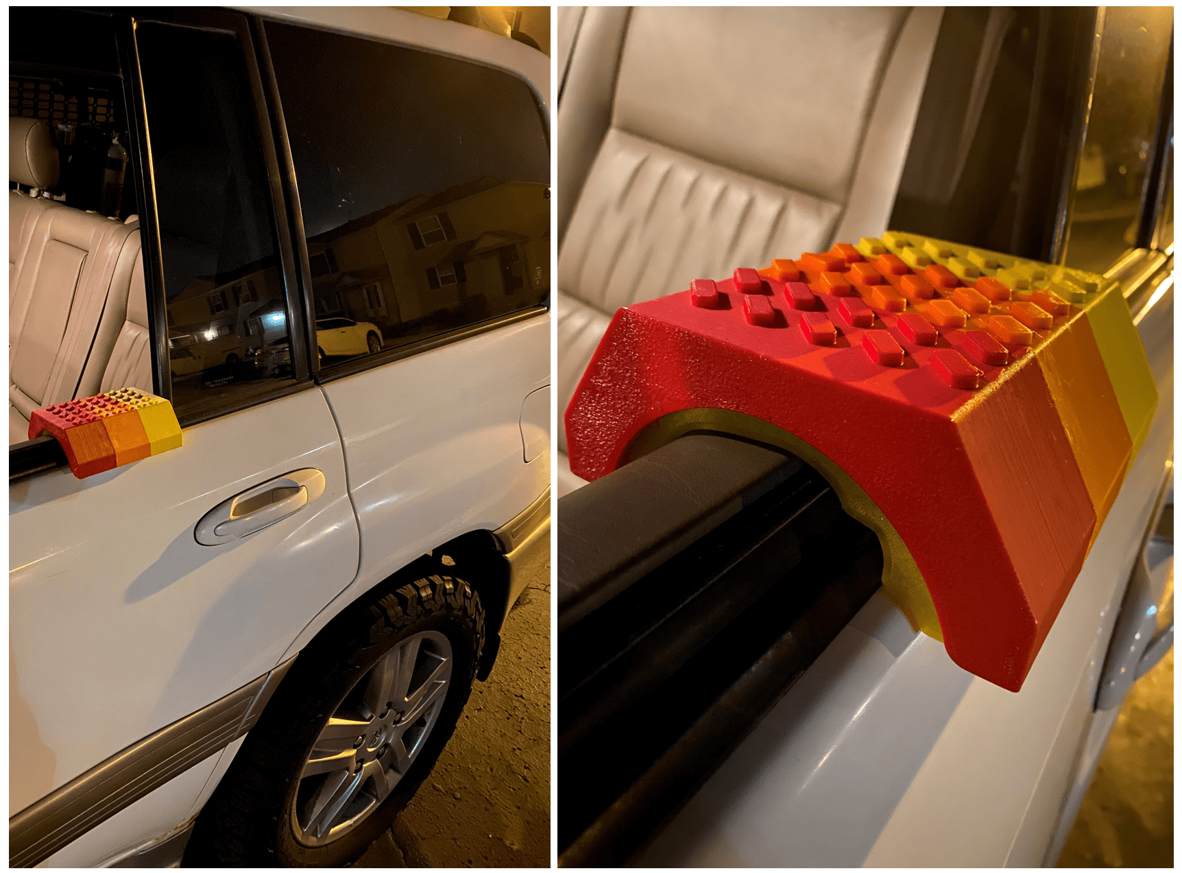

I guess I'm the one buyer. I would have thought that more would use something like this. Maybe that's why I'm not in sales...
It's been working great with zero complaints. I have a buddy that would like one for his 4Runner after seeing mine in use. I've been meaning to get some more "in use" pictures but I'm obviously lacking. I'll see what I can get over the weekend.
No worries. I am already very happy that it solved you problem.
