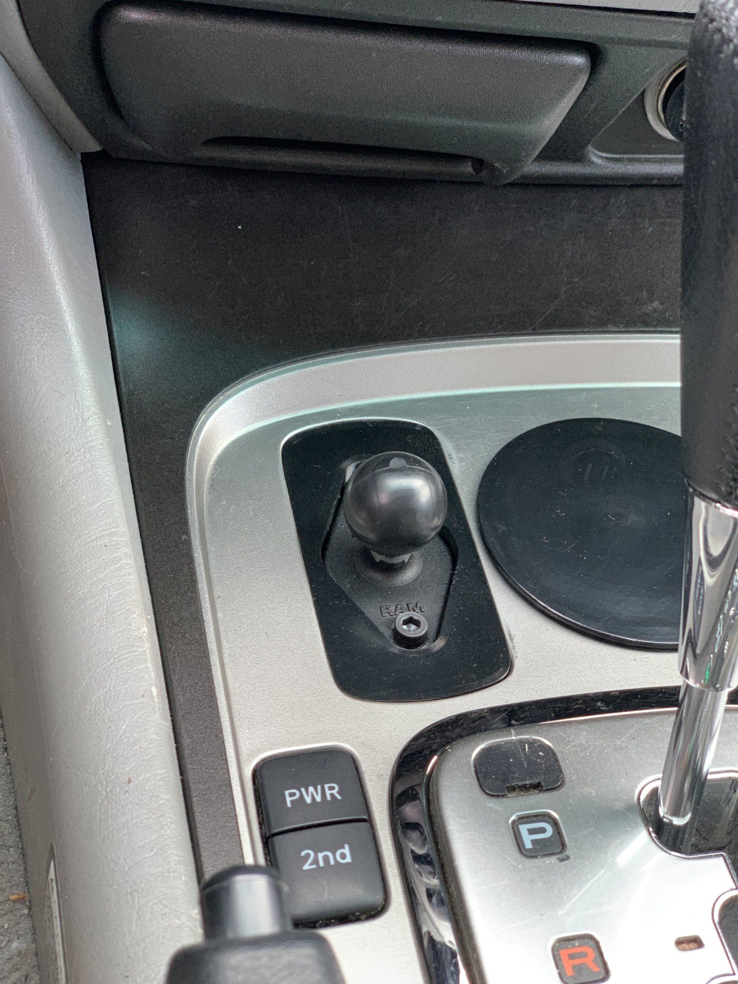

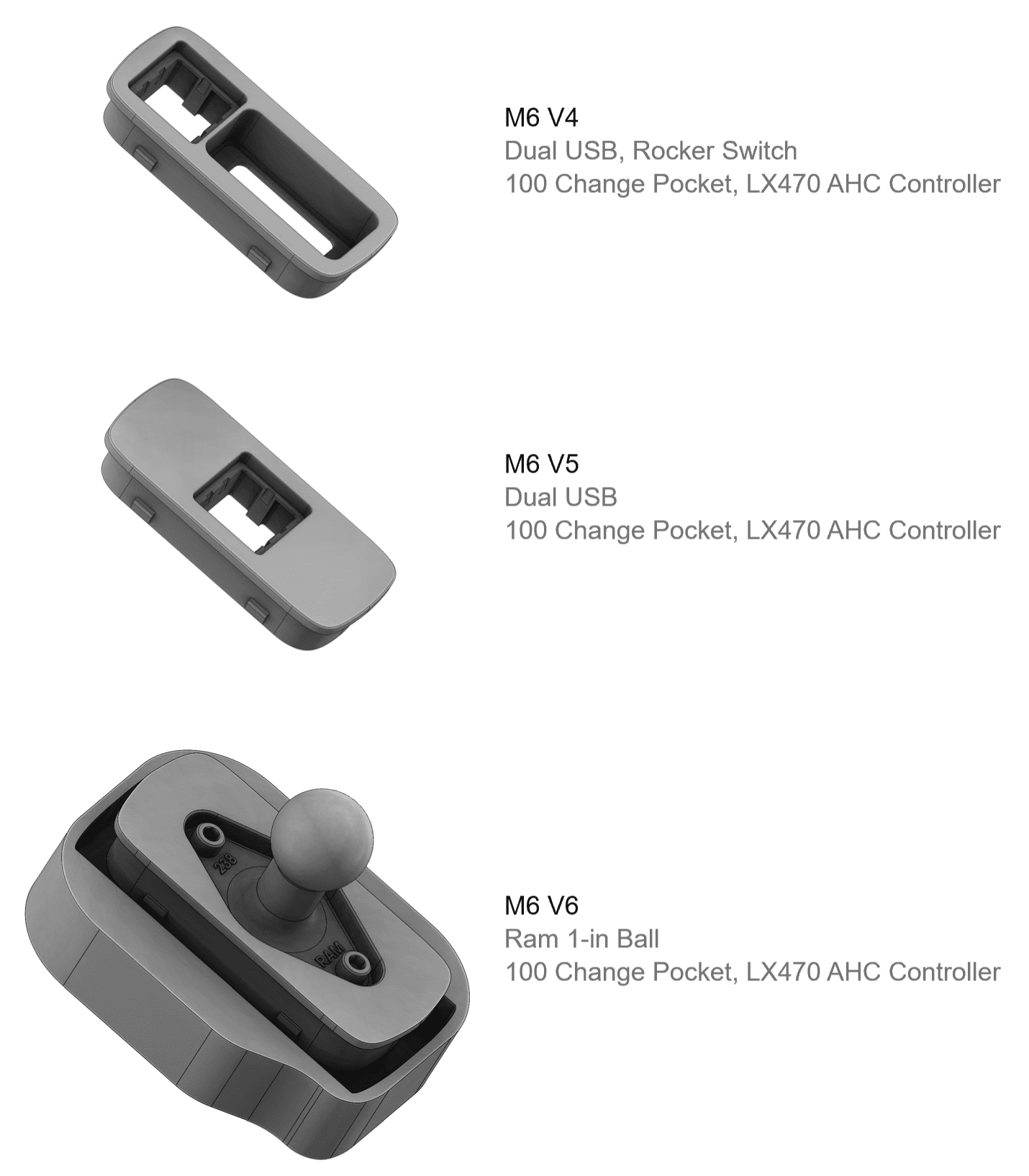

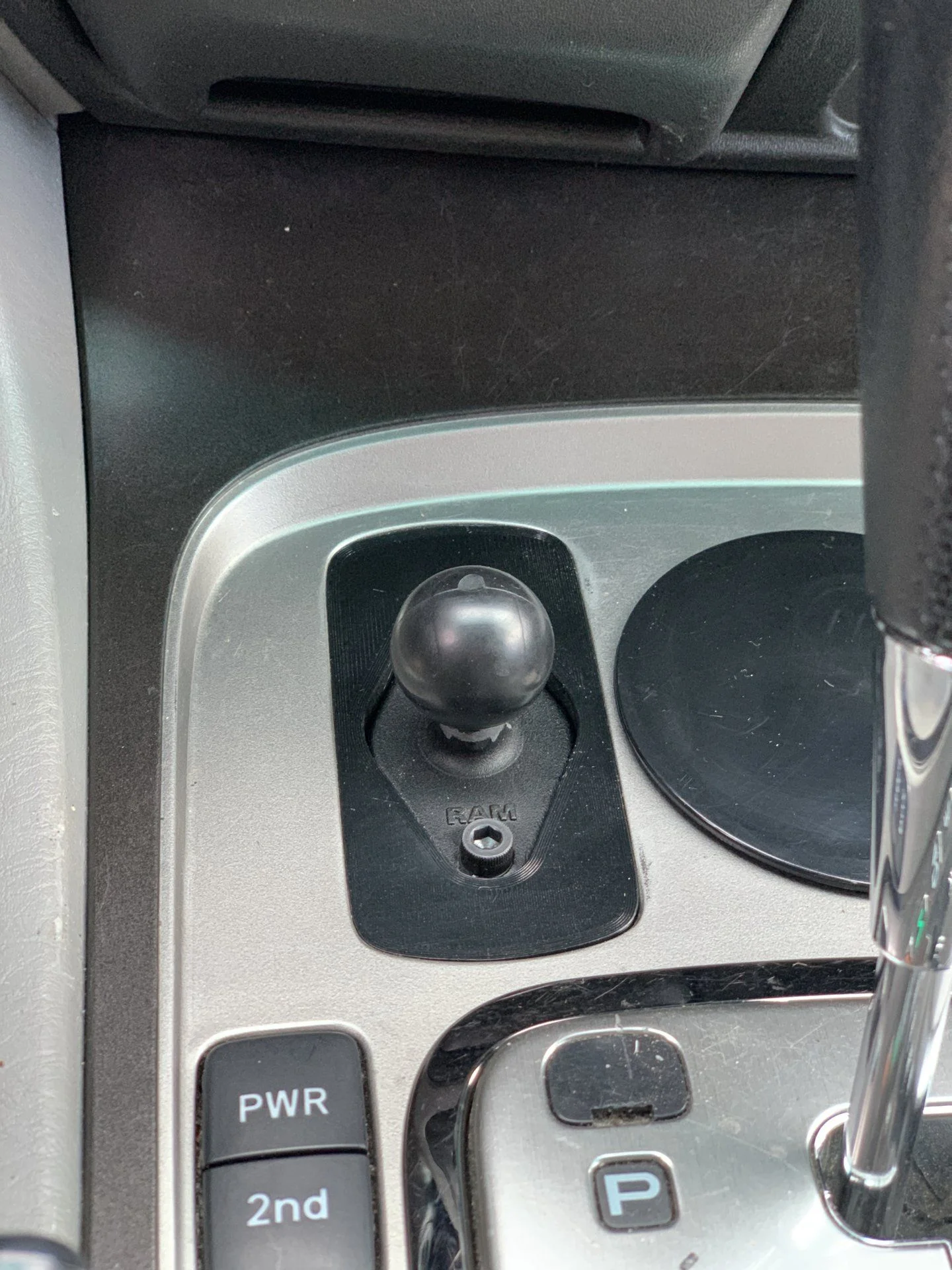

On the first page you have it pictured going in the LC change pocket/LX470 AHC controller. Is that where this recent one will go?
If this is the same one immediately above, it's a RAM ball mount specifically for the lower right center console panel (below the passenger air vent) on pre-face lift 100s. The dash changed in 04 I believe.

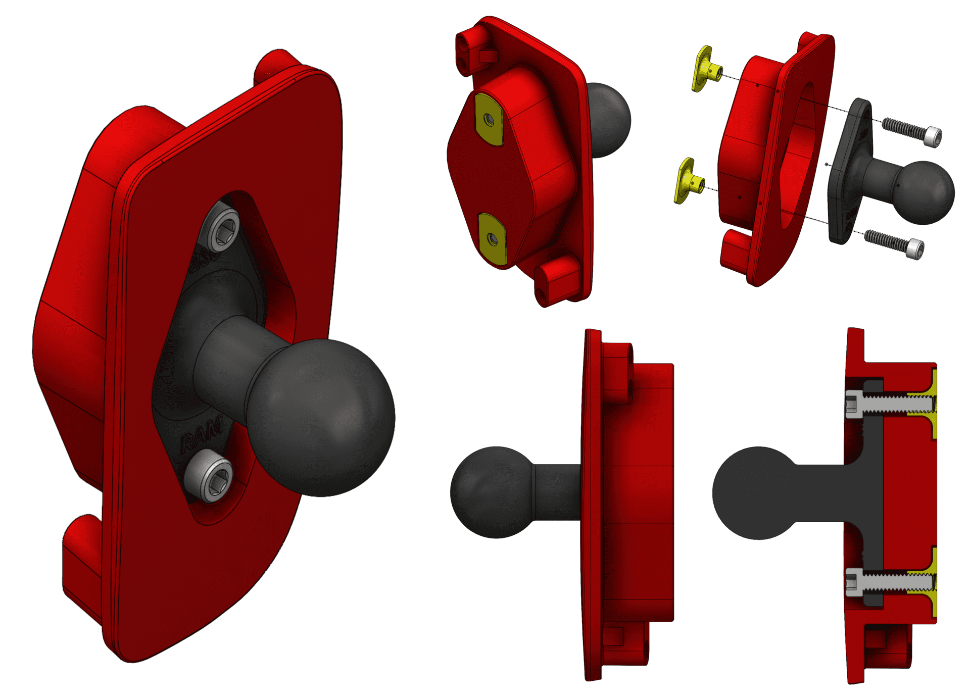

A test print and assembly of M2 Ram Ball mount. CAD was revised to clear the factory panel. Final version should be very close to this. Clearance was also tested by connecting a Ram double socket arm.
I am waiting for this one too.
How about this one as seen on the first page? Sorry if i missed it

This make is to mount a RAM Diamond Ball Base.
3. Design and Fabrication

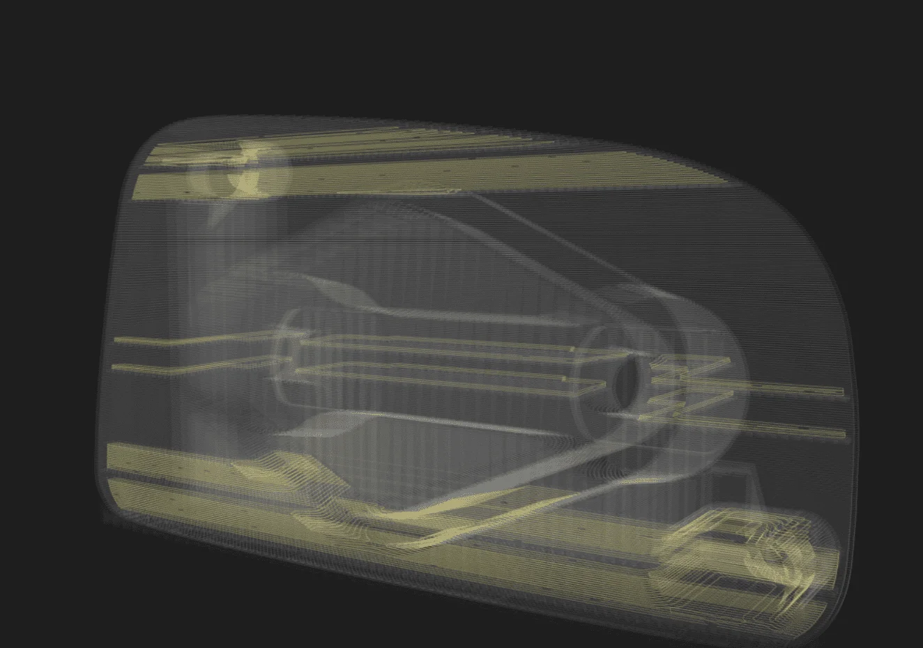

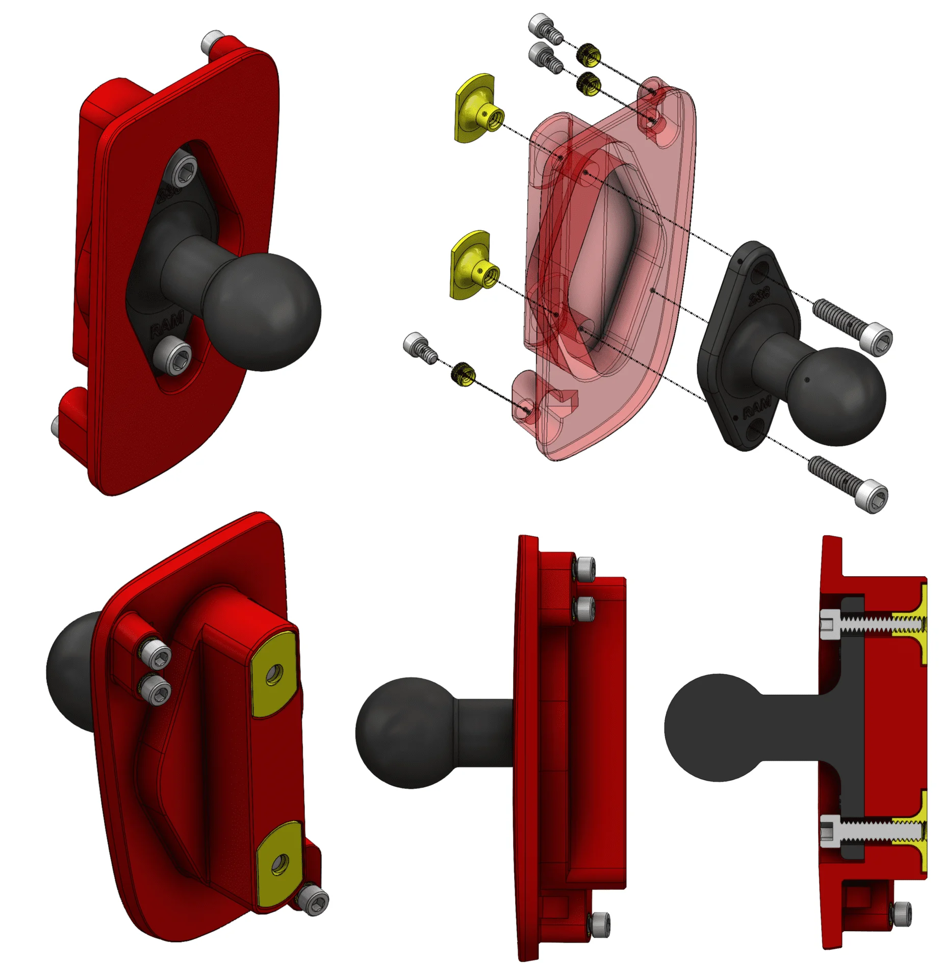

The design is revised from M2V1 to address the request on mounting a RAM ball on the blank panel. M2V1 is printed with resin since there is almost no stress on the part. But for mounting a phone, stiffness and toughness need to be considered. @suprarx7nut has the capability to print in carbon fiber nylon plus strategically placed continuous fiberglass. I did the design and prototyping. suprax7nut will do the production. The following figure shows the part with reinforcement fibers.

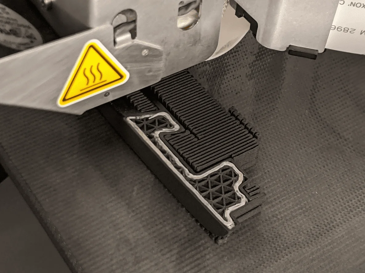

First test print on the YotaMD printer underway and laying down some fiber!

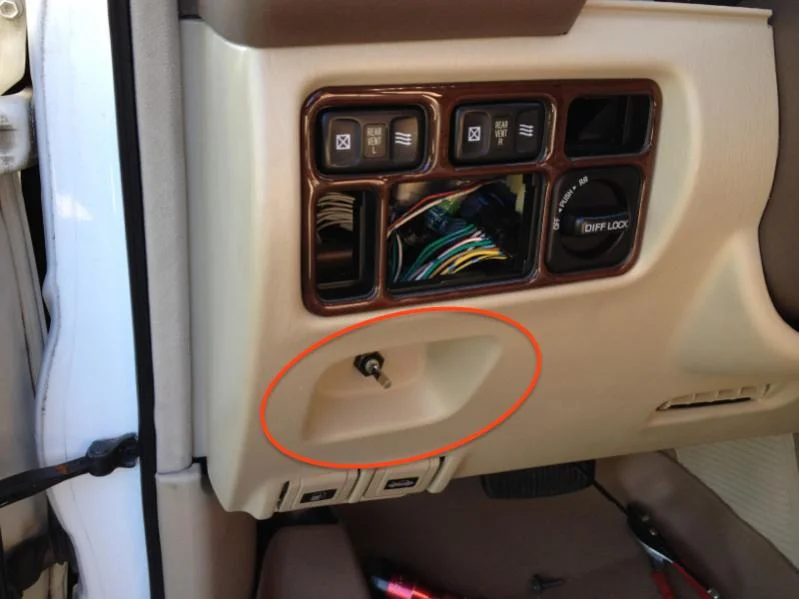

Ben, here's another idea... folks want the OEM hand throttle and they want it recessed so they don't bump their knee into it. The OEM panel is not compatible with our NA 100's. How about a flush mounted insert that we can install into a cut-out of our existing panel?

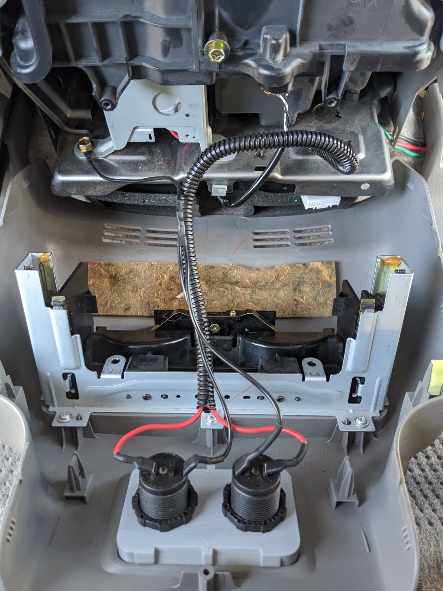

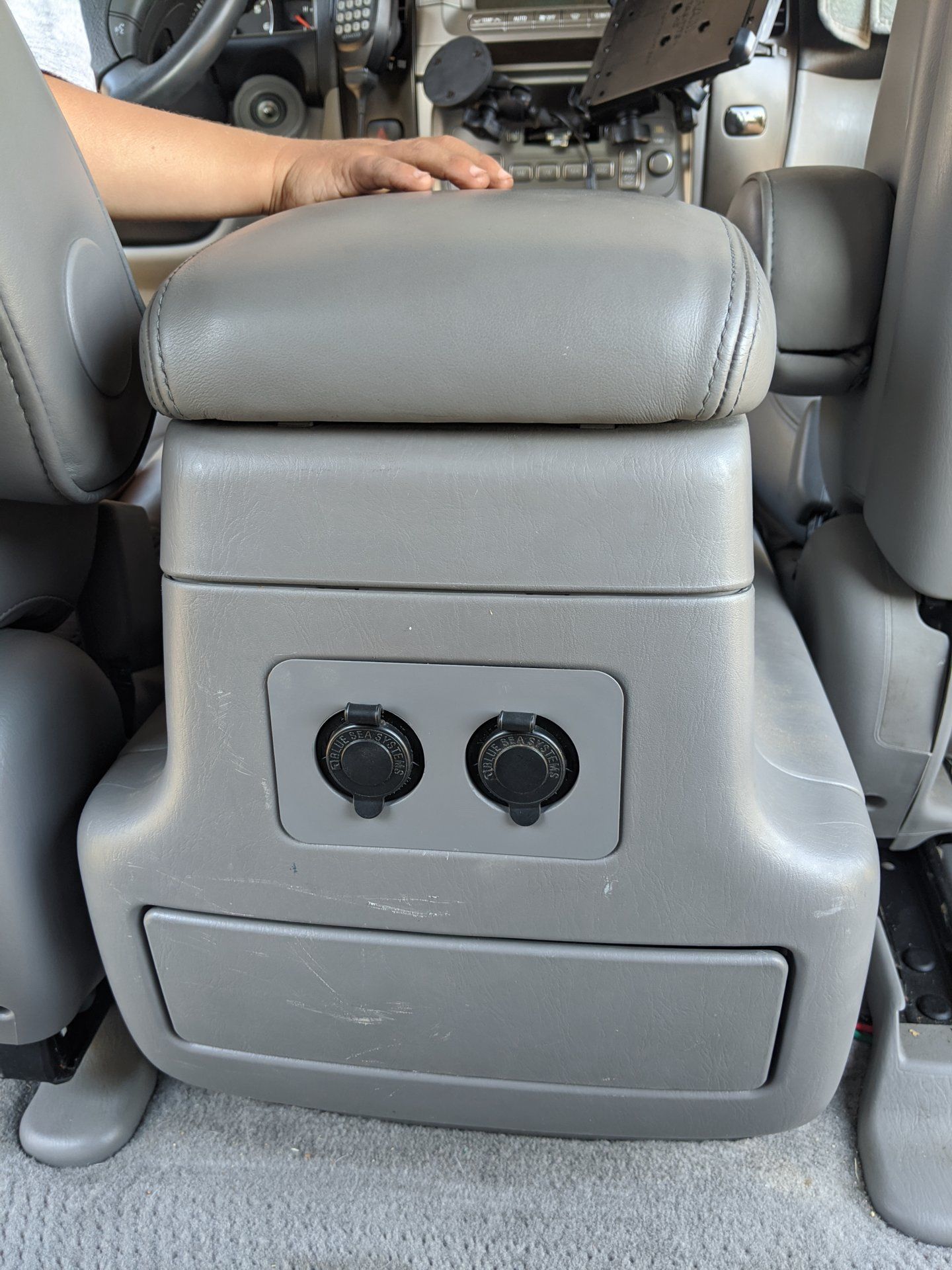

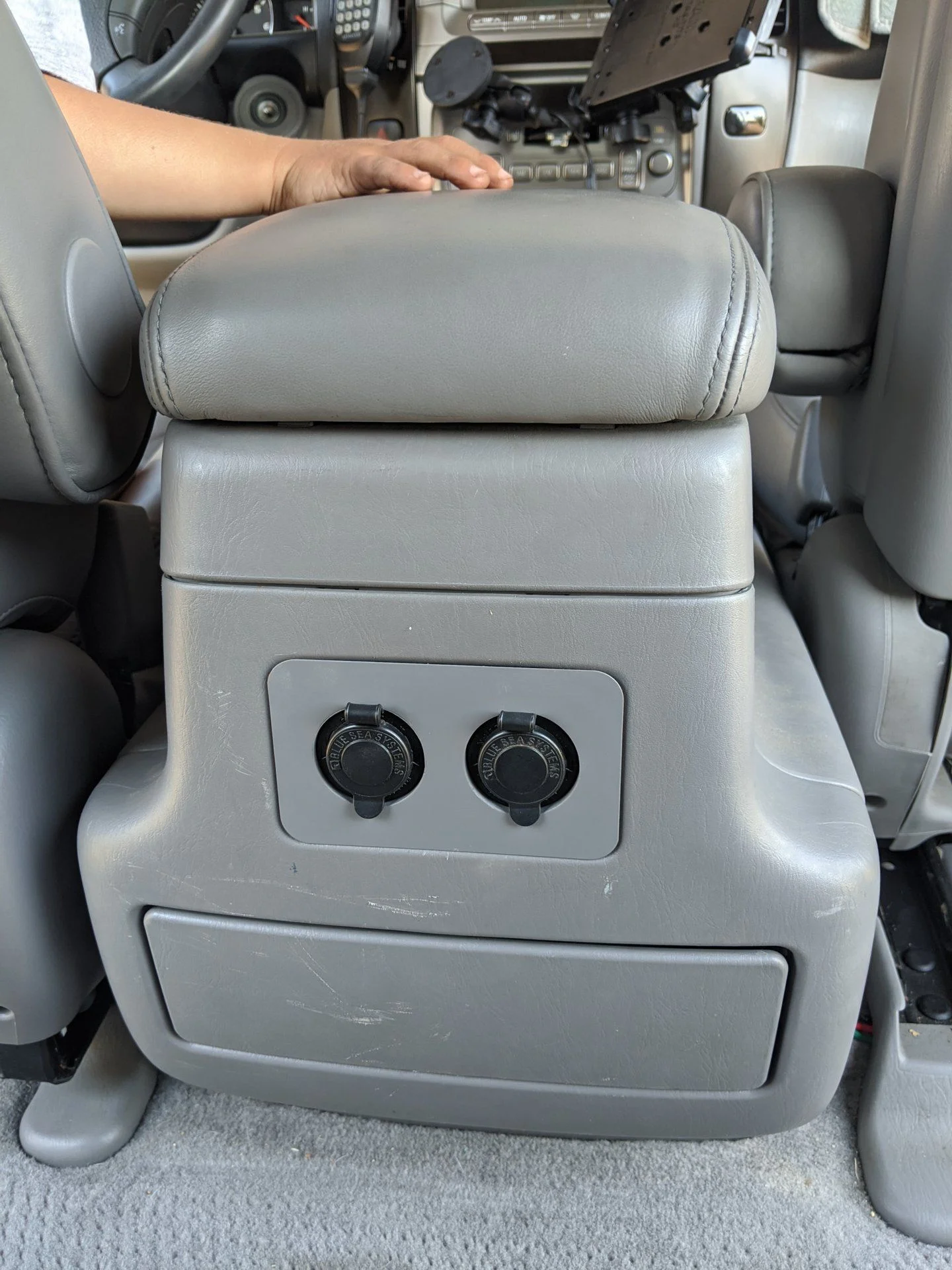

Super happy with the center console outlets Make 7v1. Easy to connect. I ran a 12 gauge wire from my rear fuse panel so it's always on. I've been wanting some within reach of the driver's seat. I do recommend the flag style connectors, otherwise you'll need to bend over the connections on the blue sea outlets.
View attachment 2267935View attachment 2267936
Nice! Did you remove the cupholder tray?
Nope, that's still functional.
Sorry, meant did you have to remove it to take the console off or could you just snap the console loose without removing it.
