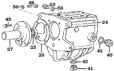

During your Rear Main OIL seal replacement Transmission Pull U will want to make sure u replace :
#25 Seal Ft out put shaft
#26 Gasket output shaft housing
#42 Crush ring gaskets x2
#56 gasket / crush ring
