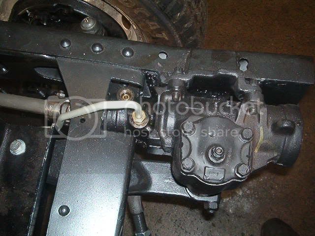

Food for thought, or something to watch out for.. A lot of the PS mounts are done with 2 scab plates on either side of the frame. Take a look at this for an example.
http://www.root45.com/PowerSteering/
I have a really nice one that Butch Lewis did, but have no good pics of it. This becomes more critical as tire size goes up.
yzftaco said:
Is it just me or does the cut-out for the steering box in the crossmember look scary.....
With a stout front bumper solidly attatched to it there shoudl not be an issue with what he did.
I aggree with Mace! The front bumper will add a lot of strength to the front end. Looking good with some real meats on those wheels!
