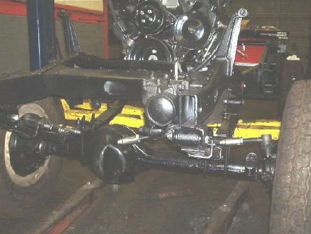

Wheel backspacing??
Well its been three weeks. Body is off and the frame has been sandblasted. Waiting for the Saginaw plates to arrive to start welding. We got a rock equipment high steer kit and are doing the SOA. FJ40 front diff with discs and MC calipers in the rear. Been reading posts about wheel backspacing and do not know what to do. Thinking of going 16 inch wheels to eliminate any problems and 35 inch tires. Also thinking about sticking with 3.5 backspacing??? Any help?

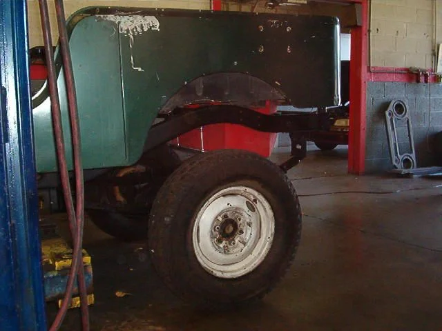

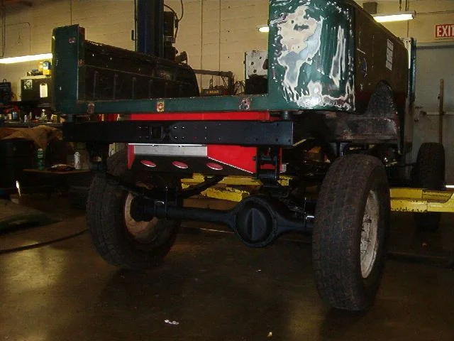

what kind of gas tank is that? why are you using castor shims in the rear? if you can get your shackle angle near 45' you'll have a much better ride.
everything looks clean i like it.
looks good your gonna need bigger meats..
Nov 1, 2005
69
Downey fuel cell
Spring perches are not painted, no shims. Waiting to weld them after all the "weight" is added.
Original plan was 35" tires, may need to go bigger!
Thanks,
John

Body is off again. Motor and tranny are in. Will send more photos after the
T-case is on.
I never thought I'd hear myself agreeing with this for a fellow FJ25'er, but yep . . . you're now gonna have to fill all that space with some tall rubber. :eek:
Let's see what the front looks like. :D

Give it a good couple outtings out on the trail and those springs should settle some.
