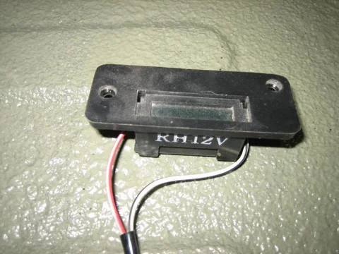

#2: What is this? I remember it vaguely but not enough to know where it goes and I don't see any loose wire ends that it could have belonged to.

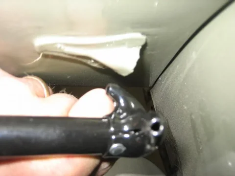

#4: Just bought these from Cruiser Corps and this is as close as I can get. Did they make different lenghts for different years or did these Chineese knock offs suffer the same fate as many aftermarket parts and just don't work? They are simply 1/4 to 1/2" off.

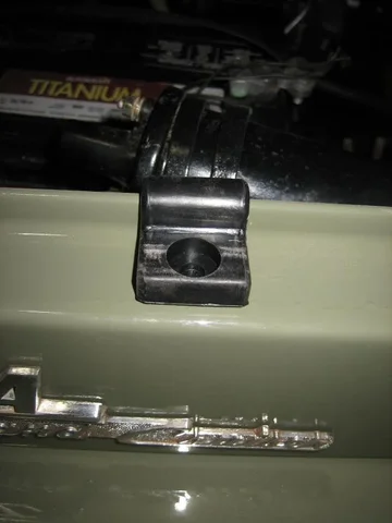

#5: These came in my hood pad kit. I believe they go here but I don't have any holes in the upper fender to screw them into? Do I kneed to drill one and put a screw in there? And where in relation (front to back) do they belong?

question# 2 - that is the light that goes in the underside of the dash pad

Question #5 above that is the right location but I can't remember offhand how far fore-aft it's supposed to be located (I think the back of the apron). According to SOR it looks to be a later-model thing, 4/75 and up.

Thank you. I think I will drill a small hole and screw it in. The extra padding comes in handy.

Question #5
Here's a picture of my hood pads. I think the bezel looks good as is. Great project!
I also notice there is a screw hole towards the front of your hood sill? Are you supppossed to have two hood pads? Also are those front hood pads stock? I know on mine the are two piece units that hook in the front bib. Thank you for the picture. I never even thought about color matching the bezel.
