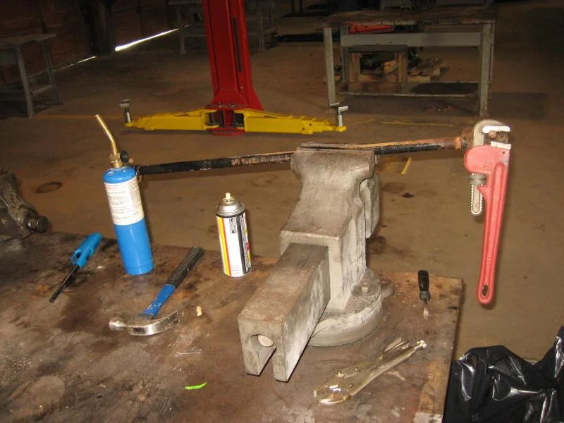

Also for note. If you are trying to put a lift on or replacing your bushings and having a hard time getting your spring pins out of the rubber. Heat and penetrants didn't do a thing...well a little bit. But the most effective method is using the thread in the sping pin hanger. Just simply put a plumbers wrench on there and turn it counter-clockwise out about 1/2 the way. Then you can put a punch in and beat it out with hammer. May not work for everybody but that is my TTP for the day.

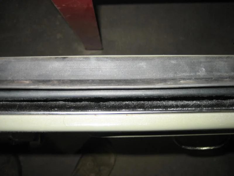

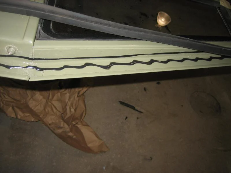

I figure some pictures are better than none...they are pretty crappy but ohh well. 1 door complete (minus plugs) and the other one mostly there. Also did a bit of prep for the suspension that (minus the u-bolts) should be finished up this weekend.
If your looking for a restoration project to do on your rig but don't want to put it out service the doors are a good one. New outer seal, outer wiper, inner felt all around and the window vent. May help keep things dry and rust free inside. It is one of those things nobody will ever notice you did and it cost entirely to much money...but if you have that nice rig and are looking to go a bit further it is a fun thing you can do in a weekend.
By the way that is not rust...it is actually that old red paint I believe or some primer from the factory. Not really sure. I can't really tell you how to tear apart the window mechanisim or door latch. I never got that far. I need to though as the old original paint doesnt' match my color I'm using everywhere else.

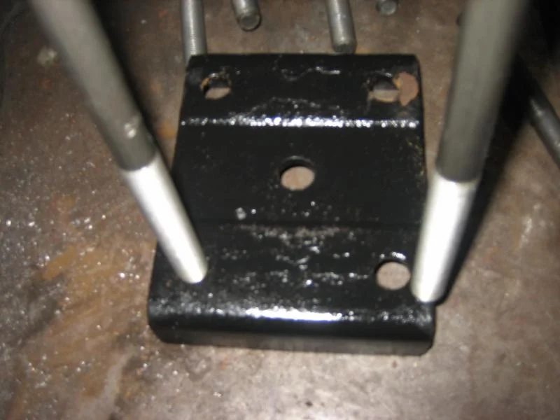

This is how I'm taking care of saggy springs and comfortably fitting 31x10.5" tires. Sadly they were a little tight on the bushings and had to gring an 1/8' off each bushing to slide them on. That and the bolts were slightly big. I had to thread them in thru the bushings. I'm figureing they were for a newer FJ40 with the bigger bushing??? The front shackles are slightly shorter. Hopefully it doesn't look to goofy.

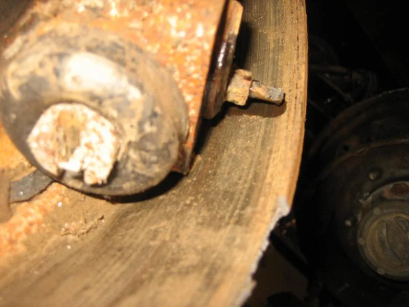

Had some fun tonight getting the front drums off. One side came off pretty easy. Basically had to unbolt the brake cylinders and pull it all out at once. The other side not so much.
Bad pictures just don't do it justice. The groove must have been about 1/4"...it was amazing. Luckily one of the four autoparts stores could order me one and it will be here Friday. I was about to give up and call Toyota in the morning but Advanced came thru. The otherside was actually just fine.
Also had to put the U-bolts in the vise to compress them enough to fit. Not the most productive day as I fought everything (still fighting one of them). But hey just another day in a rebuild. She should be down on the ground and ready to roll if I can find a spring for my fuel pump and work out some small electrical issues.

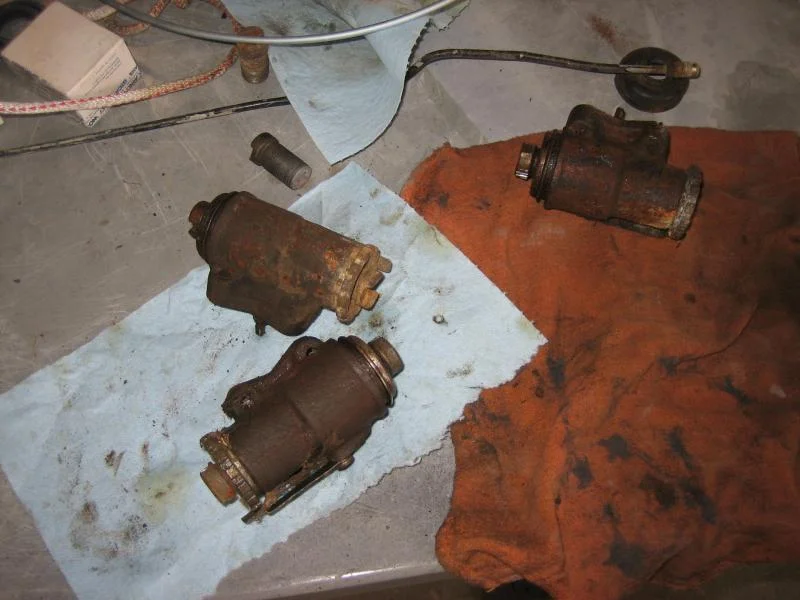

Now onto the brake cylinders. I can't get them apart to save my life...not even budge. I want to rebuild them. To learn and save about 400 bucks over buying the next cheapest unit I could find.
Can someone explain to me how to get stuck cylinders apart?

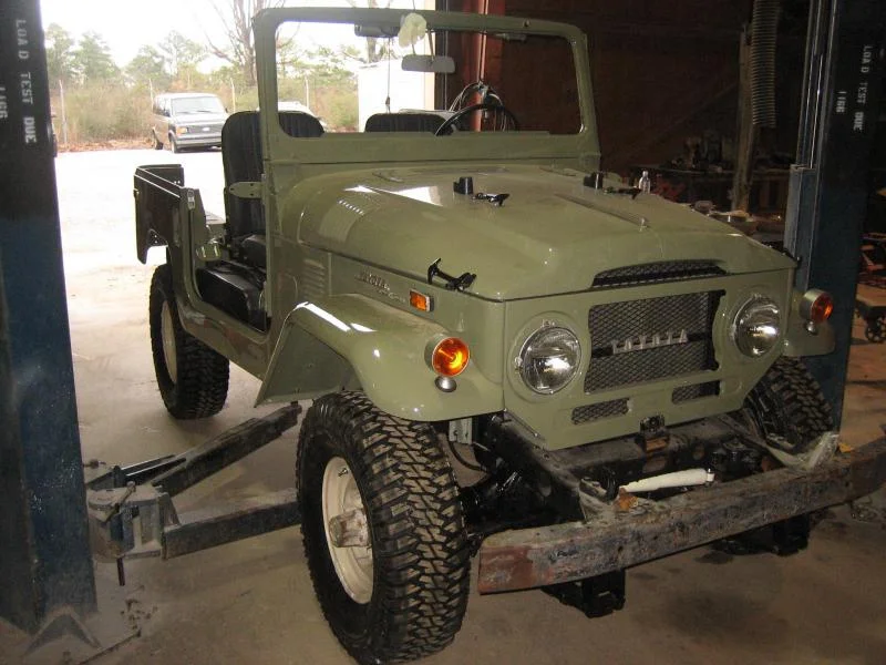

I threw on the wheels anyway just to see how she looks. The shocks I had won't work so I need to buy some new longer ones. The front is VERY NICE. The rebuild I did on them worked very very well. The polyeurthane that I put in between them made a huge difference. Well that and getting rid of all that rust holding them together. Did I mention that they wouldn't even move...talk about no flex. The rears on the other...well I think it has more to do with my very s***ty shakle angle. Sadly nothing I can really do about that without moving the spring perch and I'm not going to dive that far in. I really do like the stance though. Should settle down a bit when I get the hard top spare tire on.
Here are the tools of the trade for today.
