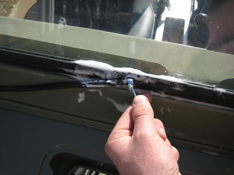

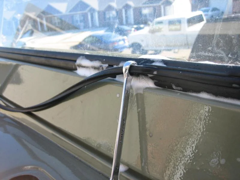

Got most of the windshield in. In need to work on the key still. Got about 1/4 of it in but it is a lot of work and I think I'm going to try the end wrench method or go get the tool from lowes to get it done in a hurry.

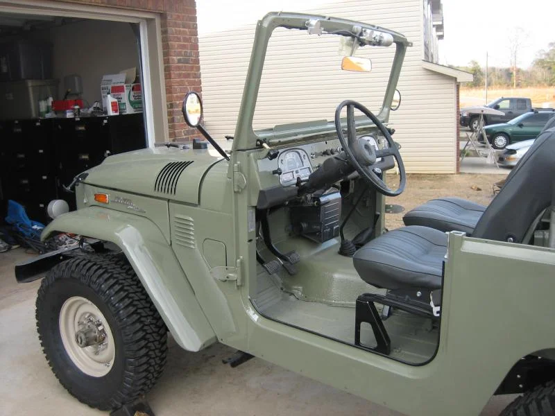

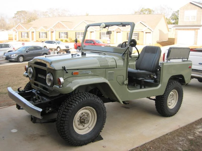

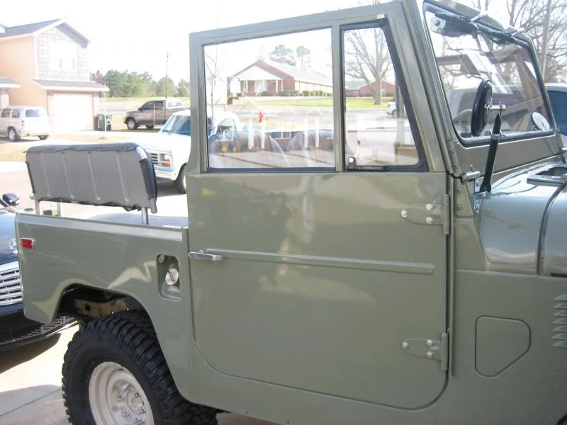

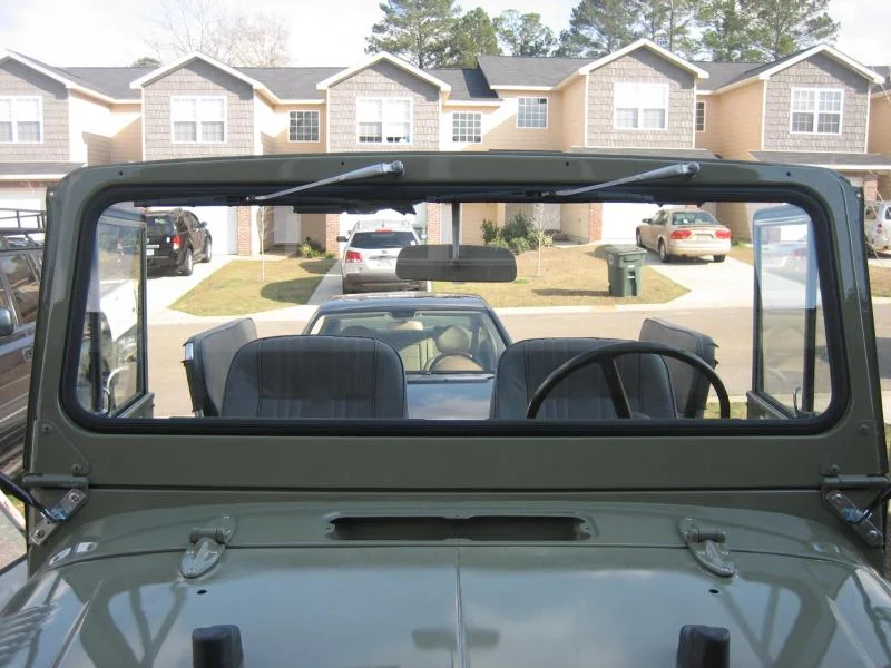

Here are the pics. I'm out of money for a couple weeks so probably won't get much done. Maybe some body work on the hardtop.

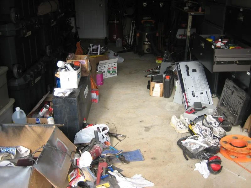

A few more. I think I'm going to go with some Autozone tail lights. Also the vendors that sent me my rear emblems didn't send any nuts with them (thanks for nothing)...so I found out that the nuts on the fresh air vents are the same so I will have ot make a trip to fastenall (usually have to buy a bag of 100) or to Lowes which will sell me 4 at the same price fastenall will for a bag of 100. This is my now very very messy garage. And this is after spending 2 hours cleaning it up. This townhouse living is not conducive to a automobile afficiando.

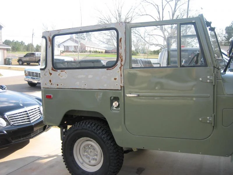

So I got a bit done this weekend. Big things were finishing putting the windsheild lock in, bolting on the doors, finally finishing my last rear bench seat, windshield wipers (with some mods to make them work) and some body work on the hardtop. If all goes to plan I will have the hardtop painted and on by the end of the weekend.
