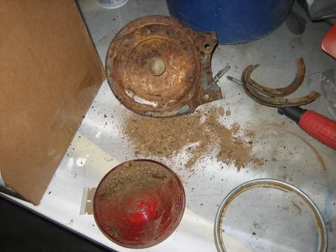

What are you gonna do with those rear tail lights? Is there a way to restore 'em? They look in pretty rough shape.
Here is a few more pics. I'll take a few more tomorrow and hope to make some good progress again.
I have the lense casing sitting in some evapo-rust over night. I've been very impressed with the stuff so far and hopefully I can salvage them. This is not going to be a 10 out of 10 rebuild so I'm not to worried about it at this point. And I'm already over budget and out of money so I'll do my best at this point.
