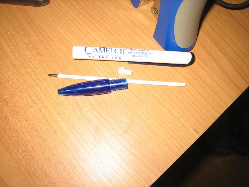

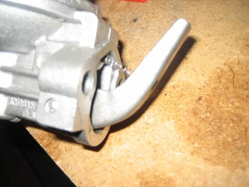

Just before bed (like right now)..I had a great idea on how to replace that spring in my fuel pump. It took me 4 different pens but I found one that was close. Sadly the spring is about 1mm to long and it doesn't QUITE have the balls the original one did but it doesn't seem to want to fall out of place and 100 times in a row it returned the lever back to the full back position. So I will stick this in the truck tomorrow and see if with the carter pushing this does the trick. Bummer it involves an oil drain since I just put it in there but it will give me a good visual into what is happening inside.

ace hardware.. maybe even homedepot has a drawer full of every size and type of spring imaginable.. buy the one you need for a dollar and cut it to fit! i wouldn't trust a pen spring either
Sadly it would cost me 40 dollars in fuel just to get to the nearest Ace Hardware. I might just buy another pump. It is just so dissapointing that I have a perfectly good pump and missing a damn spring (well it broke). I might try this one to get me thru the weekend and get this thing running and driving so I can get it down to the exhaust shop. The weather has been amazing and I need to get this thing out on the road.
