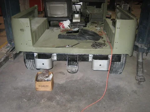

I used some SS Carriage bolts. They look good but why did toyota make them so hard to put in with the rear cross supports. I bet at one point in time the nuts were welded back there but the PO probably had to snap them off.

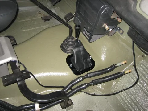

Notice the 3/4 heater hose. I bought 10' haha. Apperantly the hose is smaller. I will be searching tonight or just take the tubes in with me to the parts store. I'm guessing 5/8" will work better.

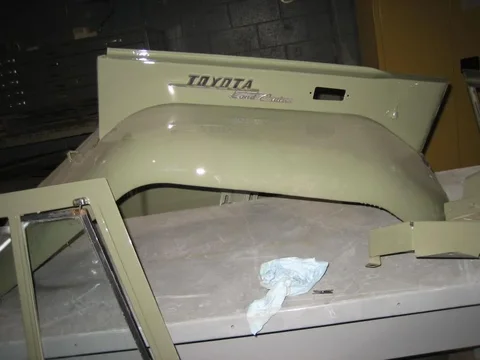

I cleaned them up pretty good with steel wool but missed a few spots inbetween the letters. Hard to get to. Also got the upper portion bolted on as my bolt kits made it yesterday. I need to order the felt for the windows as I forgot all about that until I put them in today.

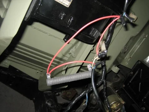

My resistor made it here in 48 hours. Shipping was twice the cost of the part. But it is in and I got it all wired and soldered up real nice. I will finish tapeing it and mounting it later. Both of my mounts were rusted away so I can't simply move one of them like others have done.

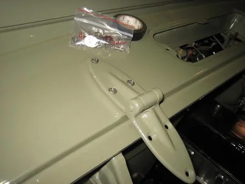

Got some more of the hardware in. Read the description wrong and only got 2 pads. Will need to get two more for the hood. My tap came in handy as some paint had filled the threads.

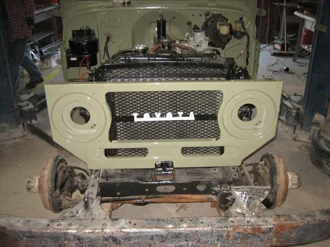

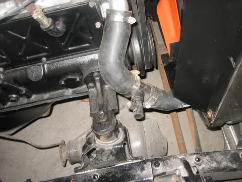

I got lucky today and found the right part for the lower radiator hose. As noted earlier by Matt it had a piece of exhaust in there before. Luckly the engine I got from John had the right part in a box. Thanks again as I've used many parts and pieces from your engine/tranny combo now.

Other than that it just seems like I wasted most of the day. Got some more small wing done and a couple of brakelines. Got one of my rear seats in. I was a couple feet short after changing my routing for heater lines but that is almost done. Just need some more clamps as well.
