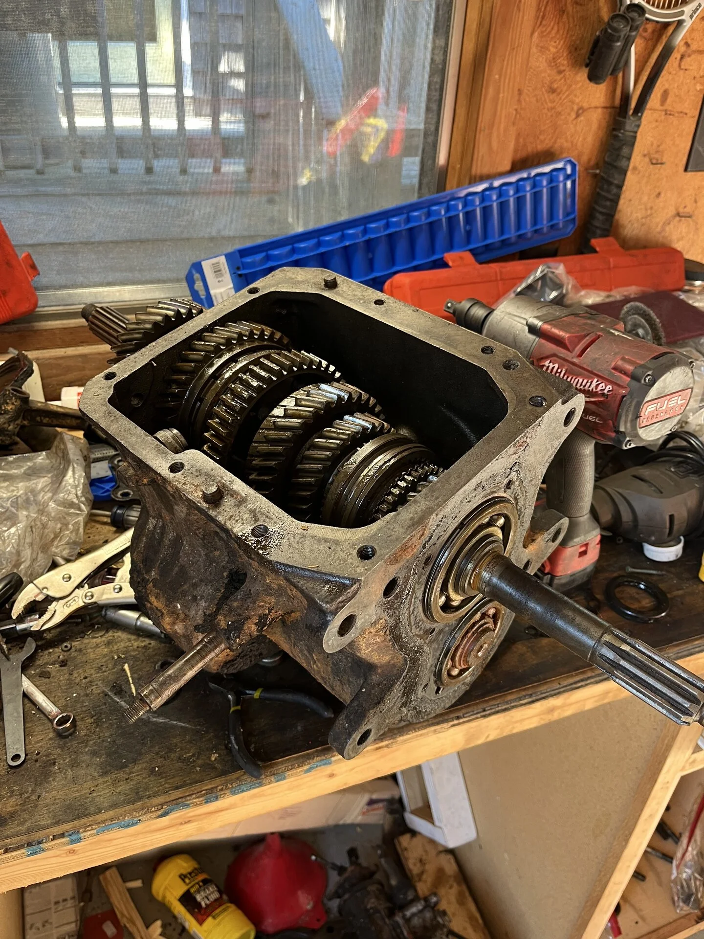

I am planning on redoing my h42 transmission. Can somebody also point me in the direction of the correct bearing puller I can use to pull the transmission bearings? Is there a puller that I can borrow from somebody or rent from somebody on MUD? I am too far from a car parts place to rent one before somebody says that. Did you use that one? I could also buy one but I don't want to spend big money on it. This one ( puller) would be epic but I am not sure I want to spend 250$ for a puller that I will only use a hand full of times. Figured I would ask here.

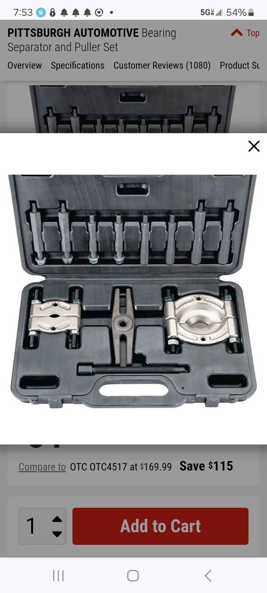

You might try something like this. The bearing separators might be able to get behind the snap ring or catch the snap ring groove if the snap ring is removed. You may need some longer threaded rod to clear the output shaft.
I am going to try this first because it seems easier! Thanks for responding. I had not realized these would be loose enough for this.
