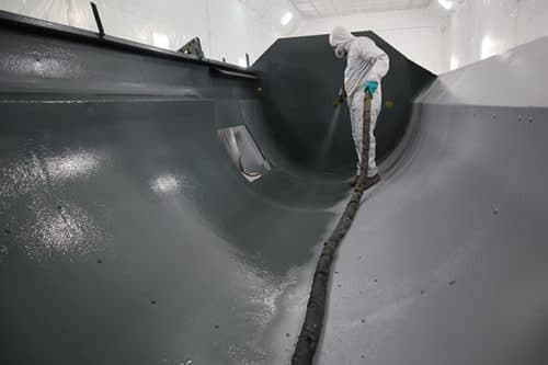

I don't believe that would be durable enough for what you are doing, I'm guessing some sort of polyurea coating is what you want.

Again my first choice would be a polyurea coating but I'm not familiar with any DIY kits. I did try to coat the entire inside of my Pig with polyurea but it was a huge PITA.
