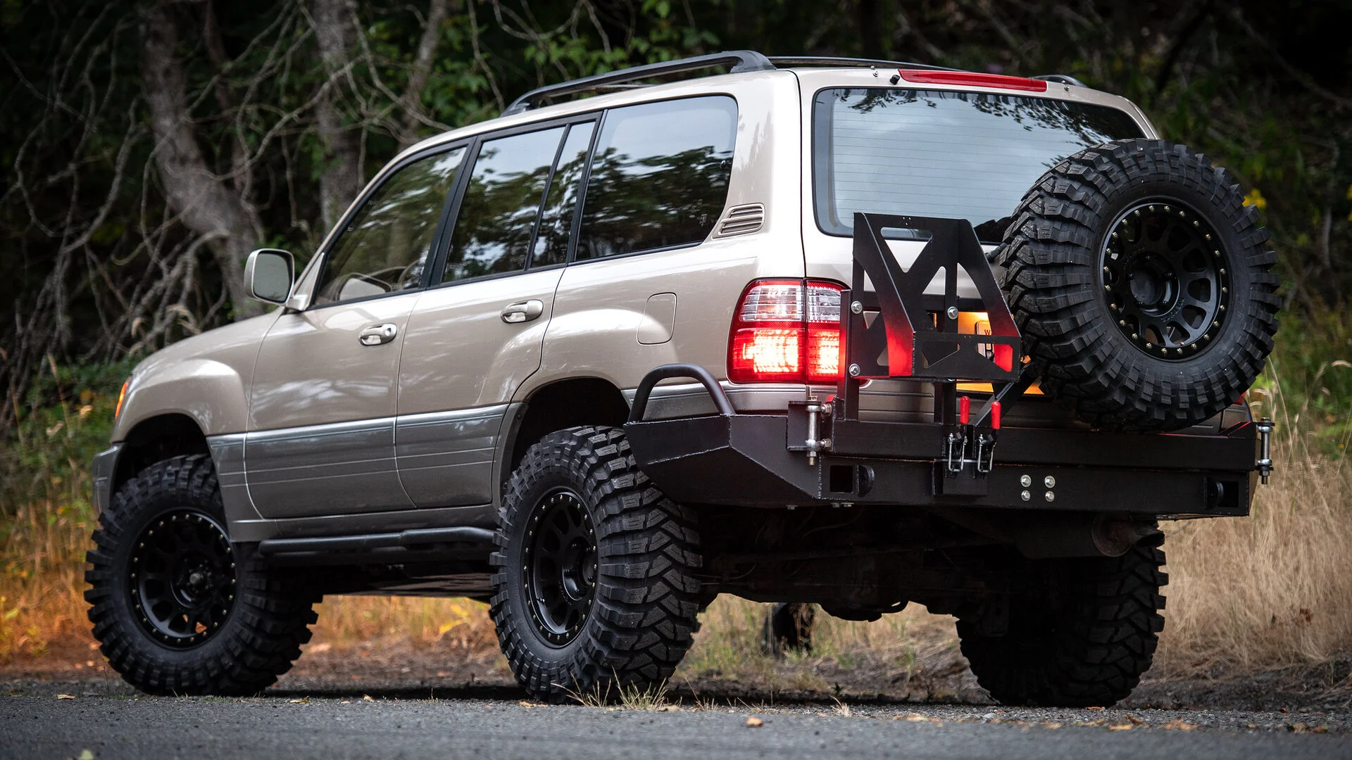

Very nice - what color is that rig?
GoldieHahn is a 2001 LX in the Gold flavor, we call it Old Man Tan, just sounds a bit better than Gold🤪
