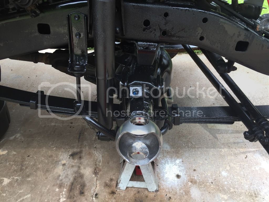

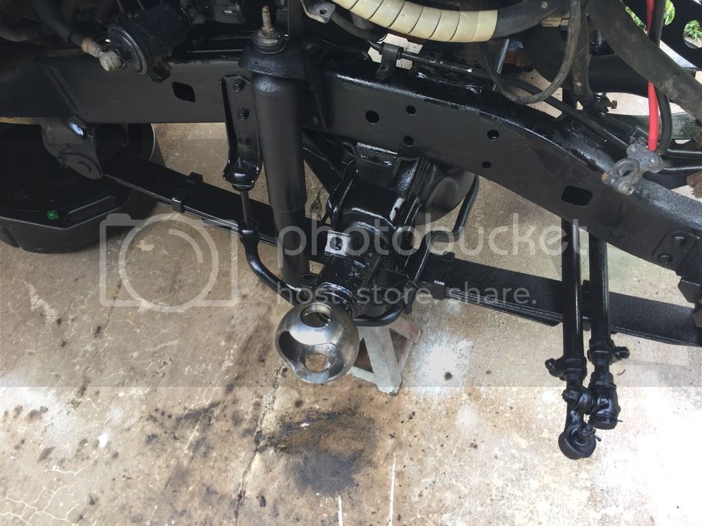

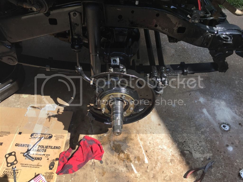

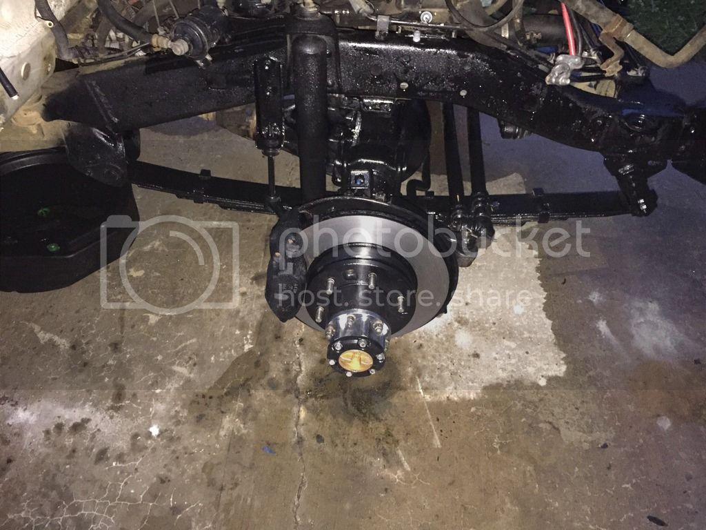

Speaking of making room to work... Seeing as how I've never worked on the front axle of a 60 series before now i can't positively say having it apart made going through the knuckle/spindle/hub any easier, but it couldn't have hurt.

-Front axle refresh is complete
-new calipers and pads & rotors turned
-new drums and wheel cylinders
-all rubber brake lines replaced & system bled
