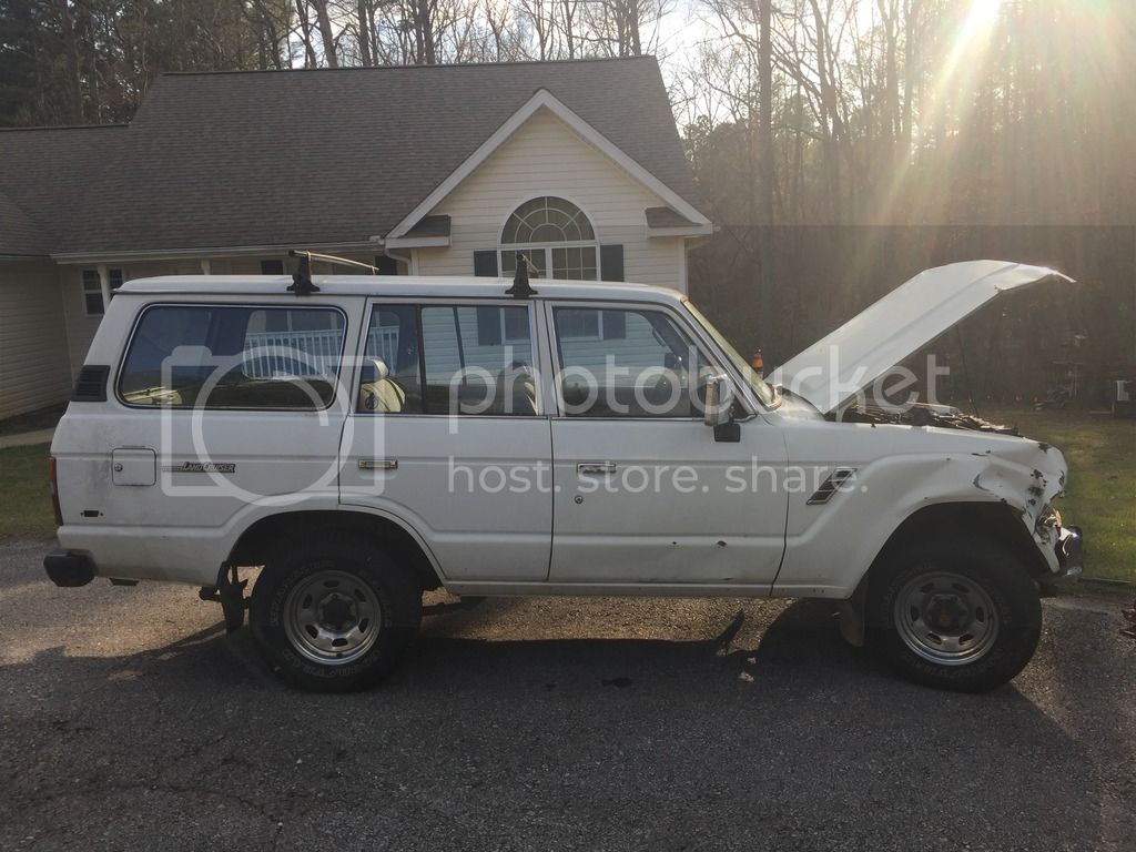

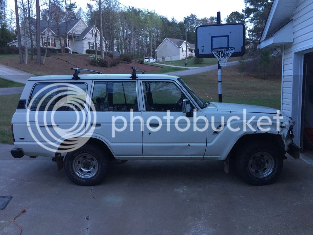

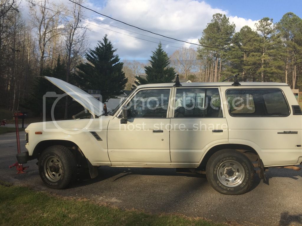

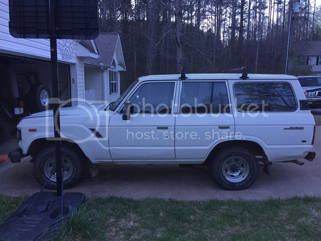

I just found an FJ 62 on the side of the road, and the price was right.
So, what can I say, it followed me home.

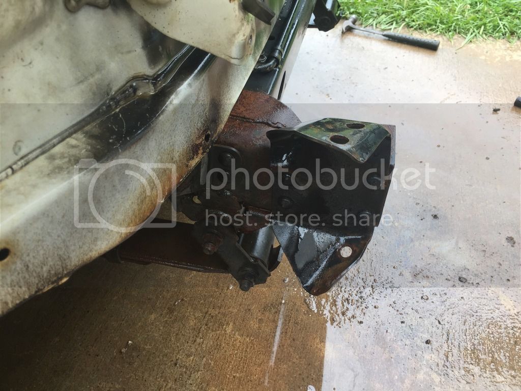

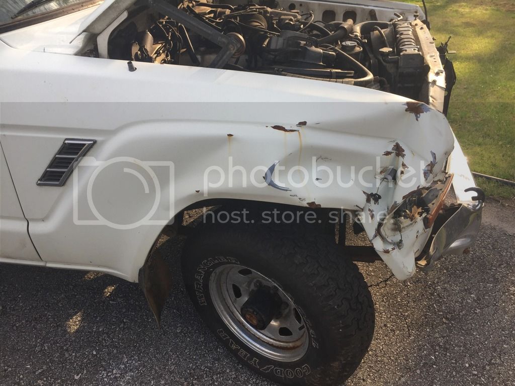

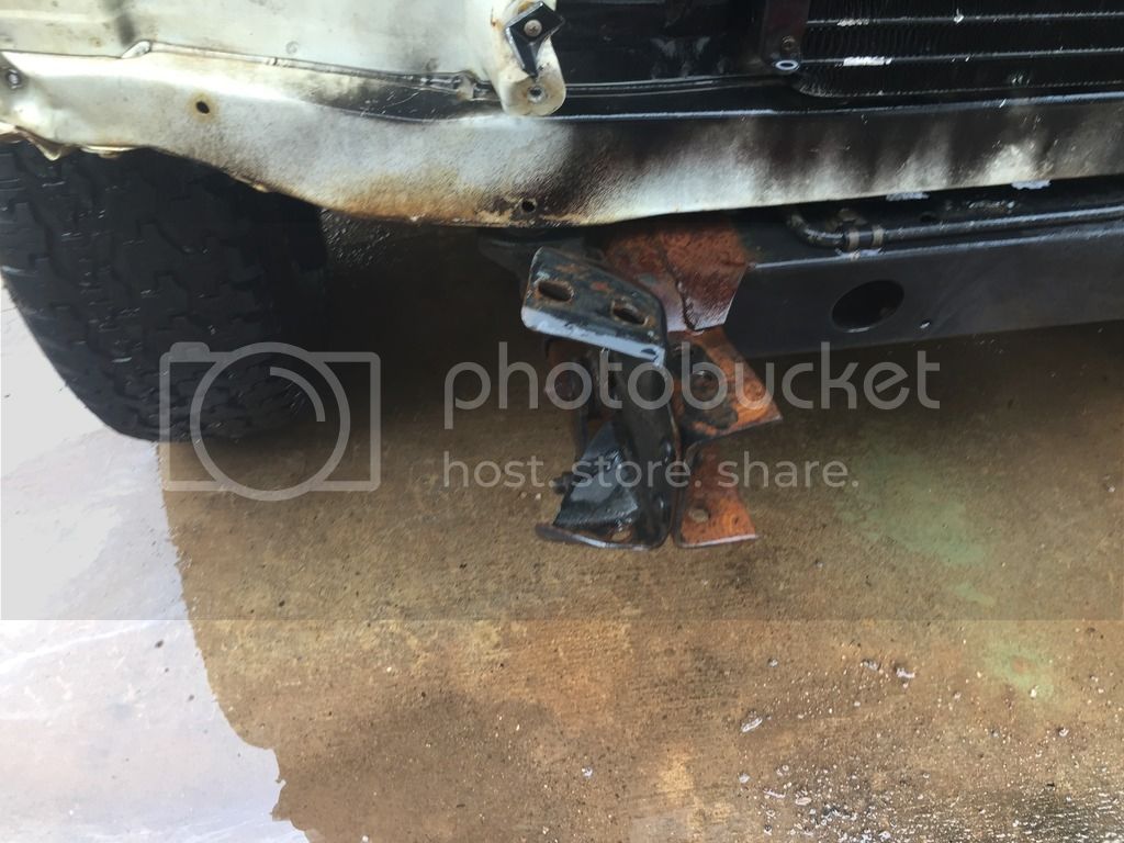

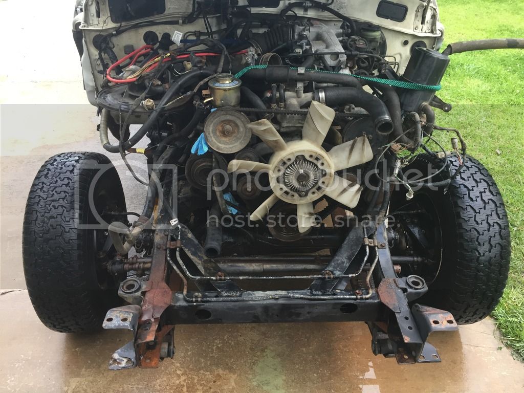

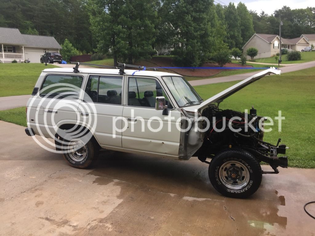

Previous owner tagged a f150 and took out the grill, passenger headlights, inner and outer fenders
The good

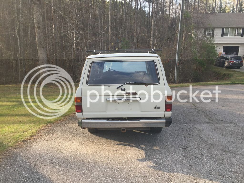

-With the exception of the front clip, and what appears to be surface rust on the hatch the body and frame are nice.
-seems to run/ drive /ride well ( have only driven at mile or so )
-188k miles
-Has Yakima towers & cross bars
-It's a land cruiser
The bad
4wd light is on
No tail lights
Gauge / dash lights inoperable
Windshield is broken
Only front windows work
Power locks cycle , but only driver's works consistently
AC system is open/ missing components
Front axle is leaking at both ends
The ugly

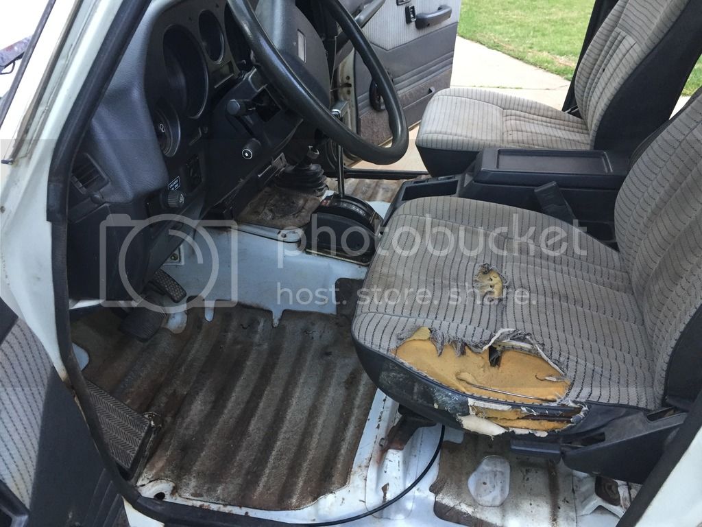

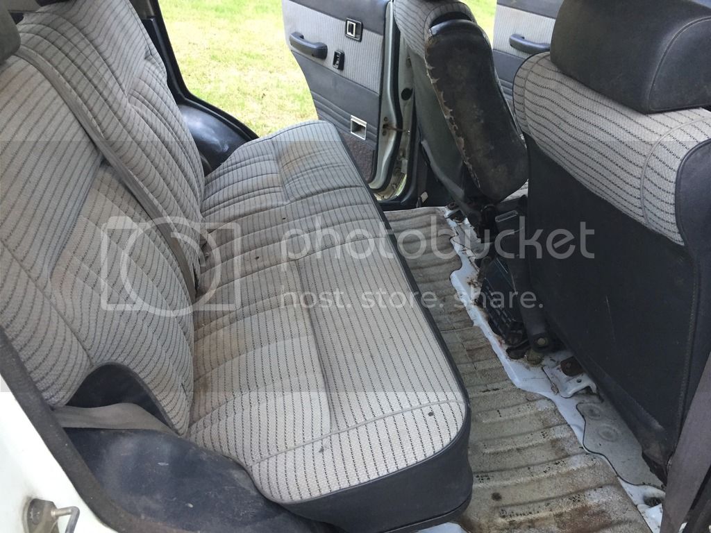

Filthy inside & out

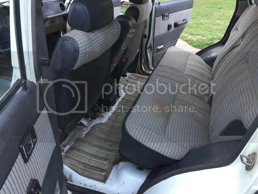

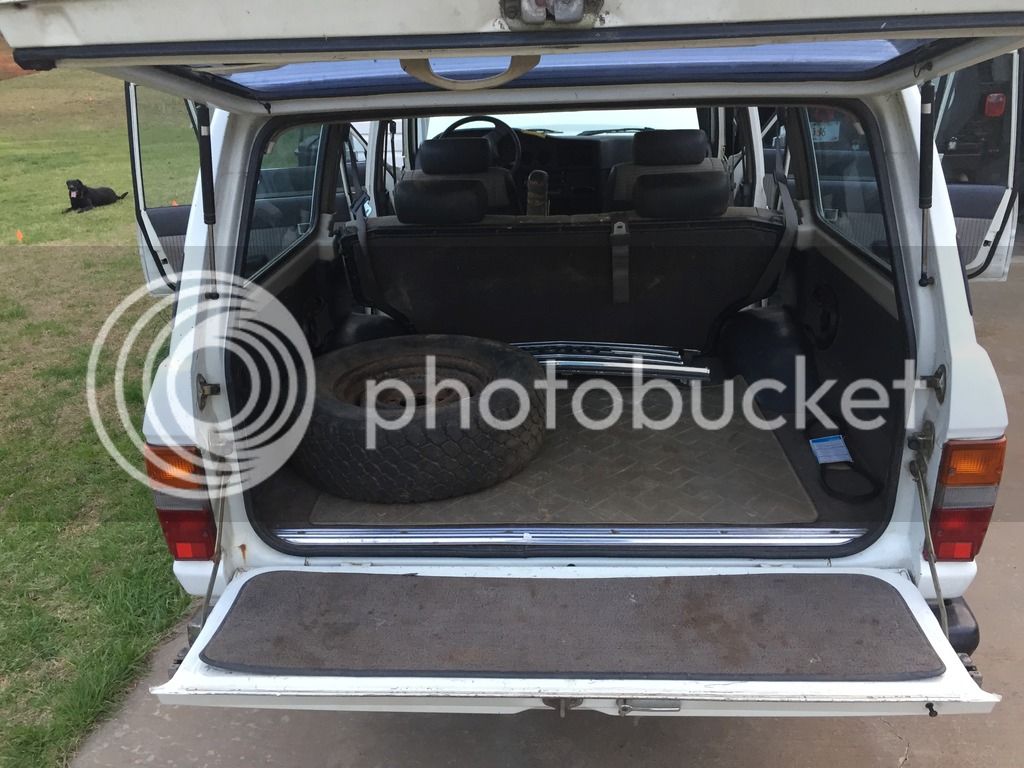

Missing carpet
Dash pad is trashed
Radio awol
Driver's seat is in rough shape

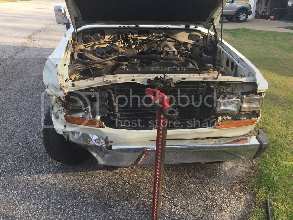

Collision damage
After I took these I used my winch (& an eight pound hammer) to pull the front sheet metal out enough for the hood to close & allow me to put the battery out of my taco in it.

-Collect parts to replace front clip (probably with 60 parts)

All I can say is wow! That looks like on of the biggest "challenges" I've seen on here. Good on ya for saving it from the crusher. And good luck!
Actually looks not bad. The gaps in the doors back from the front fender look ok. Just get used fender & hood, put a custom/home built bumper on and body wise you are in good shape. The electrical just needs to checked to find where the problem is, (I know it sound like Capt. Obvious) but it is doable, more so than a modern vehicles. That rear bumper looks mint, even the leaf springs look like they still have some "arch" left in them. If the frame is as good as the body, you got a great Land Cruiser.

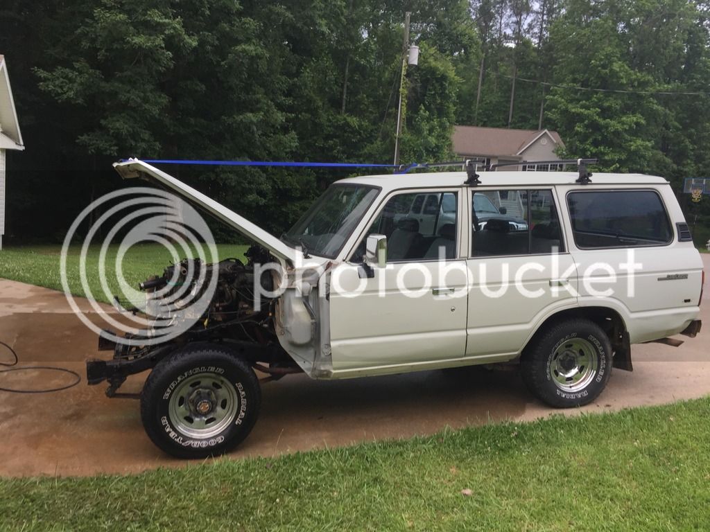

I spent some time yesterday taking inventory & cleaning the truck inside and out. As expected the list of issues is getting longer.
I found a small leak in the radiator, so pulling it and having it repaired will move to the top of the list for now. I don't have any intention of putting this on the road for quite a while, but would like to be able to start it and let it run without worrying about overheating it.
The jack & tool kit are missing so I will need to track down a replacement. Are they cruiser specific or common to the pickup/4Runner? I mainly care about the ability to raise & lower the stock spare.

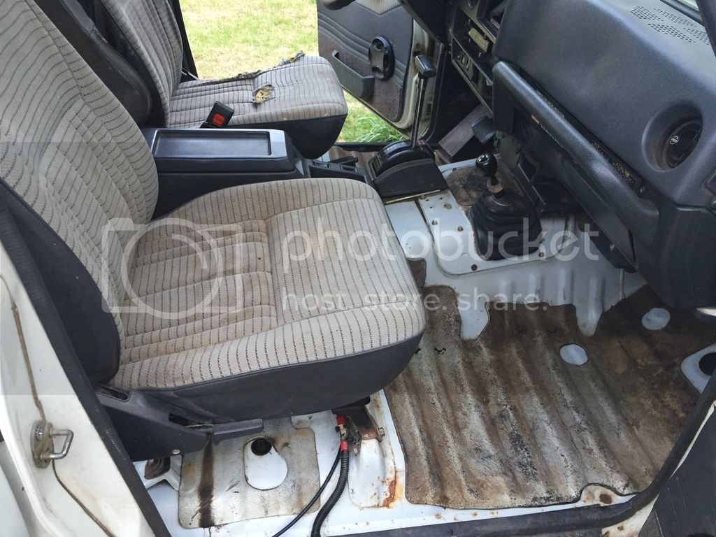

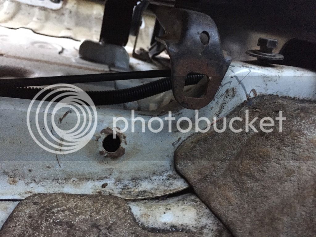

While removing the console to scrub underneath it I realized part of the front passenger seat base is missing. (Under the inboard, forward leg). Does anyone know where I can find this part?
The front floorboard drain plugs are also awol (this did make it easier to clean)
I ran the truck again and the radiator leak is worse than I first thought, so I ordered another one. I think I have located the sheet metal I need for the front end, but it will be a while before I can go collect it. While I'm waiting on that I think I will turn my attention to the front axle.

Also, anyone parting a 62 have the seat mount part available? (Passenger front inboard, pictured above)

I have located replacement sheet metal for the front, but it will be another month before I have time to go pick it up.
