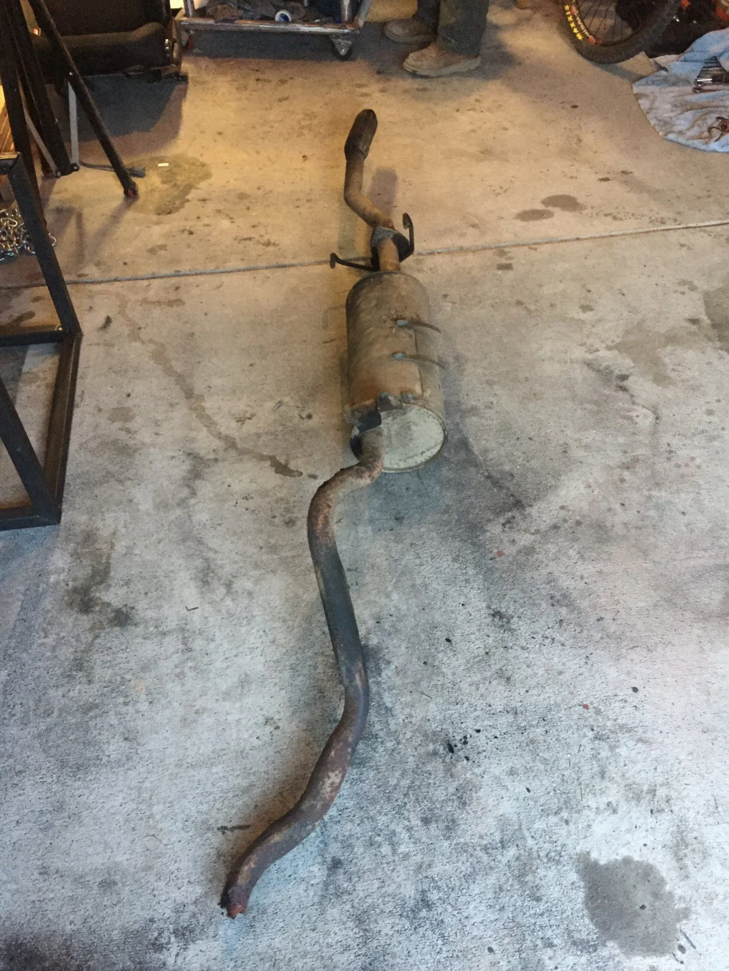

I'll start with 3 (4?) weekends ago - as I mentioned previously, we cut up the old exhaust & fabbed a (mostly) new one - the "one or two" rusty spots the dealer disclosed could have been more accurately described as: "almost rusted through just about everywhere" so it was time to fab up a new one. Thanks to @DanS HJ-45 for the suggestion for the shop on broadway - I wish I had the budget to take advantage of their services. A 3" exhaust & downpipe is in the future, but for now, I've got to stick to getting everything 100% functional before I start upgrading, and getting functional has to come on a bit of a budget, unfortunately. So we fabbed a new exhaust up (took most of a saturday to get done, but I'm really pleased with the results.
The old exhaust: (literally sheared off the flex pipe and the end of the exhaust with fairly light hand pressure)

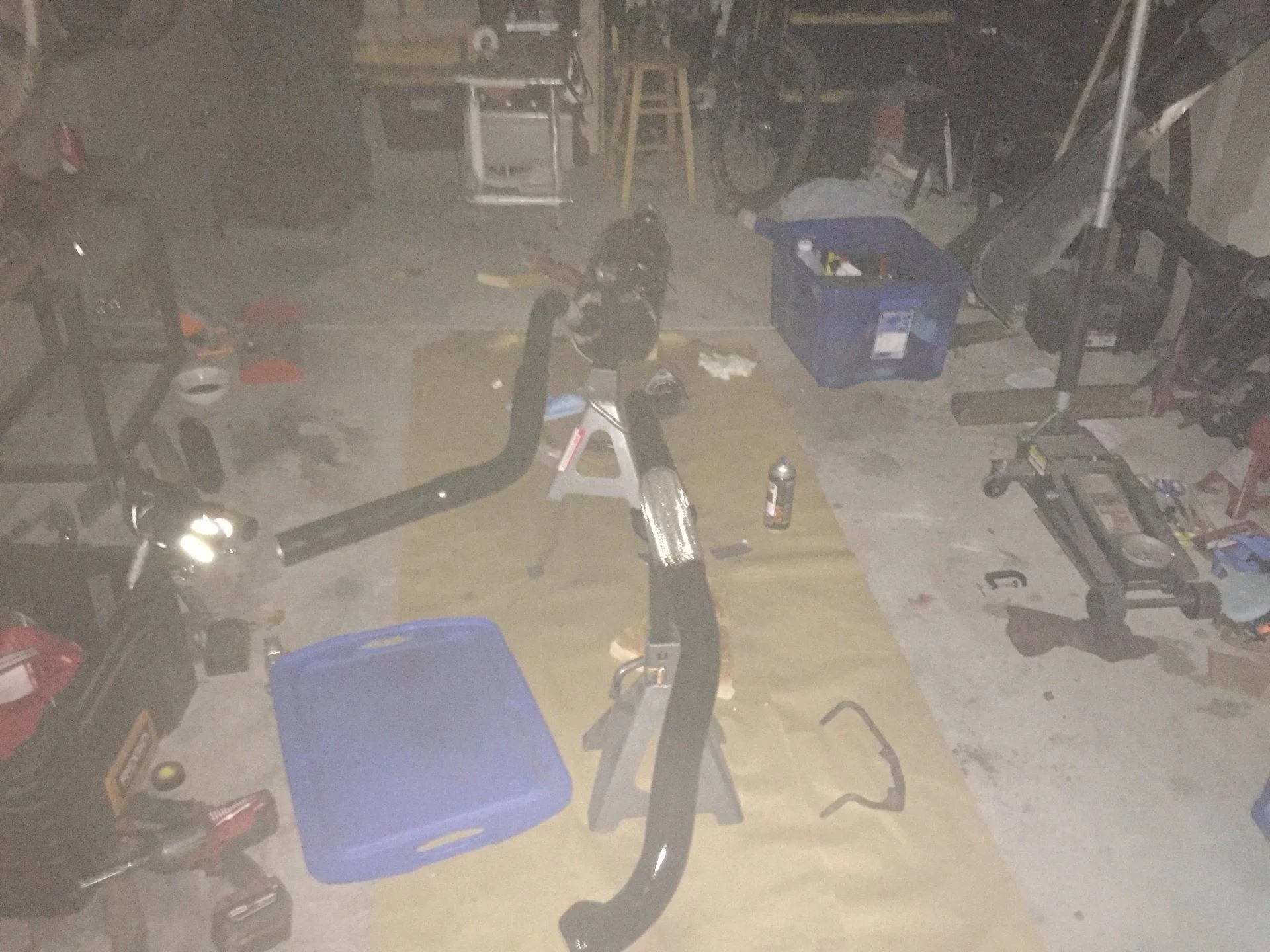

new one at ~90% done. (sorry for the crappy lighting - it was dark and I was hungry)
We coated the exhaust in a bake-on engine enamel to try and keep it intact until it's time for the big upgrade to a 3" unit. We decided to route the exhaust out the side of the cruiser instead of straight out the back, which I'm quite pleased with.

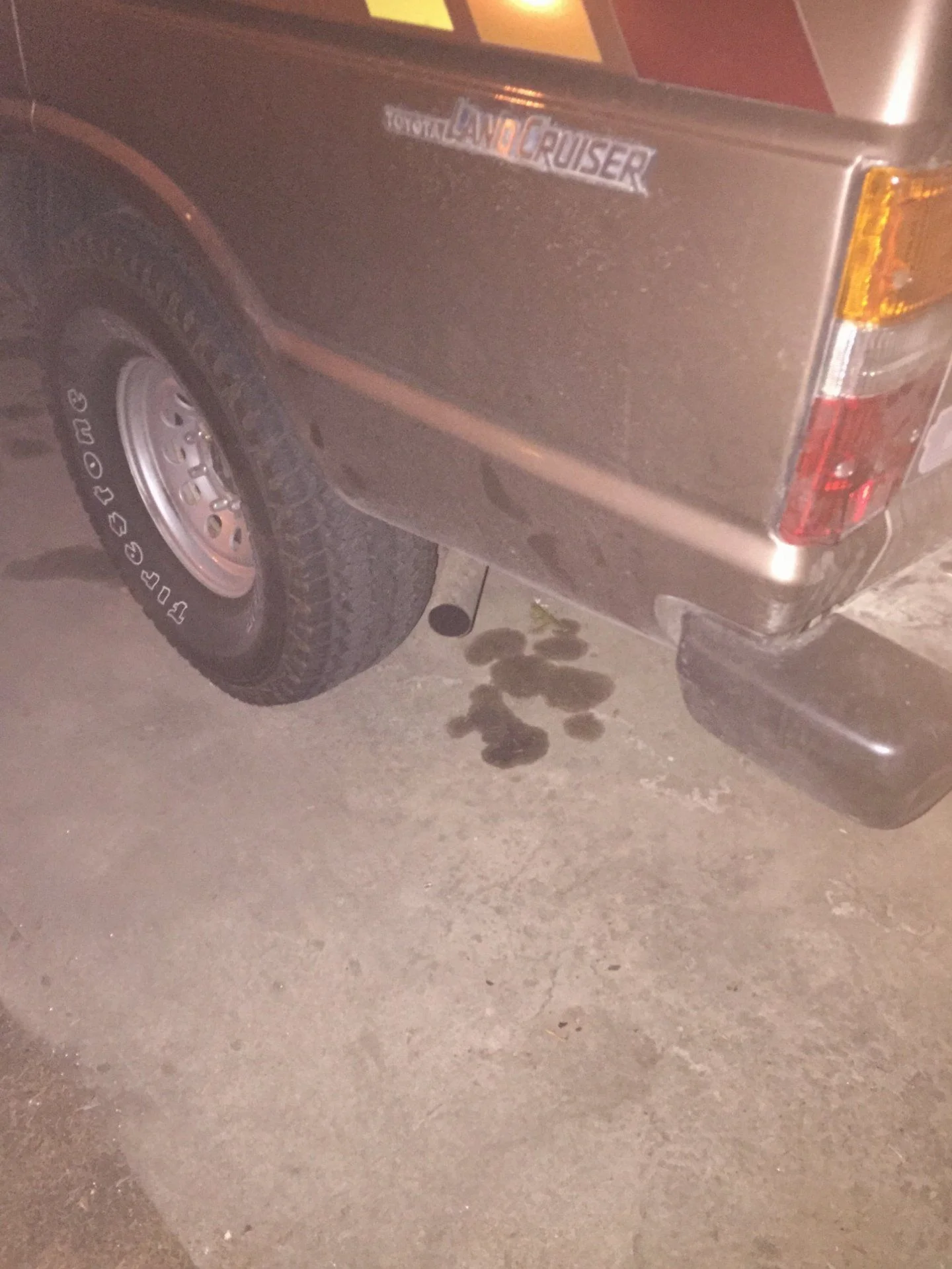

The finished product attached (don't worry, that's just some penetrant spray on the concrete, nothing else :)
