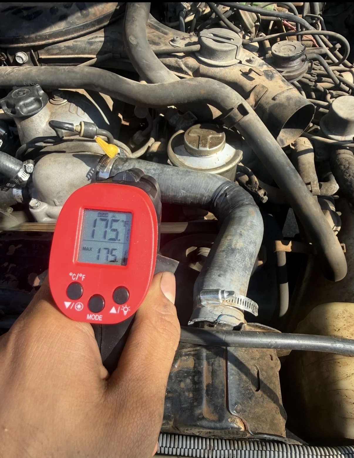

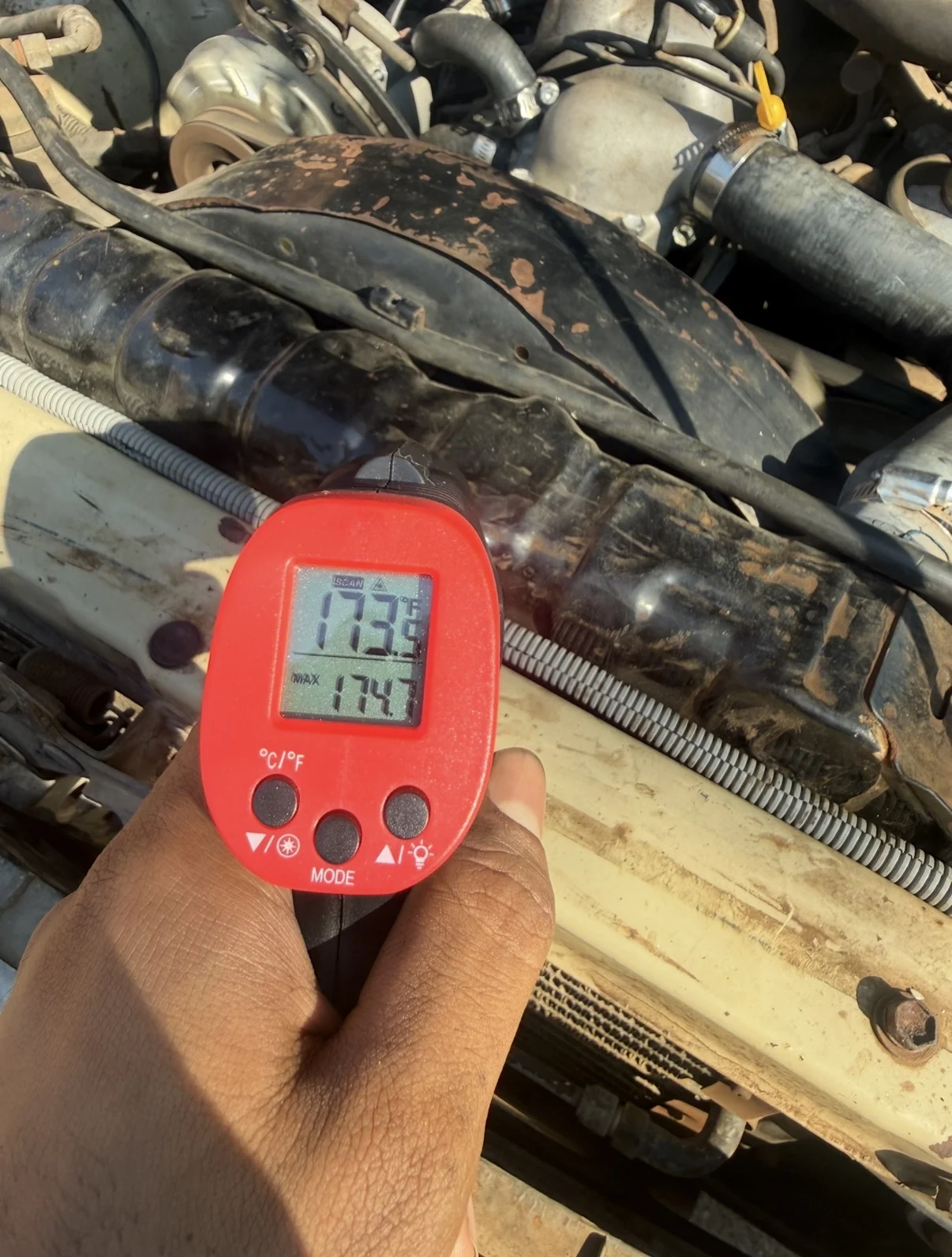

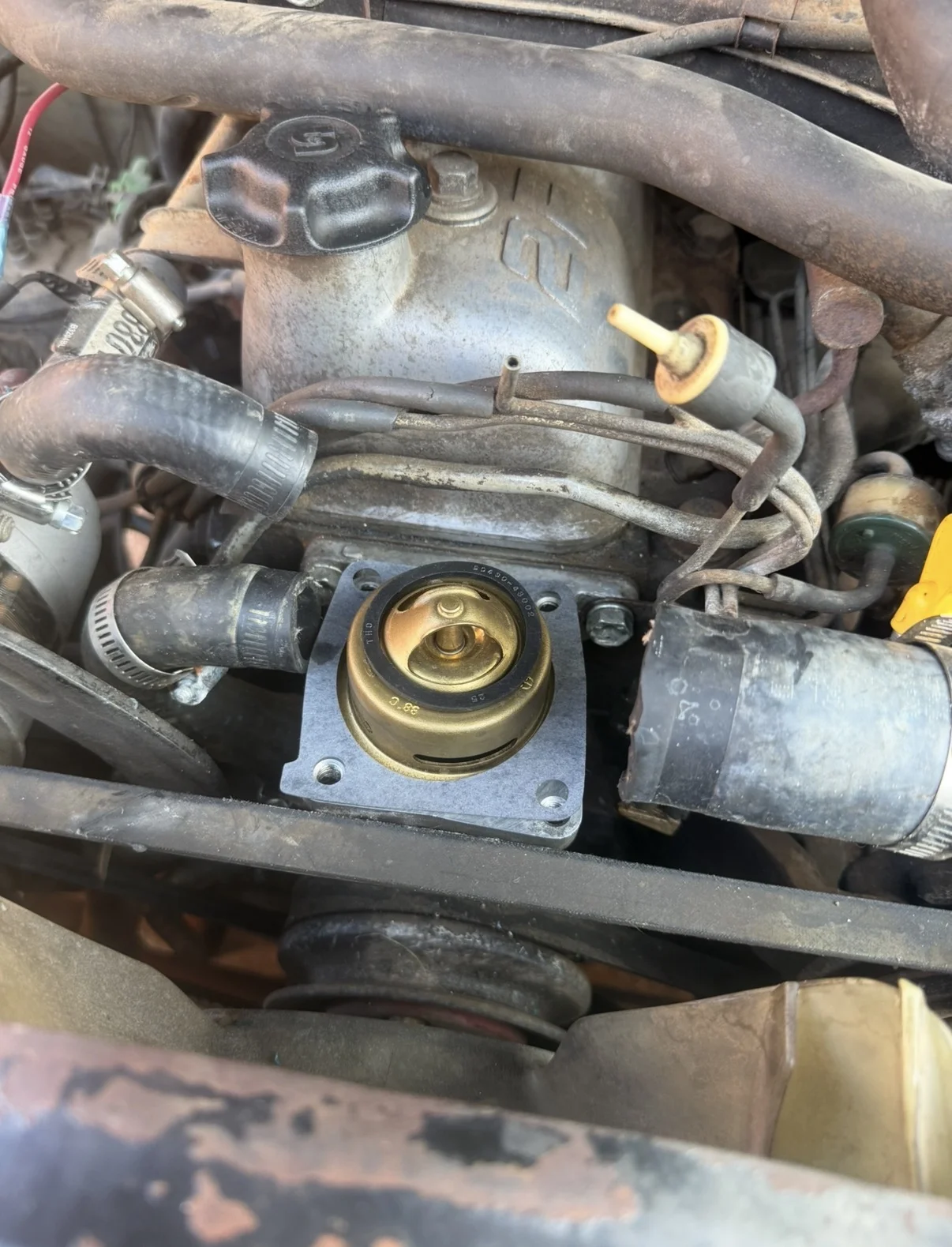

Hey yall, I'm currently doing a coolant flush on my new to me fj60, it would overheat when driving but idling is fine. I changed the thermostat to the 190deg one and as the engine is running at idle these are the temps.

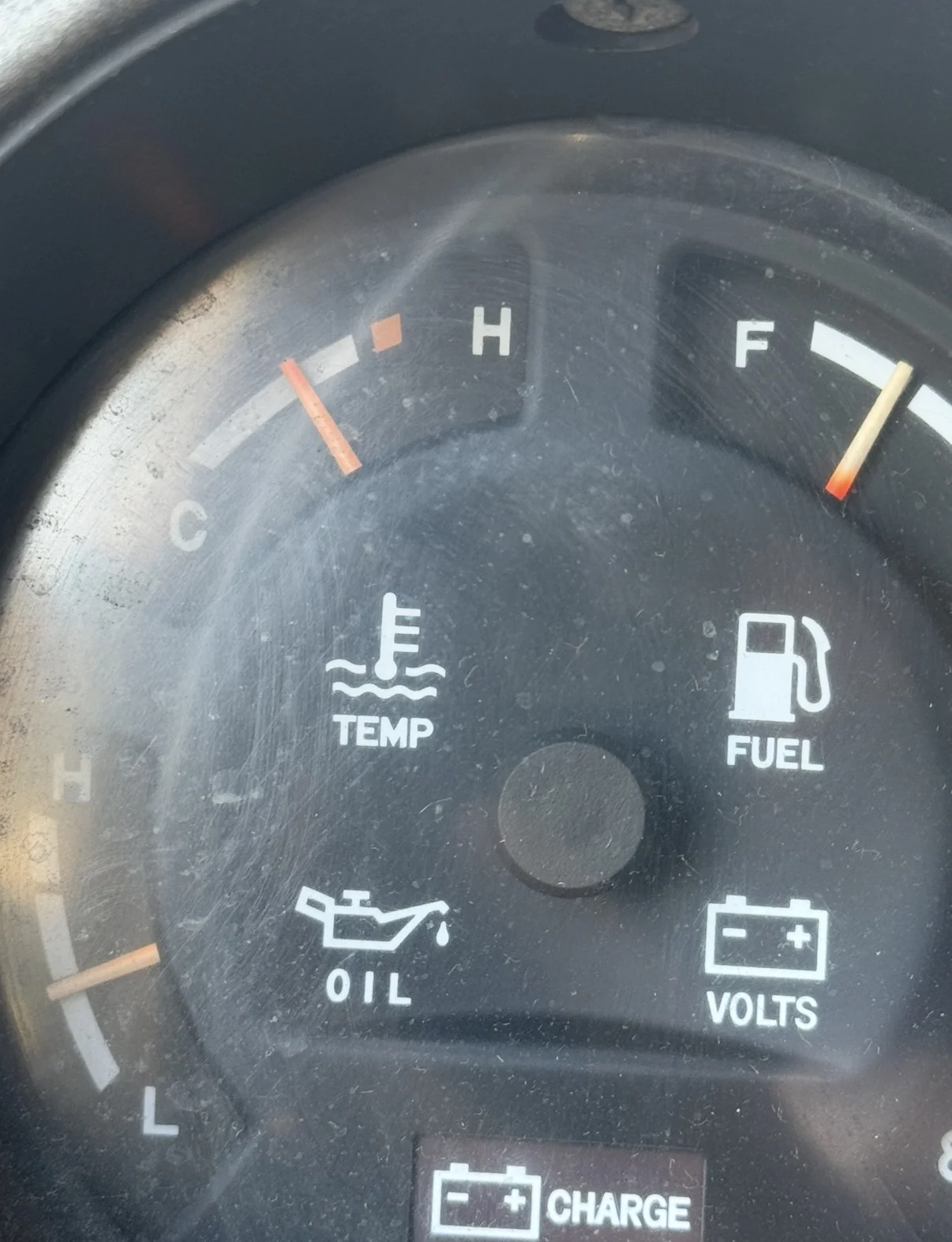

I assume the temp gauge is incorrect? It's slightly concerning me that it's in the upper range of the gauge but I read on here that they are known to be incorrect, the truck had been running about 45 mins at idle at this point with these temps. I haven't written out that it couldn't be the clutch fan still because I haven't driven it yet. But besides that could this just be a bad temp sensor?
Take it on a drive about 60 mph for 15 mins or so and stop and measure temps with gun again. If the temp need keeps rising at higher speeds I would not do it for too long

Just took it for a drive with the distilled water in there. It's hovering at that temperature now and I check with the IR thermometer and temps stayed relatively at 178-182 mark after driving for 30 mins.

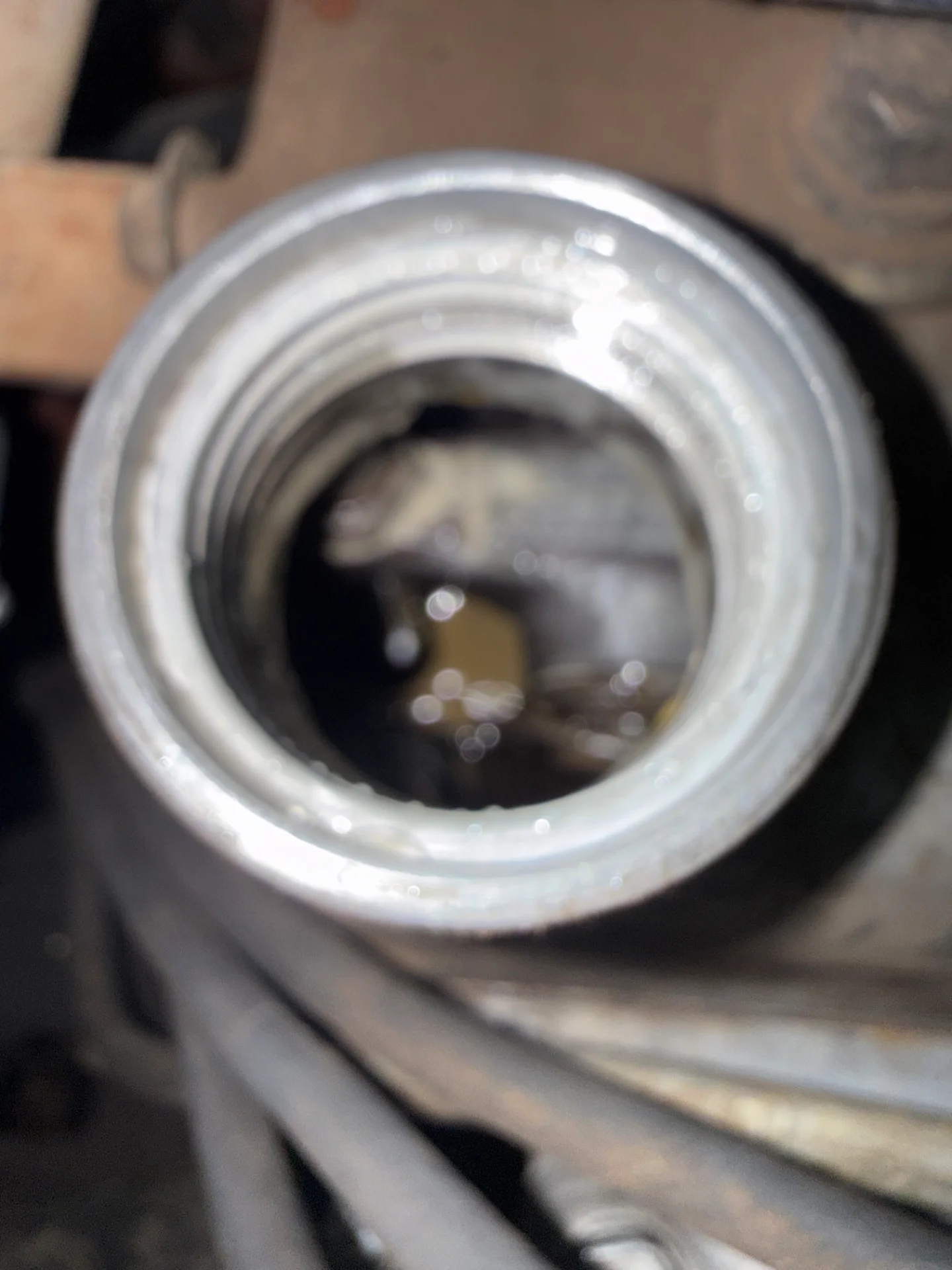

when the antiboil was drained, did you open the rear block drain? the rear can get plugged up, the temp sender is near the rear of the head
No I haven't, do you recommend I should? Still need to cycle it a couple more times. Is it possible to flush the block with a garden hose while having that drain open? Or is there a different recommended procedure to flush the block?
Yes, like @Pighead stated above
you may need to run a wire into the drain on the block to get it to flow out, as it may be plugged
Actually did this... after unscrewing it water wouldn't even drain, had to check if I did the right unscrew. Nothing came out until I stuck a pick inside the hole and it started flowing straight coolant gunk all down my arm and back :hungover:
@3_puppies alluded to it above - the temp sender for the dash gauge is towards the rear of the head. Temps will be different there than at the radiator. In any case I'll echo the above and say the needle on your gauge looks great. Sounds like you've flushed the crap out of everything, so reassemble and fill with the proper mixture of coolant & distilled water to your taste or just use the 50/50 off the shelf stuff. Just don't mix different colors of coolant or it can congeal.
Side note: you have a vacuum leak in this photo:
All the vac lines I'm seeing look original. If so, I'd get appx 30' of new 3.5mm vac line from Toyota (it fits the best) and replace all of it. They sell it in bulk I think in 1200mm lengths. Replace one line at a time and you can't mess it up, although it's worth following along in the manual to make sure a previous owner didn't mess up a line or two. I'd also check the larger diameter PCV line and PCV grommet. The 2F feels much better when you get rid of vacuum leaks, especially ones that affect your spark advance.
