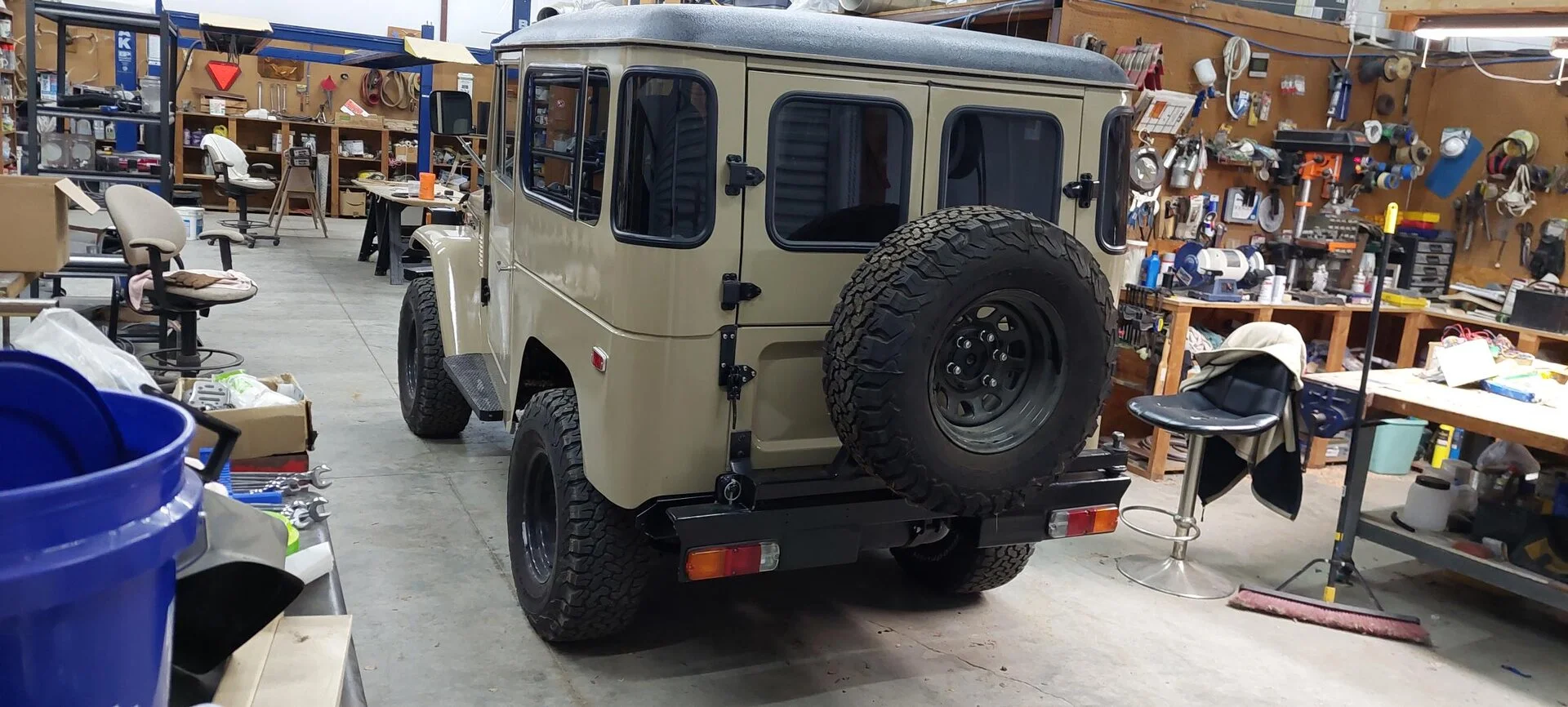

We just rebuilt a 1973 FJ40. Everything looks and runs great.
We just threw the Tire Hanger on it and it is quite heavy. It bolts directly to the bumper. Once we attach it and add the tire, the back end of the FJ sags a good bit.
Looking for remedies as I have never had this problem on my CJ8. I don't know if the leaf springs need to be reshaped, add another leaf spring or add a coil spring to the rear end.
Any ideas would be appreciated.

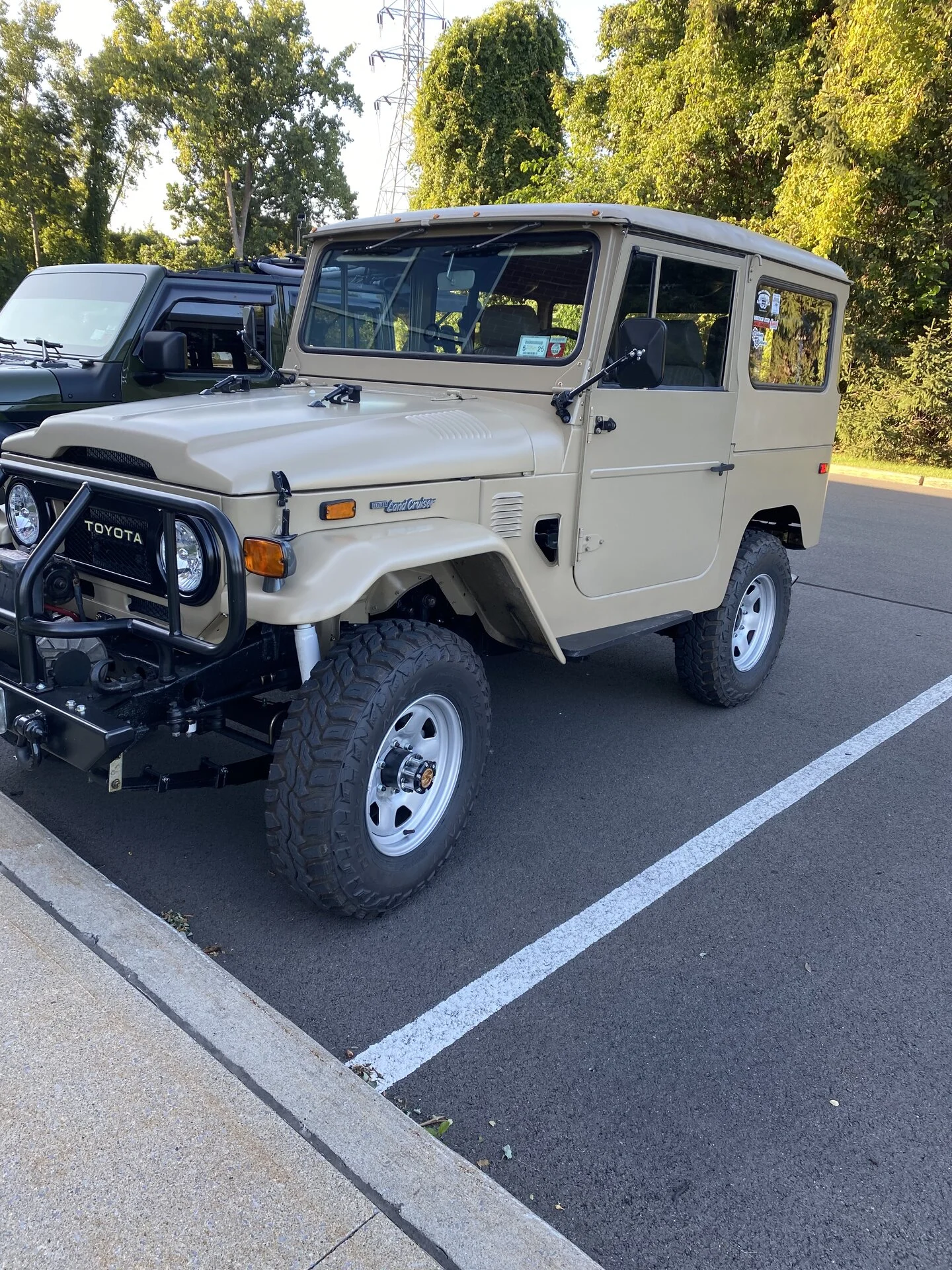

I have a set of Alcan springs with a 4 inch lift for the rear and 3 inch for the front. There is a section of 2 inch square tubing on the front end for the spring hanger from the shackle reversal I did when I was learning to weld in College.
When I ordered the springs we talked about weight, what the payload and winch and the R2.8 is lighter then the F series motors. We decided to go 200lbs or stock for both the front and rear.
I may get the rear axle back under and the put weight on it today depending how far I get.
