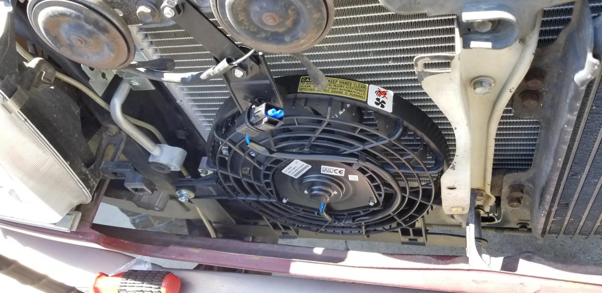

Auxiliary Fan Install
I always thought this was one of the best IC setups back in the day ..
4M40 IC
picture taken from the web ..

I installed a similar setup in my 76 40 Series with the LS1. I had it switched with constant power so I could leave it on to reduce heat soak (like LCP). It also came on automatically at 195 degrees.
I think this would be a good idea for an 80 Series. Especially if you live in a warm climate.
Sorry to threadjack, but does anyone know what size the bolts are that are used to install the bracket? I simply can’t afford one of the kits but I do have a welder and some scrap metal.
The one going to the frame is an M12
The one going to the rad is an M8 (I think)
The rest you can use whatevery you have laying around
Got mine installed. Still need to tidy up the wiring, but when I add my second battery I will take the fenders off and be doing lots of rerouting then.
I sanded about a 32nd of an inch off the bezel of the switch so now it sits sunken in and seated nicely.

Thanks for the advice, I don't have a mod'd fan clutch, so maybe that is a good place to start.
Moded fan clutch and seal all the gaps between the radiator and frame with weatherstripping. I have had my truck for 16 years and a modded clutch for more than 12. It wasn’t until I went through with weatherstripping, that my A/C went from ok went moving and not keeping the truck cool when in traffic on 100f+ days to working well. I now see vent temps in the low 40s on the freeway and high 50s in stopped traffic. Before the vent temps would creep up to the mid 70f range in stopped traffic.
I have the fan kit but only use it now to help with heat soak, i.e., getting gas on hot days I will leave it on so the AC gets colder faster when restarting.

Adding an auxiliary fan will help your cooling system while sitting in traffic or low speed wheeling. It will also help keep your A/C blowing cold in the same conditions. We tested several OEM fans from various manufacturers and choose a stock 100 series fan. We found that other aftermarket fans do not move much air and are typically smashed up against the condenser with a plastic zip ties that can cause damage. The 100 series A/C system (prior to 2004) is one of the best. The fan seems to move as much air as the costly JDM (~$300) and is quieter. As for size, some of the larger after market fans seem to block air flow more than help. The main reason our fan is mounted low to provide as much natural air as possible and increase the flow where it is block currently. When mounted, the fan or bracket does not touch the condenser. We have tested and run this exact set up for a few years and found it very solid without any issues.
If your Land Cruiser is overheating
, THIS FAN OR ANY FAN WILL NOT HELP.
Flow was measured using an Anemometer ft/min
Test Vehicles #1 #2
~200k mileage ~200k mileage
Original radiator Replace radiator
LCP Depo Fan OEM JDM Fan
Flow measured against radiator
opposite fan looking for max flow 413 442
Flow measured on the outside of
the fan grill 932 1144
Size 11" 11"
Blades 11 curved 4 straight
Measurement from radiator to
back of fan 2.5" 3.25"
Sound - JDM is 3-4 times louder
The JDM looks to have a slight flow advantage over the LCP Depo set up. At over 3x the cost the final decision is yours.
