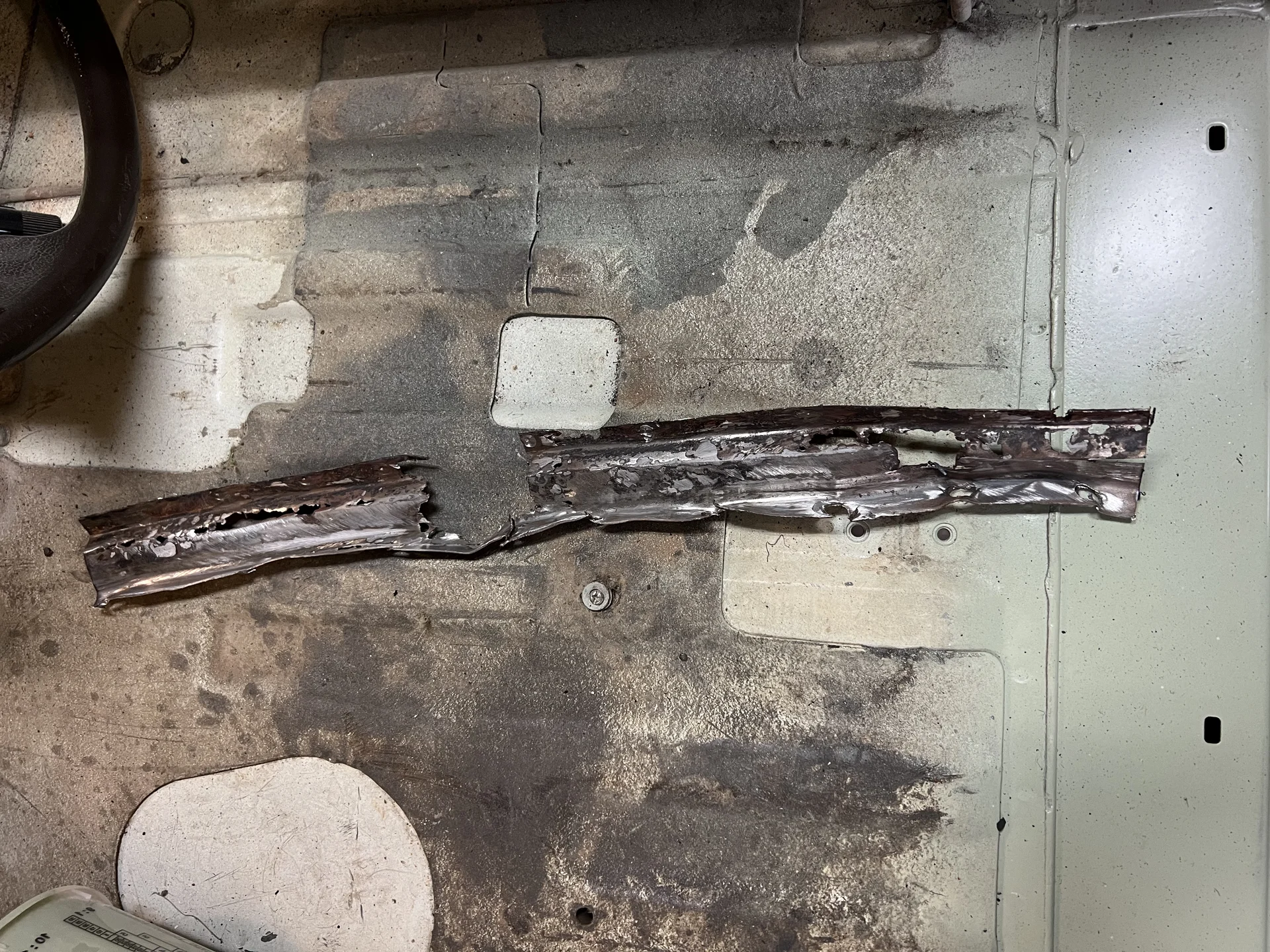

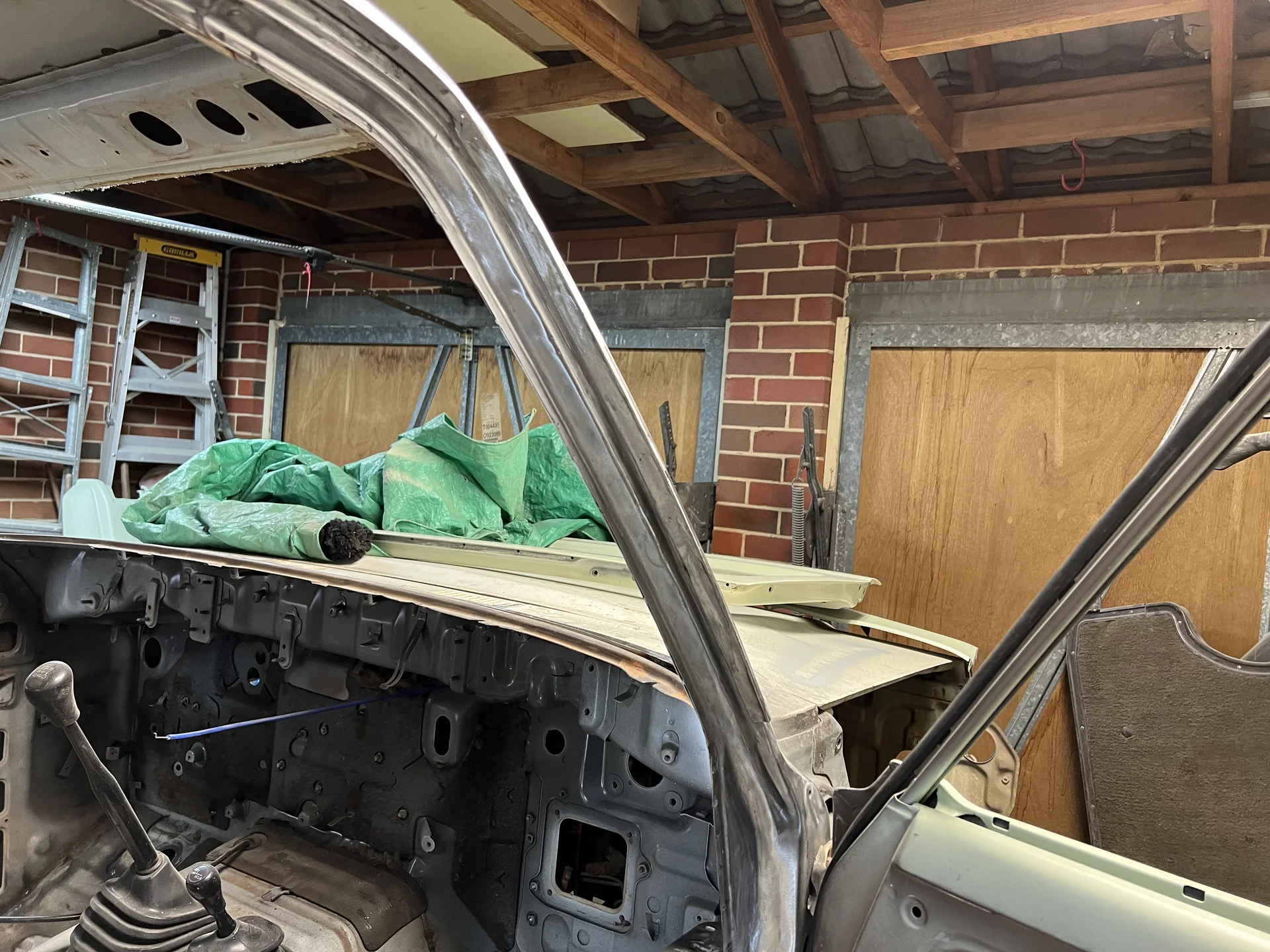

More rust removal. This time the drivers A pillar which was in pretty bad shape.

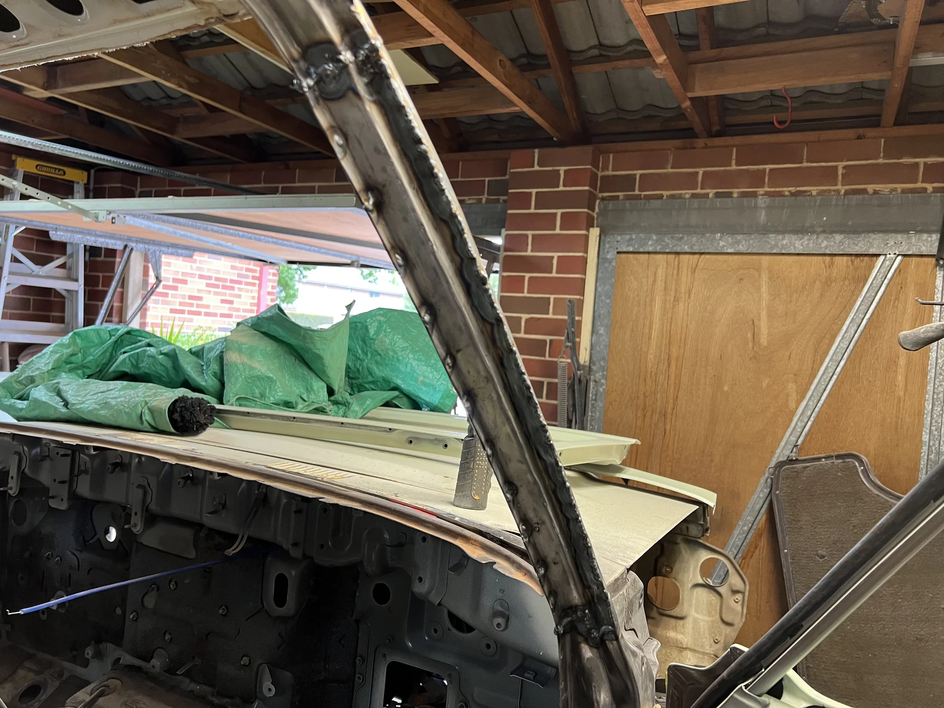

Well after assessing the rust in the roof and cutting a few section it was evident there was rust in the inner rails that would require significant work. Was able to source a new turret locally which will make the job easier and give a nice clean rust free finish. The roof should outlive me now.

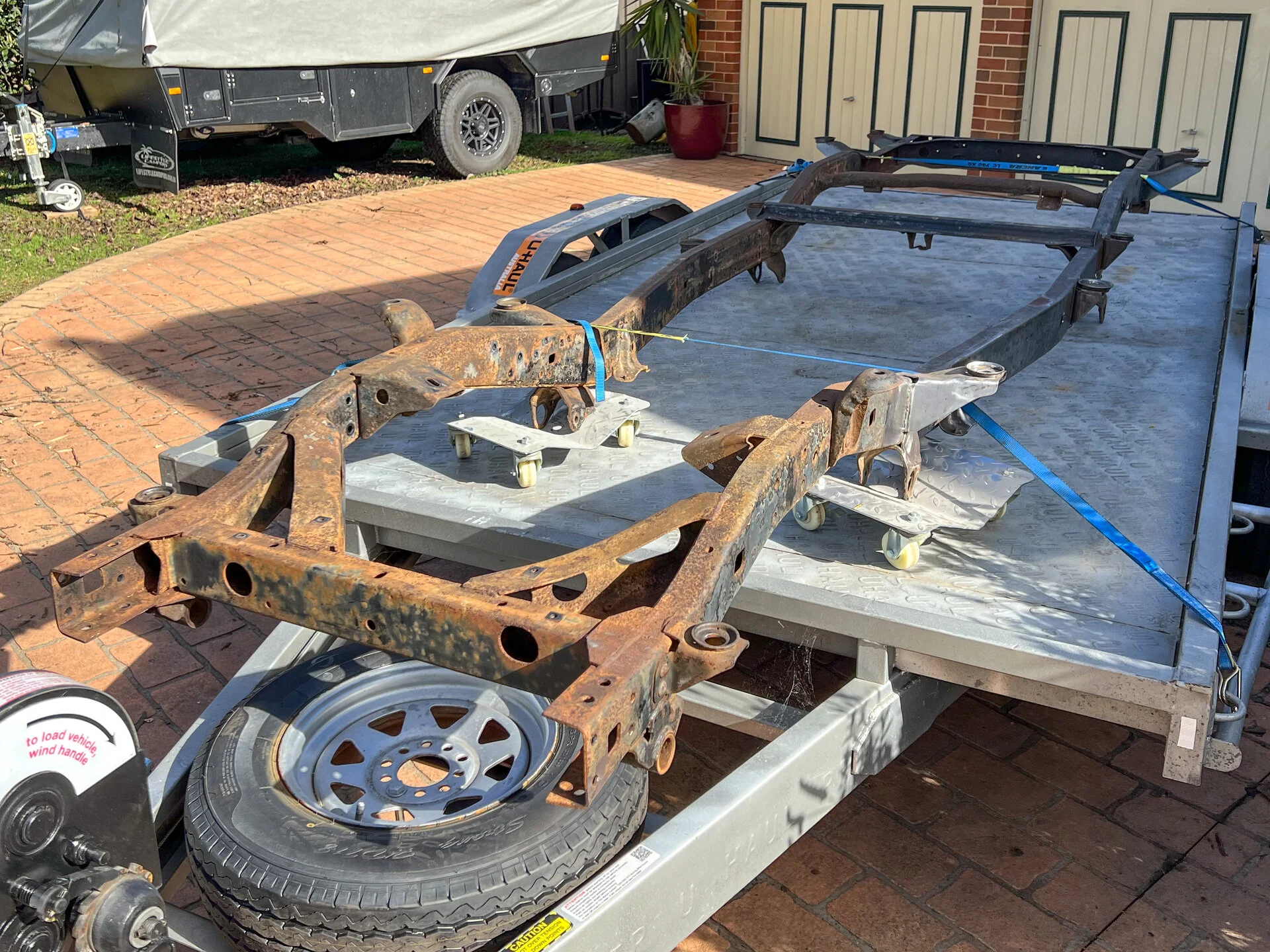

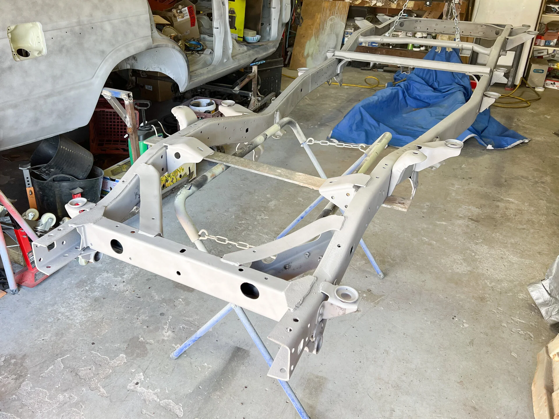

The balancing act separating the body from the chassis. Time to get the chassis cleaned and painted.
wow great job!, how did you source the roof? Is it after market to Toyota?
Genuine roof skins are actually still available from Toyota, although at a hefty price. I actually got this one from a guy who bought it for his 60 but ended up doing a full body swap.

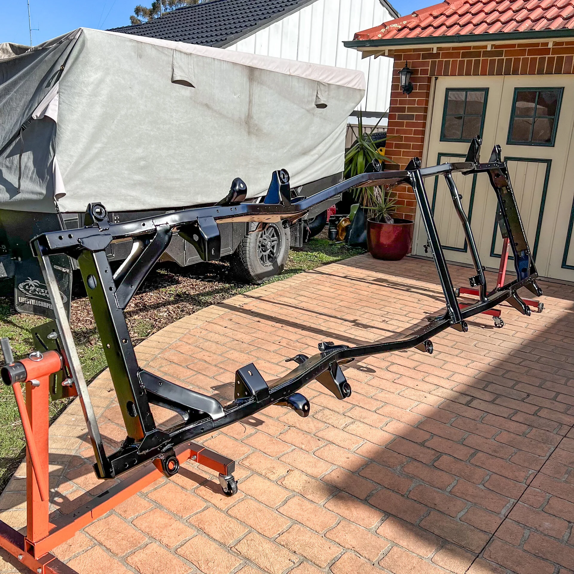

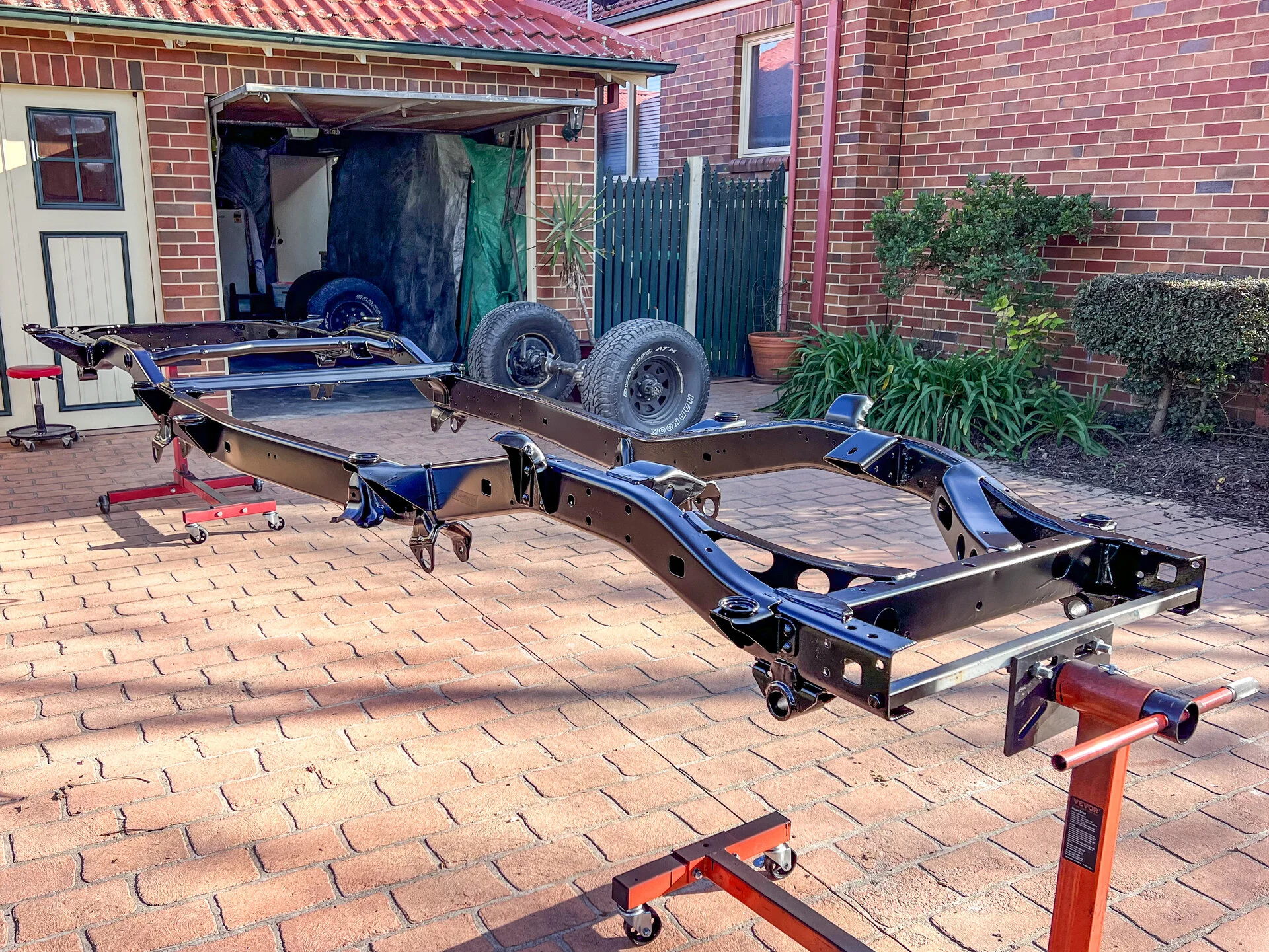

Always a good feeling when the chassis is ready to start reassembly!
