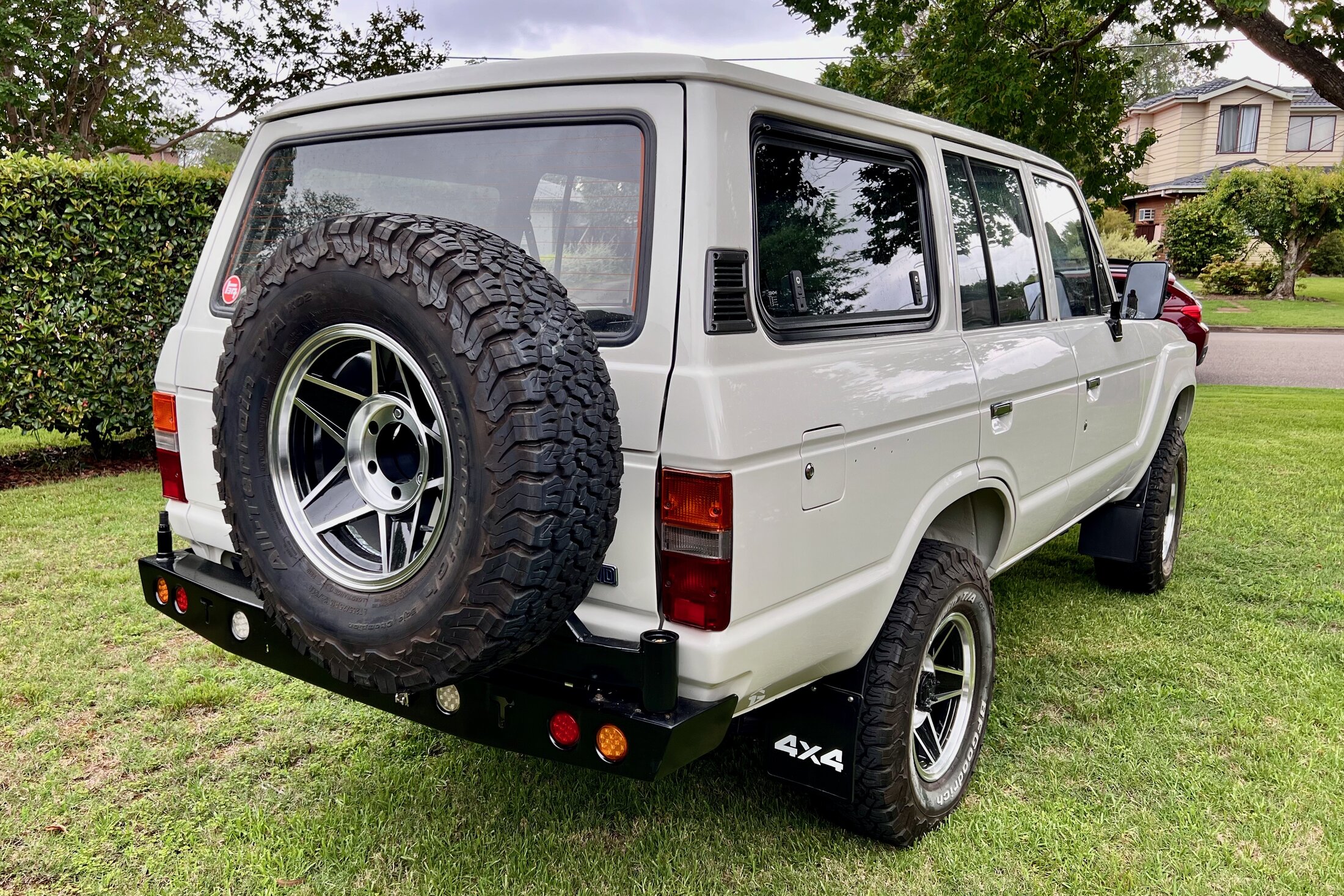

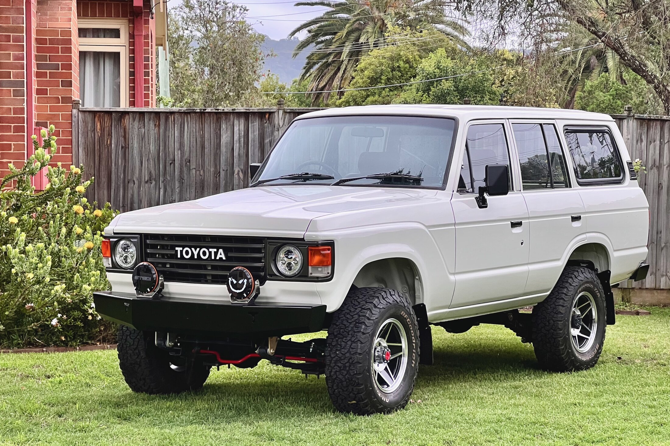

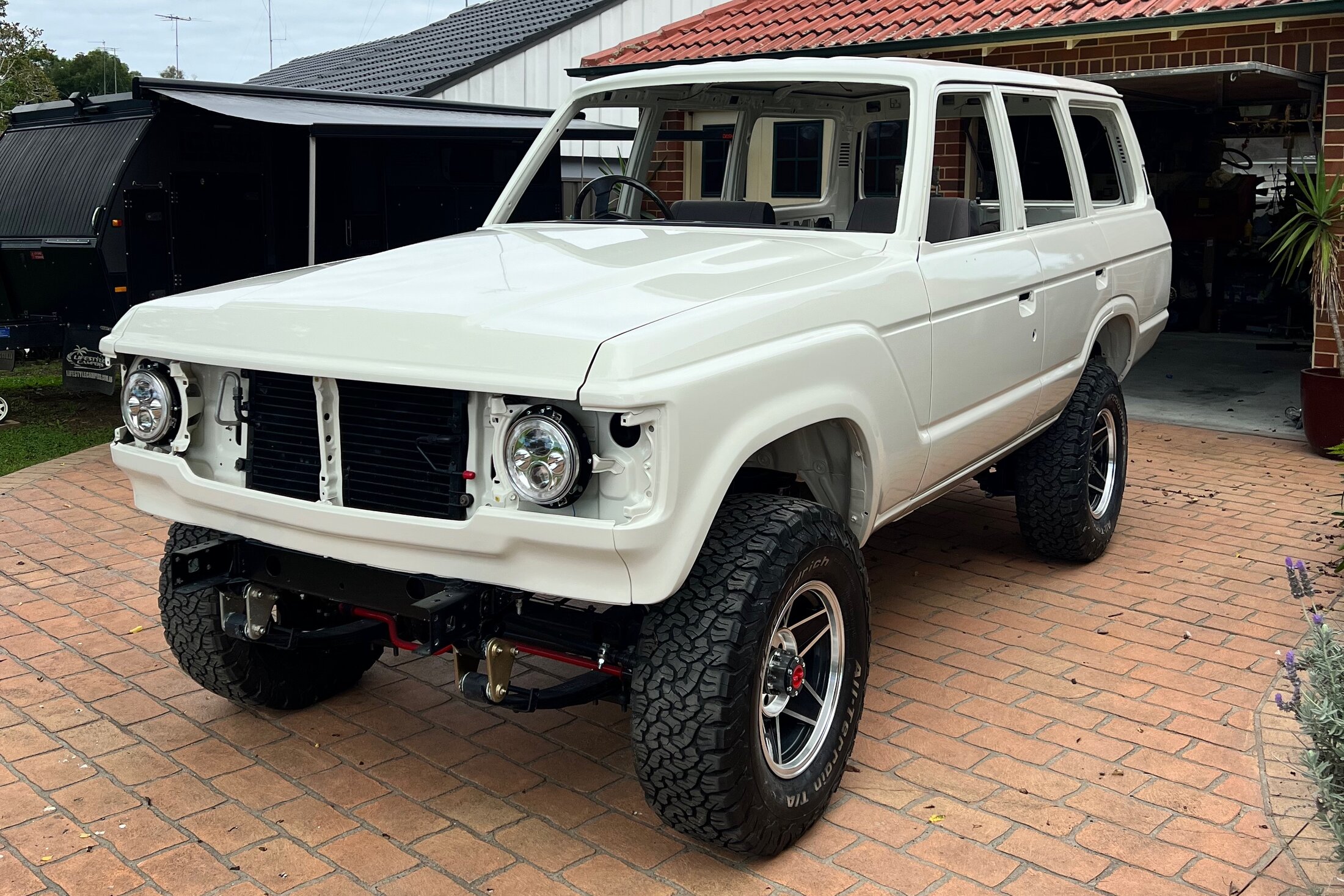

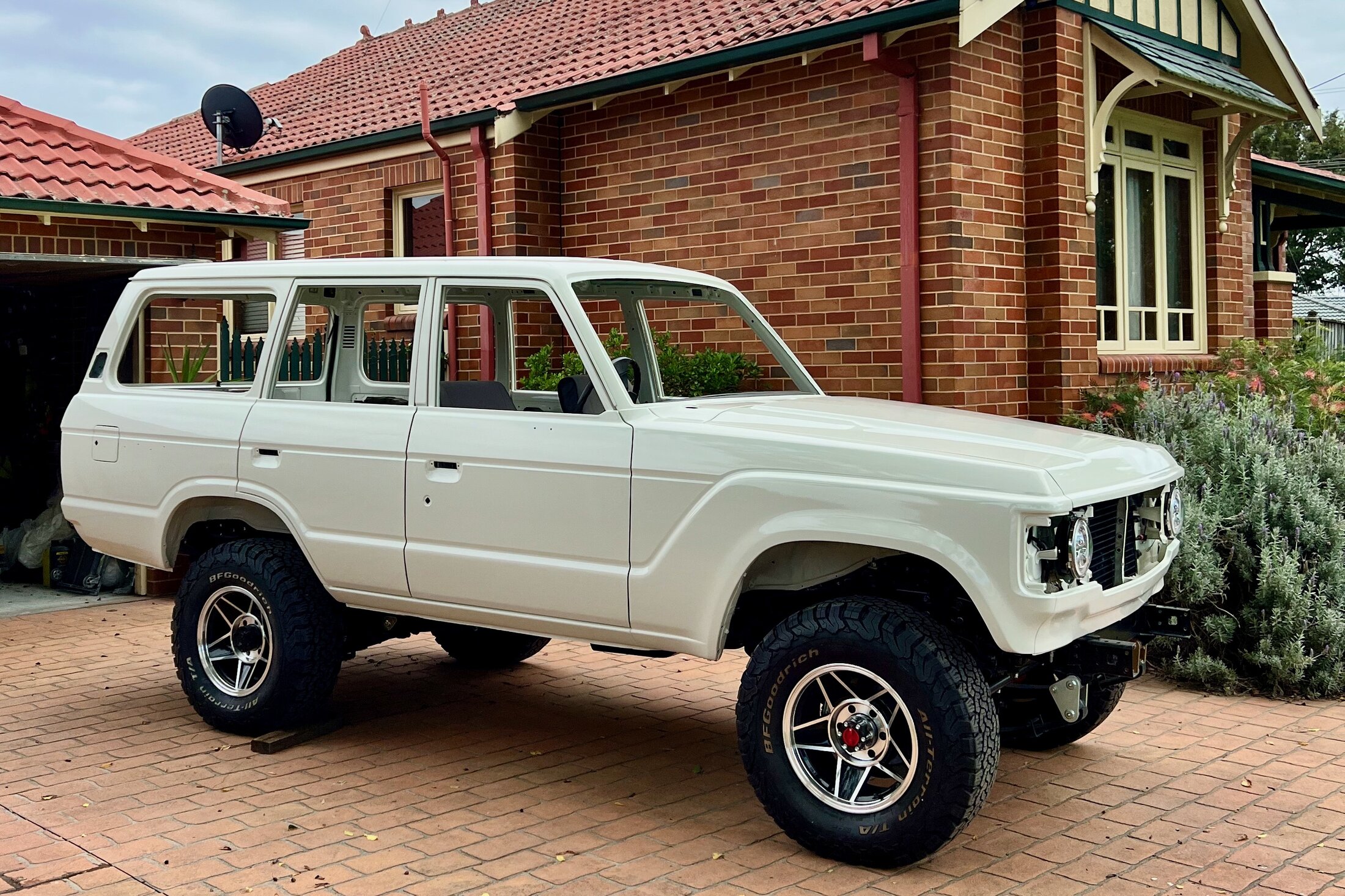

Time for an update. Been putting in the hours in the shed and the 60 is almost ready to go back on the road.
Painted the body fully back earlier in the year.
Interior all fitted, new hoodlining, carpet, seats, seat belts and everything else cleaned and painted.

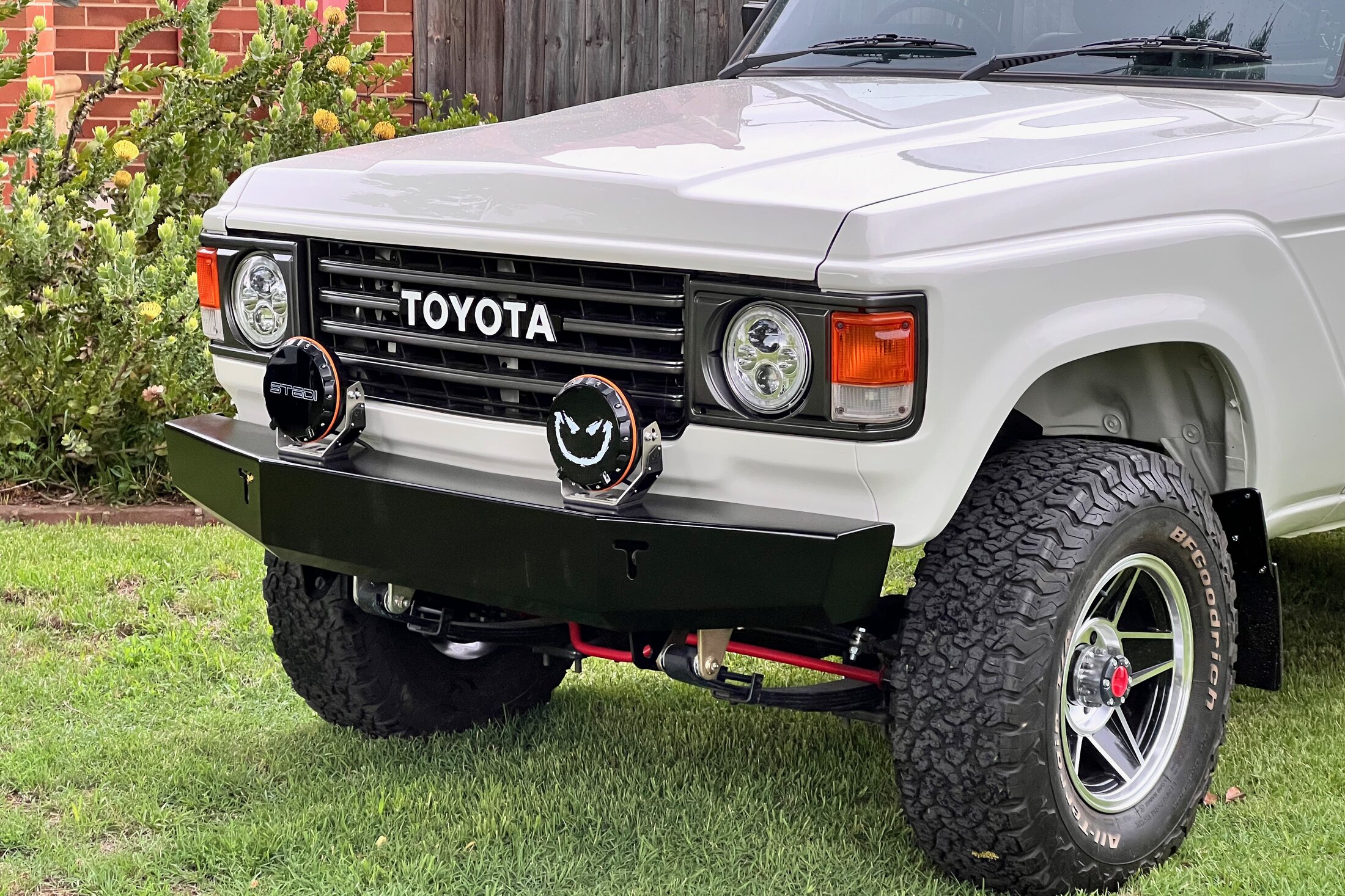

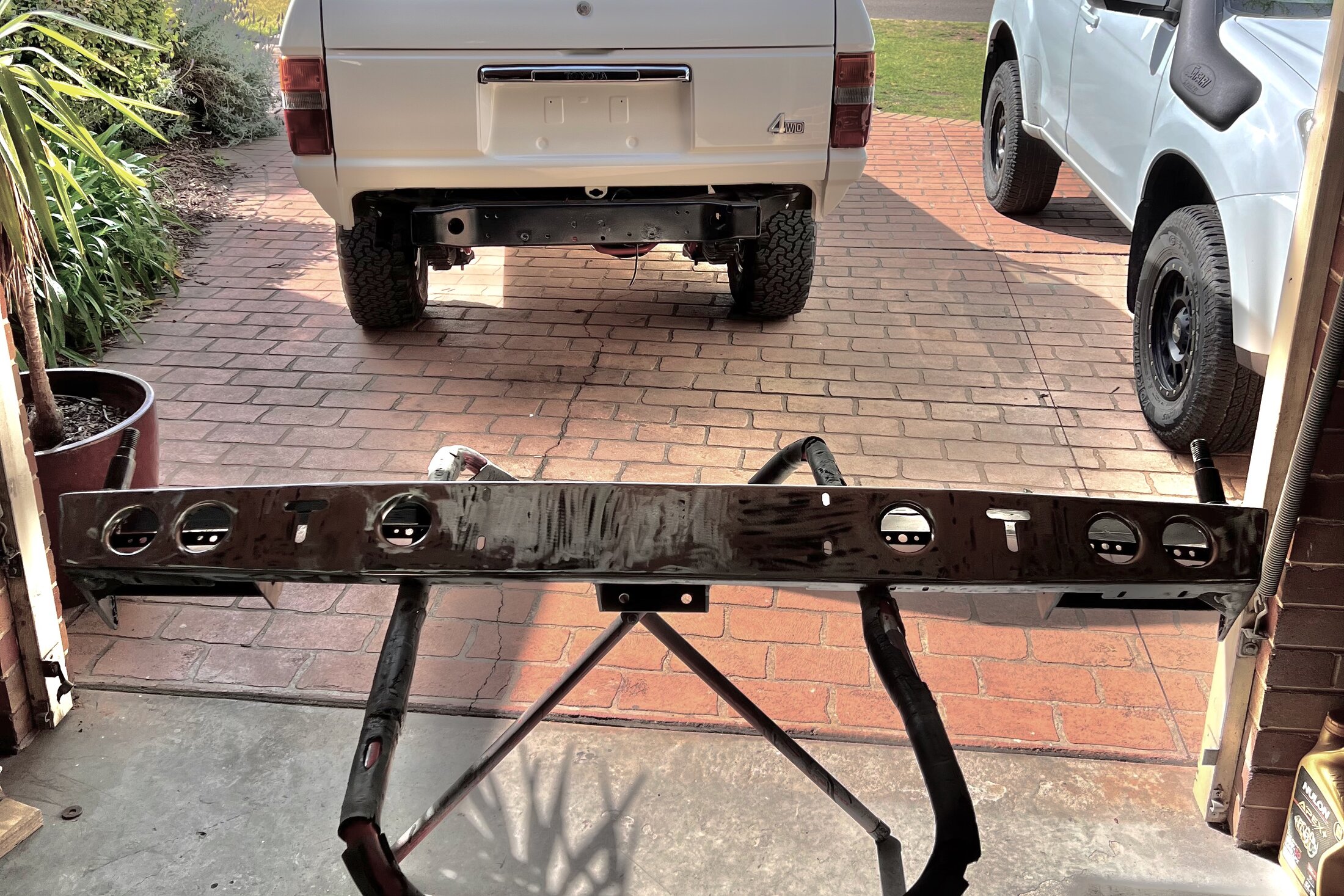

With most of the 60 back together and running I got to work on the front and rear bars. The rear bar was originally an 80 series unit with spare wheel swing mount which I have modified and now fits the 60.

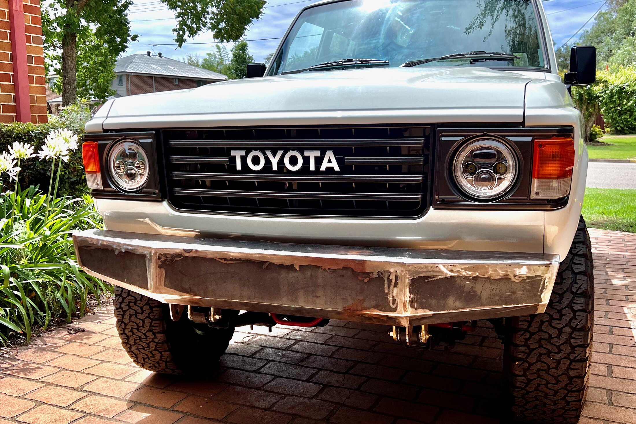

The front bar I built from scratch including a winch mount which I've not yet fitted as I still need to rebuilt the winch. Will need to cut out the front for the winch hawse once the winch is ready be fitted. Still a few minor things to do but hope to have it on the road early in the new year.

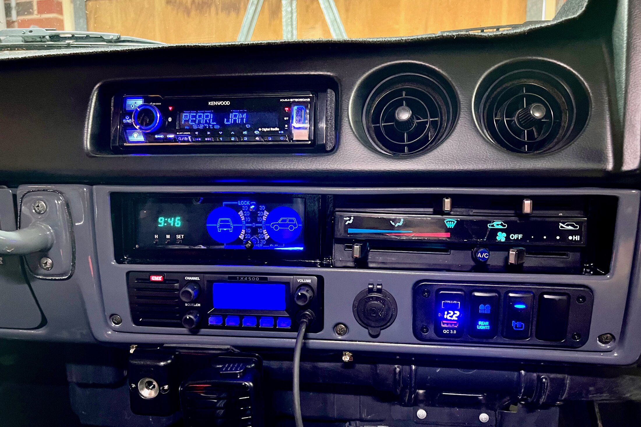

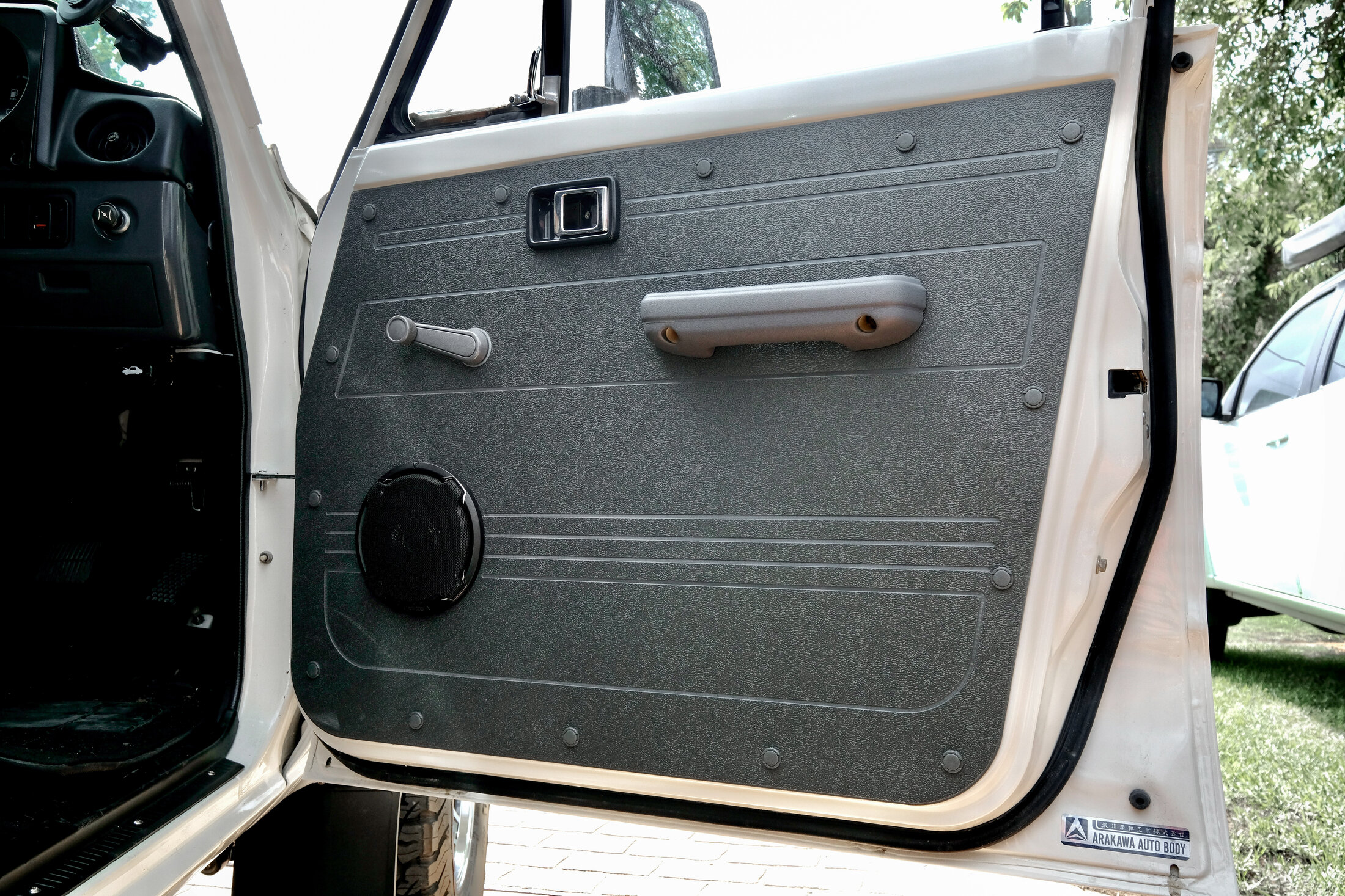

Interior is mostly done.
Rear seats only have a canvas cover for now. Not sure yet whether to get the rear re-trimmed or remove altogether and make a full flat floor.
ABS door trims from Australian Door Cards.
