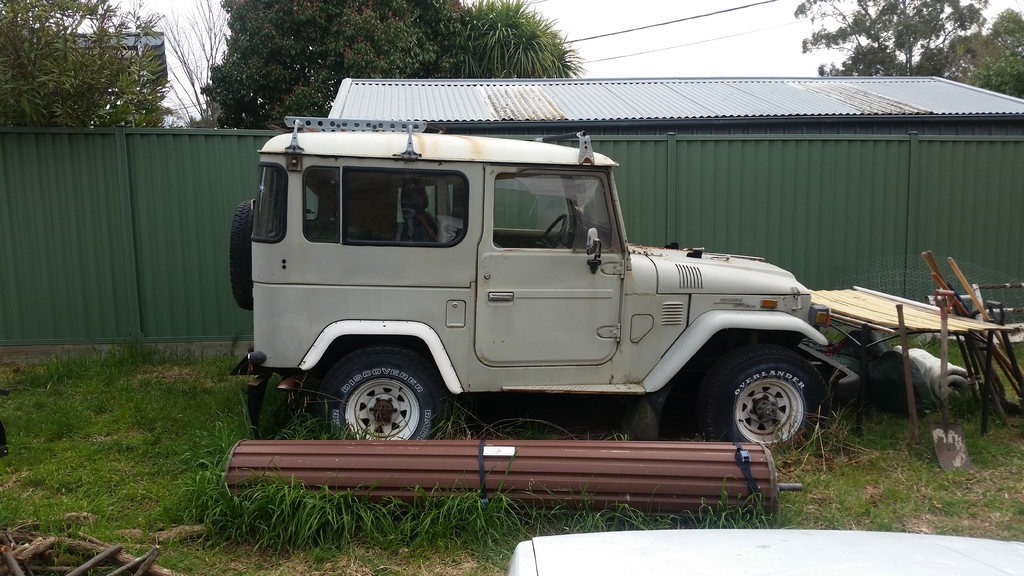

I have known the previous owner of this FJ40 for about ten years now. The first time I ventured into his backyard I noticed the ‘Shorty sitting by itself and was quick to go up and get a closer inspection. I recognised instantly that it was an old Land Cruiser and was quick to start interrogating him into its past and how it ended up sitting in his backyard.
He explained that he had owned it for close to ever but the motor wasn’t running (probably the big end bearing) and that one day he would get ‘round to fixing it. Over the next ten years of our friendship, I would catch a glimpse of it every now and then, but we spent close to no time in his backyard. Every year or so, I would get a sudden urge to get out and just check up on it. I watched it slowly deteriorate more and more (the Australia weather doesn’t mess around).
The previous owners dog found that the FJ40 made for great shade on hot summer days

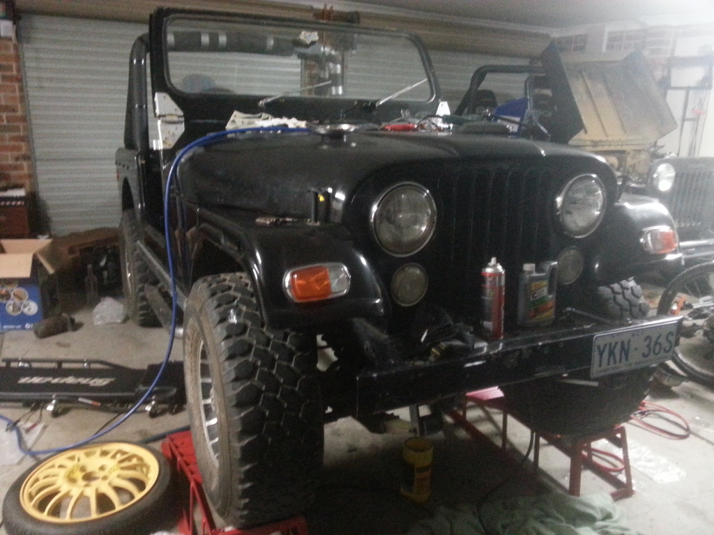

I bought my first project car soon after that, a 1978 Jeep CJ7 with a Ford V8 power plan. This was my first project/build and loved spending all the free time I could drinking beers in his garage as we pulled it down and fixed it all up (to be fair, although it wasn’t running, it wasn’t in bad condition)

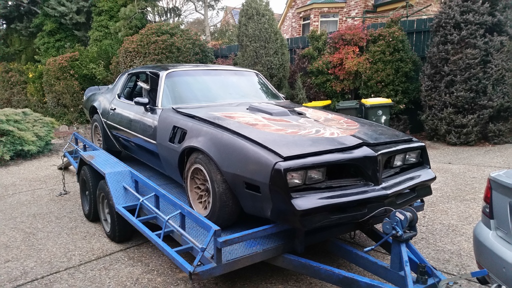

I was offered a trade for the CJ7 that was too good to refuse (‘78 Firebird Trans Am… also bloody rare here in Australia) and it wasn’t long before I was missing having an old 4wd around.

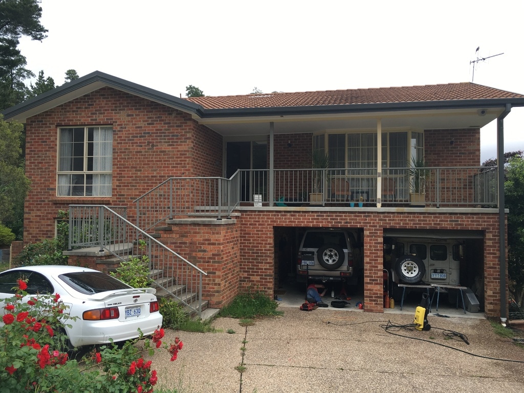

I would be lying if I said I had done a thorough inspection of the vehicle prior to getting it home (for $500 I wasn’t expecting much).

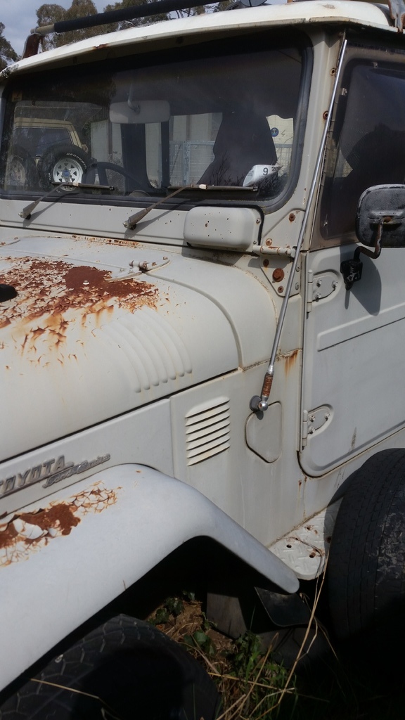

Little bit of surface rust

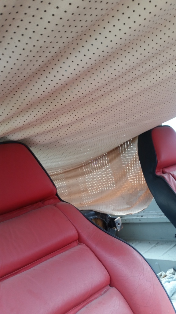

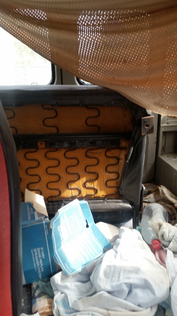

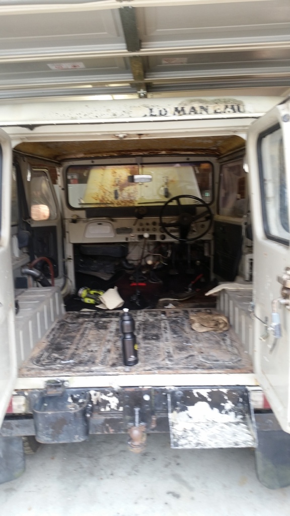

The interior had certainly seen better days.. very saggy roof liner (old Porsche seats)

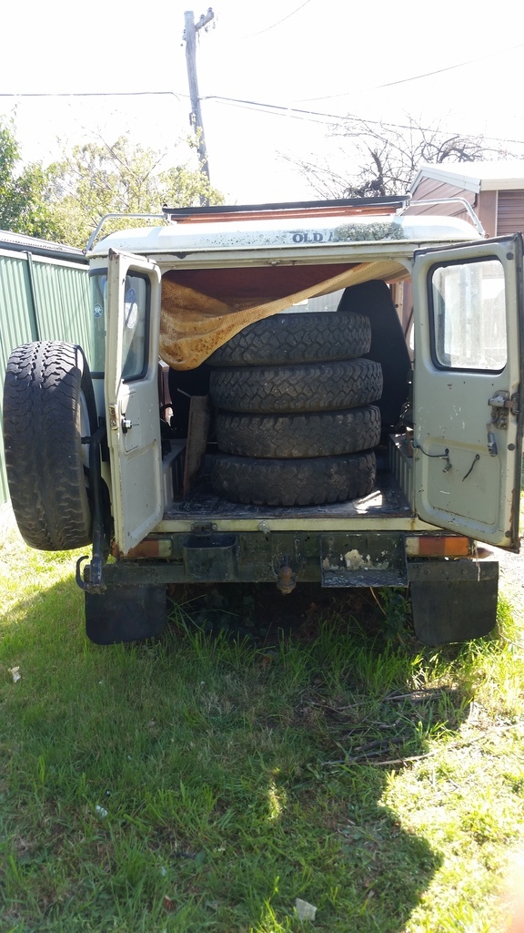

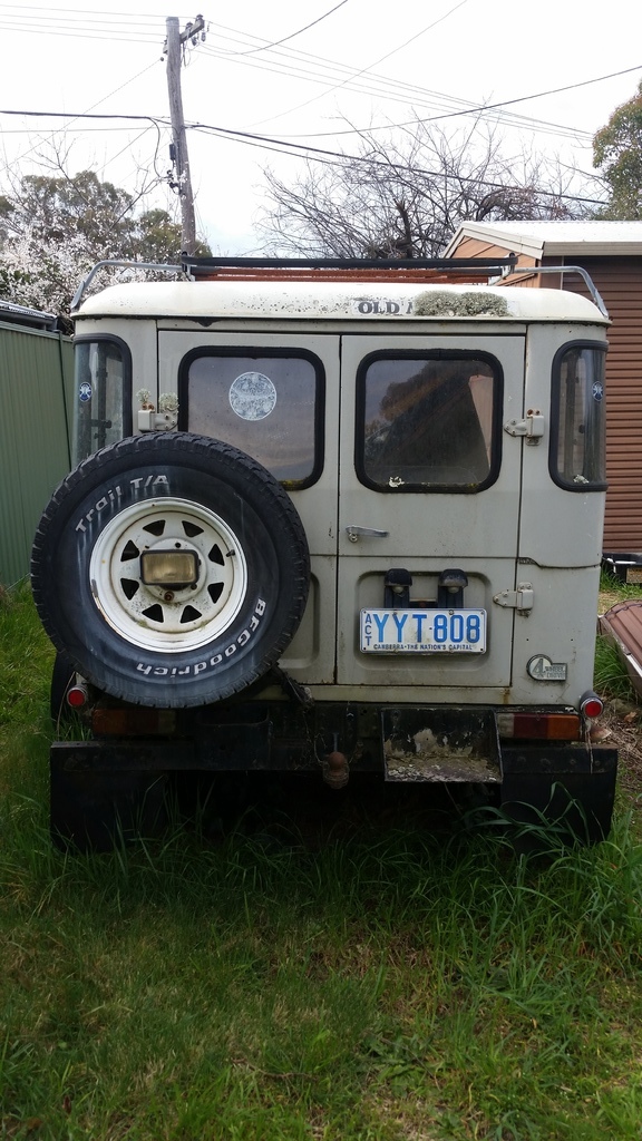

Picture from the rear
First step was to pull out the garbage from the interior and give her an extended pressure hose (it had been sitting in the same spot for over 12 years).

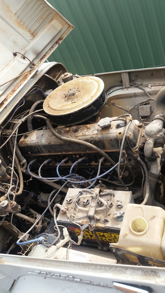

We then decided to see if she could be started as is - no oil change, original plugs (I was not convinced this would work at all). With a small piece of fuel line dropped from the mechanical fuel pump into a bucket of new fuel, a donated car battery and a substantive spray of (we call it ‘start ya bastard’) aerosol engine starter… and she ticked over. Good news was that she ran but the knocking sound was apparent from straight away.

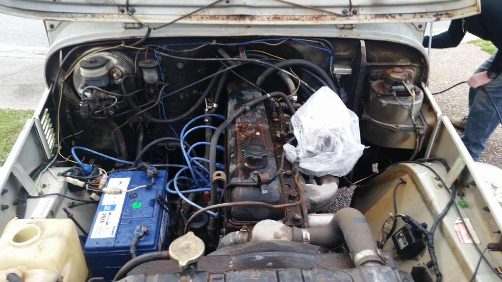

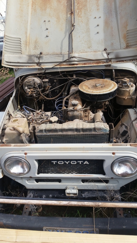

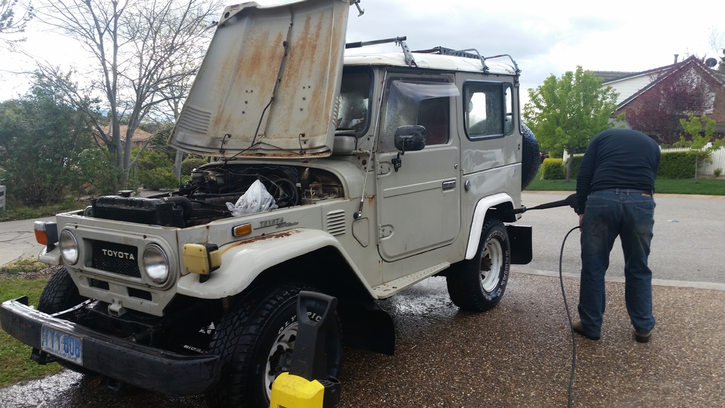

The 2f had been sitting for a while, so we next gave that a good pressure clean. You would be amazed at what came out of that engine bay…
Before
After the pressure clean (and different battery)

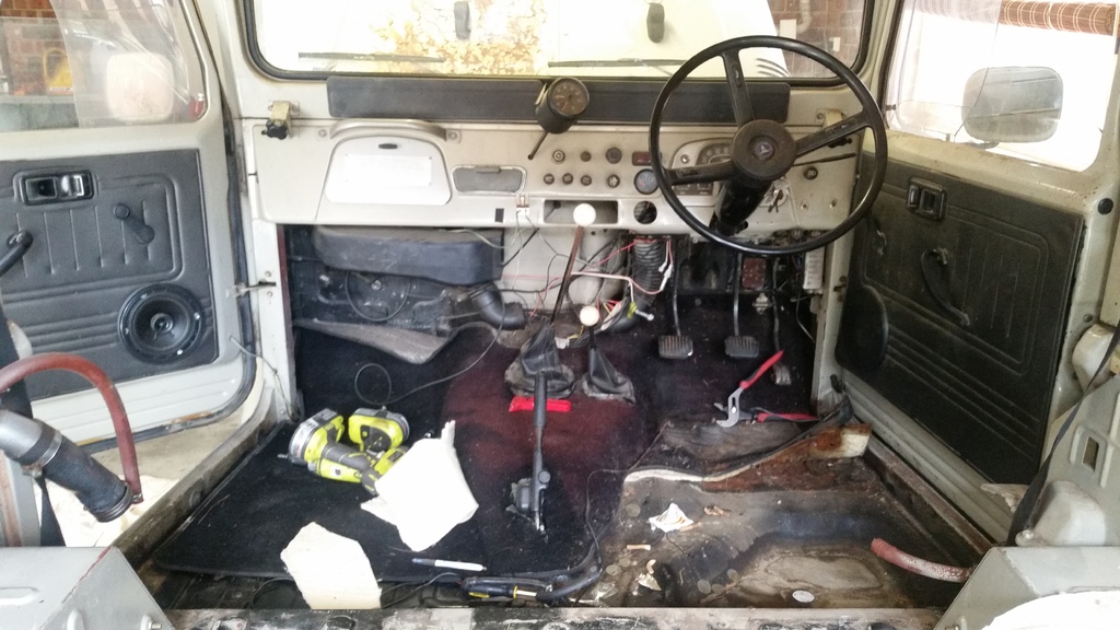

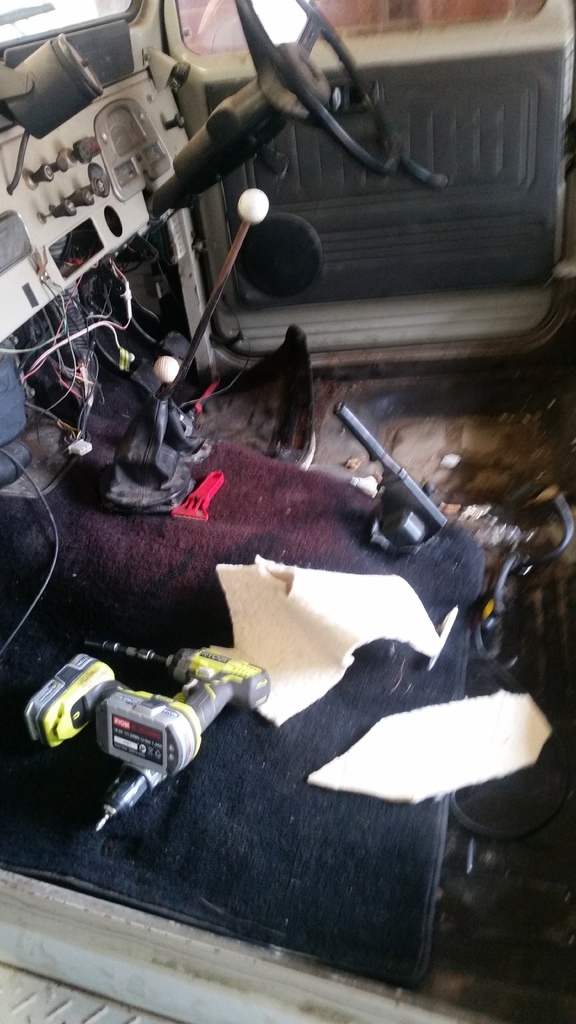

I was keen to rip as much of the interior out as possible, including pulling out the seats and petrol tanks. The original tank and a secondary tank (fitted under the passenger side). There was still a decent amount of petrol in the tank, which had separated years ago and smelt like something I had never experienced before.
This was a very satisfying job. A quick win!
I was happy with the quality of the floor after pulling out the carpet… until I found a leak it the roof seal had slowly dribbled down into the driver’s side foot well…. It had properly rusted through (about 20 – 30cm). This would be welded at a later date as I was still on a stripping rampage.

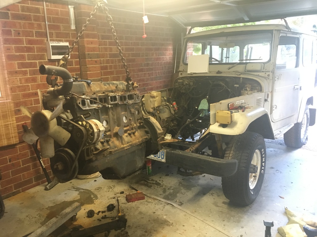

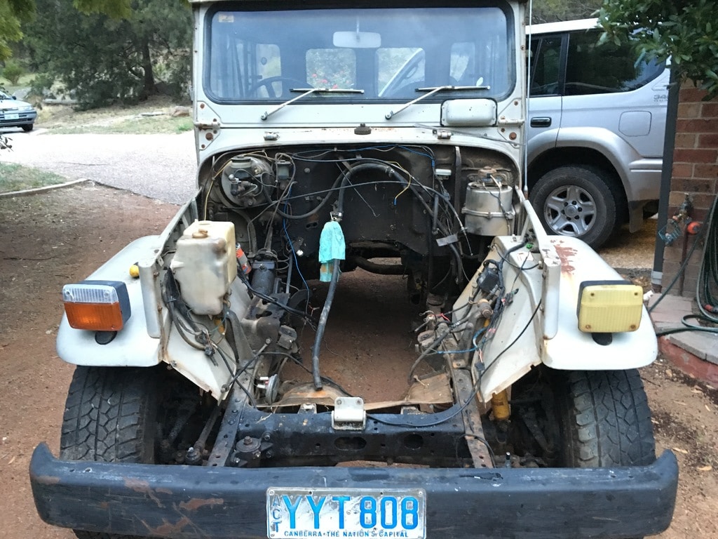

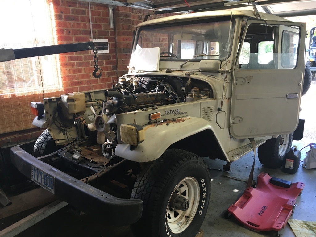

In preparation for removing the engine, the FJ40 gave me a pleasant surprise with how much access you are afforded (fold down front panel). I noticed a lot of people take the front quarter panels off, but I didn’t see any need to at this stage.
I have never rebuilt an engine from the bottom up… and was petrified of making a small mistake resulting in starting over. We decided to give the 2F to a shop to get done right the first time, while we focused on body and paint.

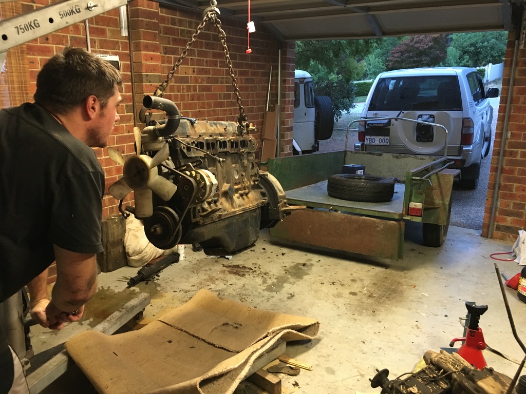

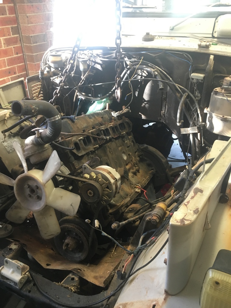

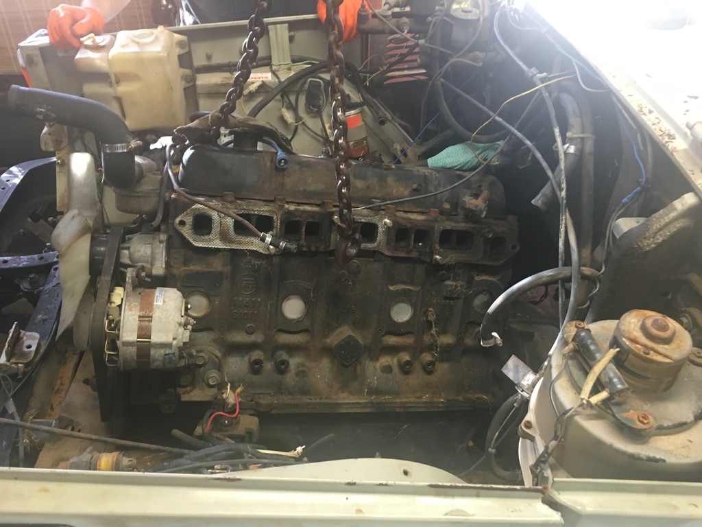

The 2F, exhaust and gearbox was pulled out in a couple of hours one evening after work (thanks to the quick work of my mate Heath and my old man). This was driven out to the shop, leaving us ready to focus on paint and body.
We did have a small screw up with the 2F coming off the engine stand after a knock... yes it was a dumb mistake... and falling back into the engine bay. Boy oh boy did it make a sound on landing!!
Whoops!

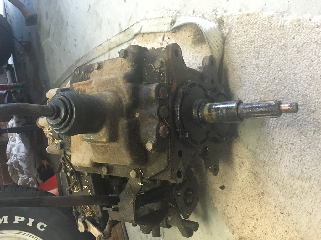

Gearbox out and ready for a servicing!!
2F out and ready to go off for a rebuild
Heath lining her up for towing
